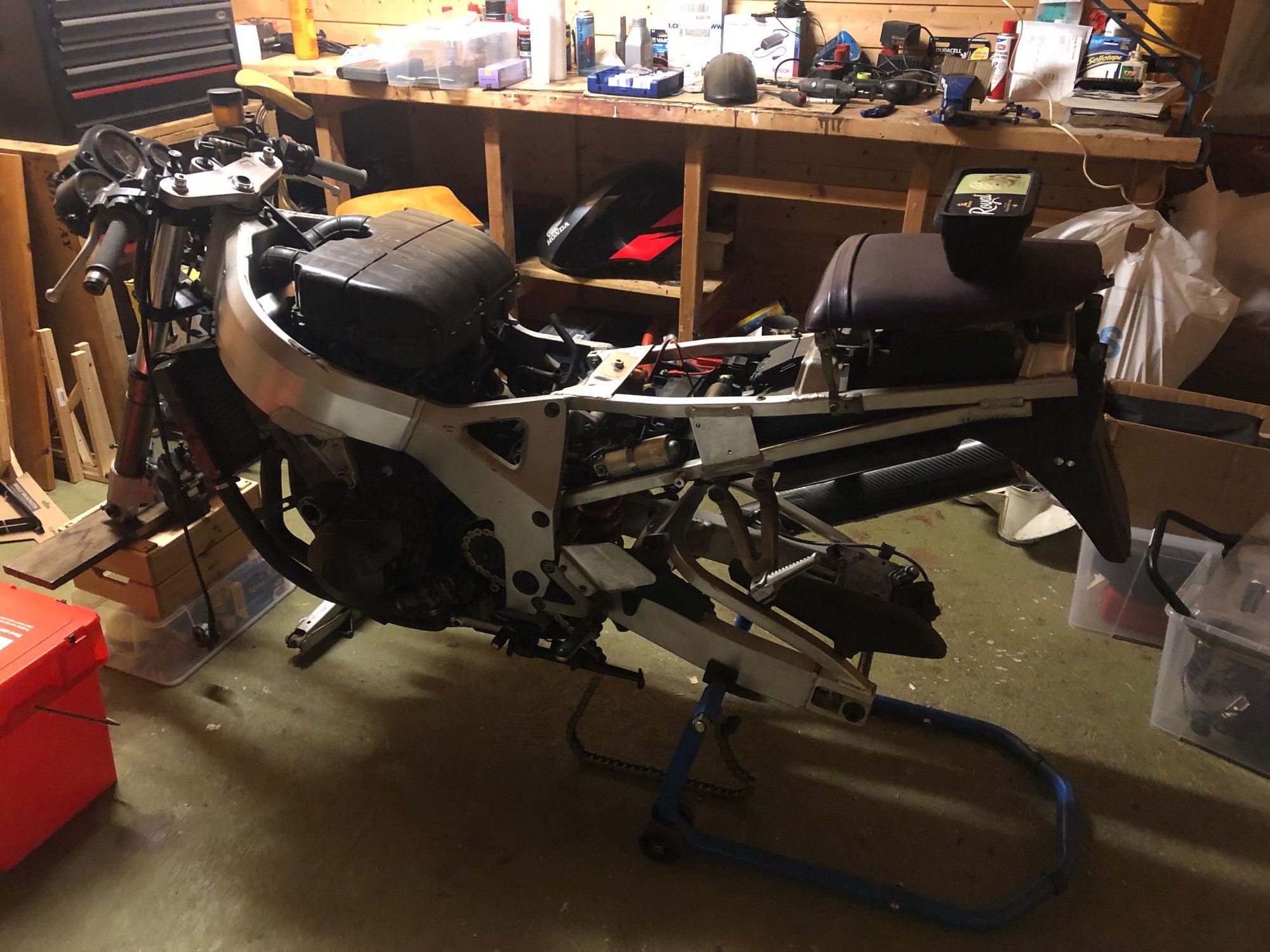

Hi everyone!
I´ve owned this CBR900RRP (bought in UK then moved with it to Norway) since 2007. I crashed it in 2009 and have since been VERY slowly piecing it back together. I´m not far from finishing - but the project has stalled as I´m trying to work out how the wiring and fuse box should be located on the front right hand side. I will try an upload some pics to show the state of things as they are today.
Can someone here with a similar model year who can easily access this area take a couple of pictures to show me how to do this in a tidy way? I want avoid having a birds nest of wiring under my panels!
Would sincerely appreciate it!

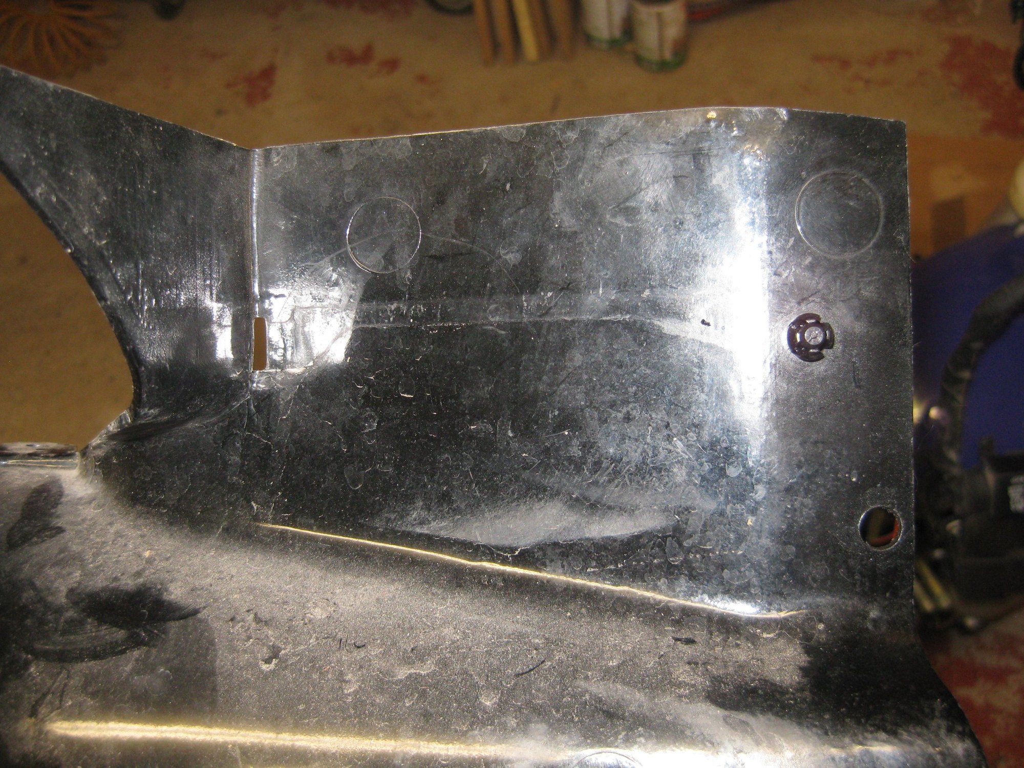

Have you got the Honda workshop manual ?
Are you keeping the fairing?
There is a bracket that fits in with the fairing inner section, and the fuse box is a slide fit onto that .
I am pulling my 1994 RR-P apart starting tomorrow, I'll see what I can do

Default hope that this makes sense / Helps
RH side
RH side open
LH side open
LH
RH
RH fuse box & connector block in metal bracket (part No 64125MW0000)
RH inner fairing
RH inner fairing the nose of the bracket slots into the slot in the upper corner , then a press fit screw holds it in place
metal bracket back
LH bracket (not 93 /93 models, the relays are on the main spider frame behind the lights, on those )
LH inner fairing with slot and push fit clip
