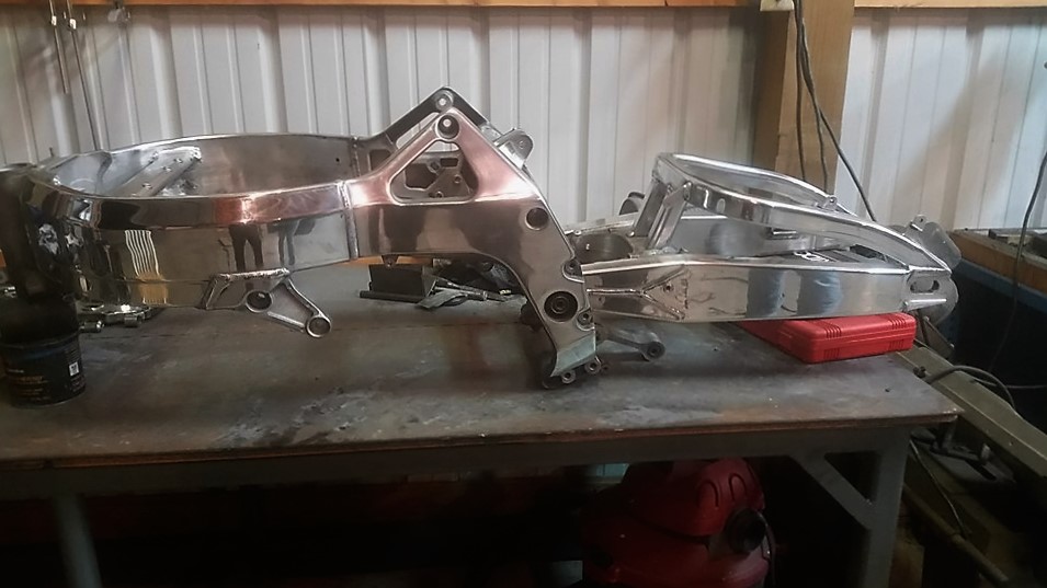

I'll be damned if I can find any numbers stamped anywhere. I'll try again in a few with some better lighting. In the meantime, I have 1/2 of the frame good enough for what I'm after.

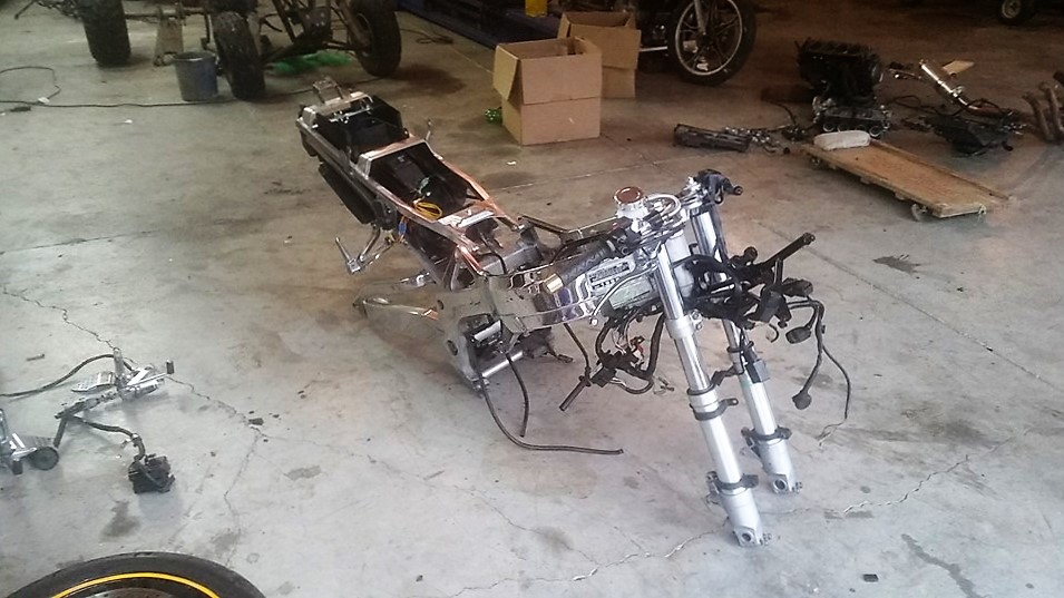

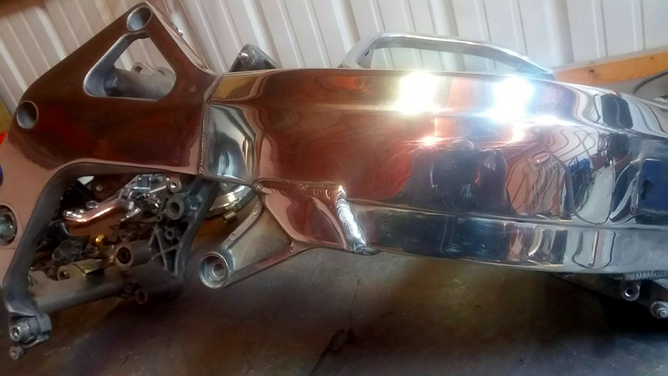

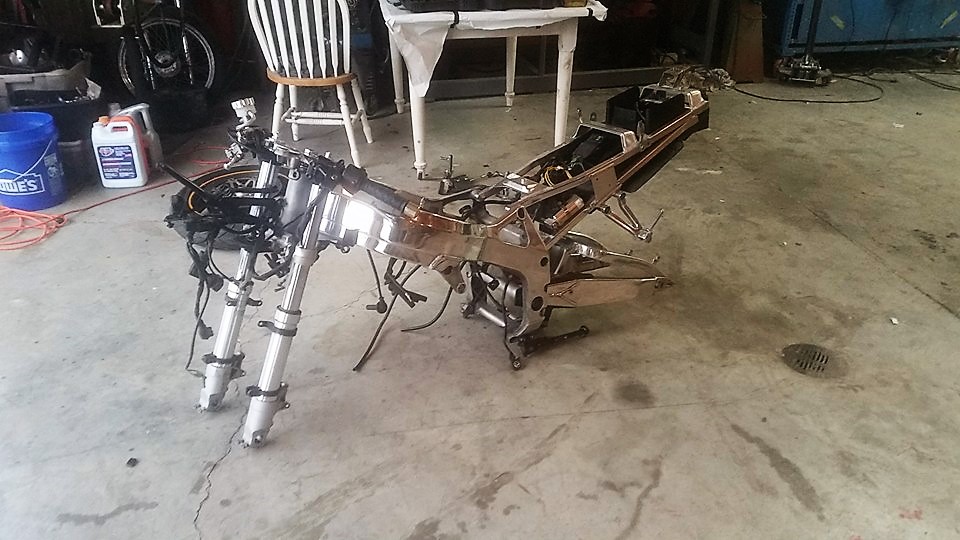

I finished the other side of the frame yesterday, but photobucket was down, so here's the pic.
I also started cleaning, polishing, and putting the frame together today. I'm extremely happy with how it's turning out.

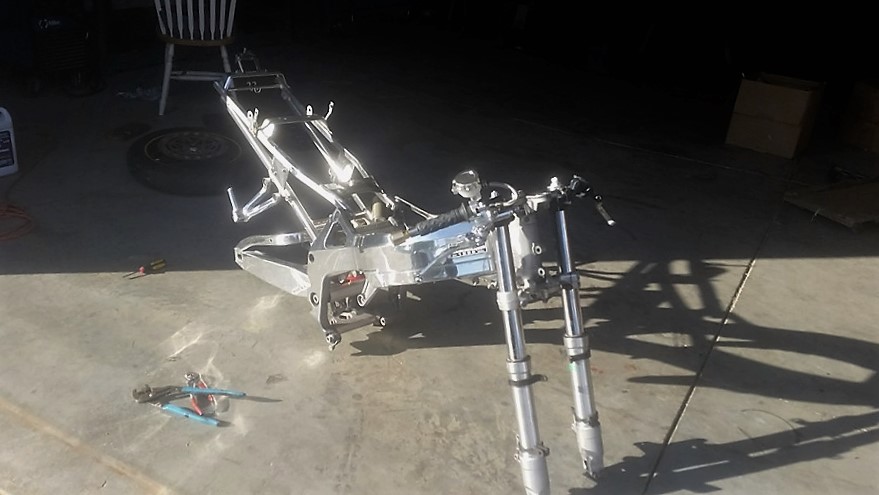

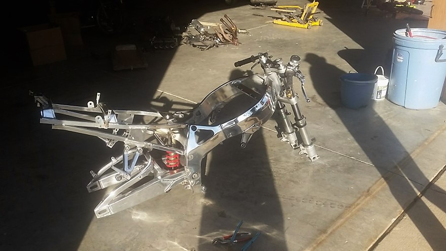

Let the reassembly begin. I inspected the wiring harness and it was in pretty good shape. I had to resolder one area, because it was less than acceptable - to put it politely.
I'm leaving the undertail how it is for the moment, because I'm not sure if I'm going to change the tail down the road. If I change the tail, I'll make my own undertail. Until then, I just want it on the road for this riding season.
As soon as I finish typing this, I'm going to order all of my engine pieces and hope they arrive before this weekend, so I can get it back together.
Then, it's body work and hope for paint-worthy weather.
