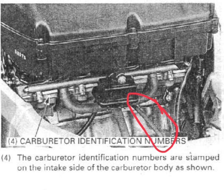

This is the pipe I’m trying to connect... it goes into the engine, but not sire where the other end goes? Fuel ****? Or somewhere else??

The other end goes to item number 6 in the diagram above. That is the vacuum line that actuates the diaphragm allowing fuel to pass through the petcock.

Thanks. I managed to figure it all out in the end. Checked the petcock and found no fuel to be flowing, thought that was the issue, but read about the vacuum line operating it.
That was the reason the bike stopped as the vacuum pipe had come off, causing the carbs to be starved of fuel.
Reconnected and was unable to restart as was opening the throttle thinking it would allow fuel through, but was in fact doing the opposite! “Doh!”
Got bike all back together and started up on full choke and no throttle after about 30 seconds... bingo!
