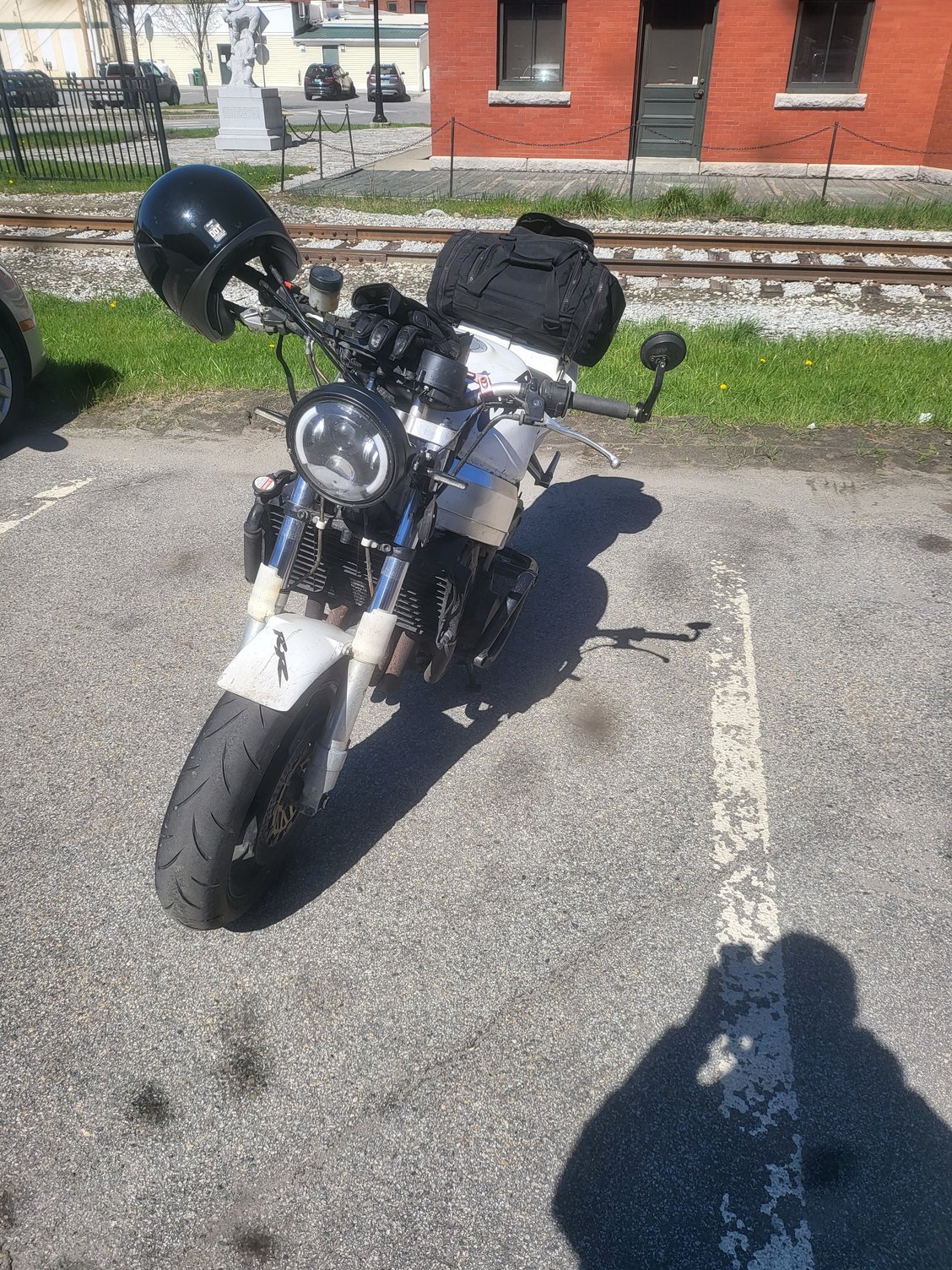

Here are a few pics of the project so far and some of the work progress. I will be updating this when the bike is completed and looking new again. Hopefully i can bring sexy back lol. Oh also I almost forgot, I threw on a new shorty slip on and she sounds amazing! The vance and hines carbon fiber slip on that was on the bike was cracked and the bracket was broken and needed to be replaced.
One of the test flights.

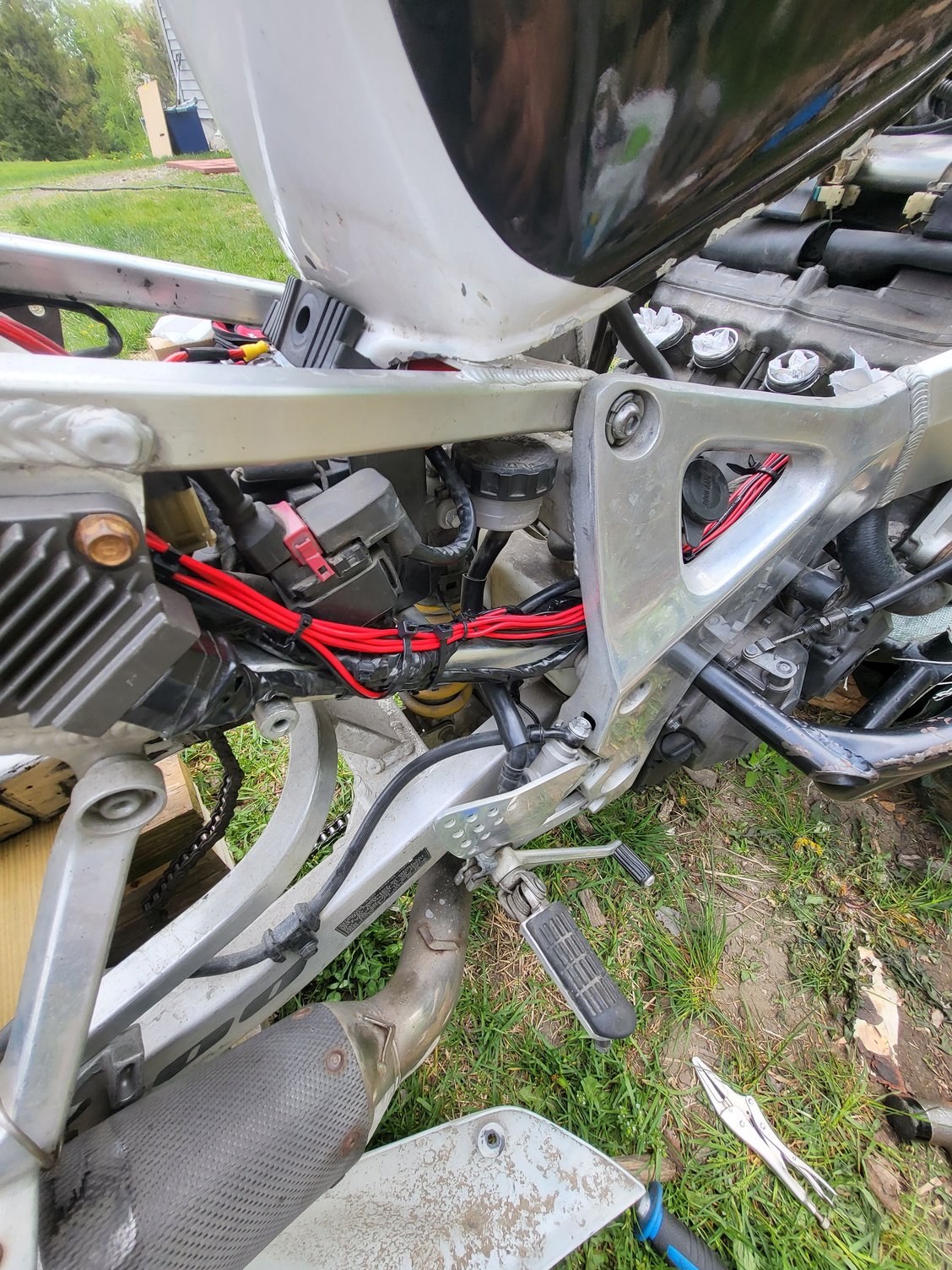

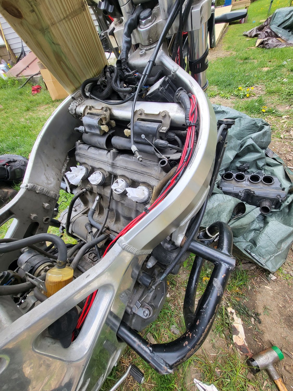

Getting ready to do some harness repairs

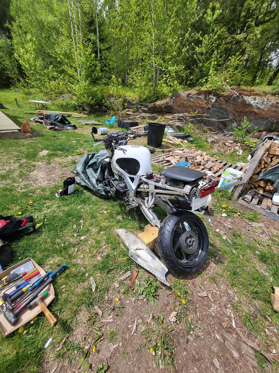

Carbs off, bike stripped down for harness repairs

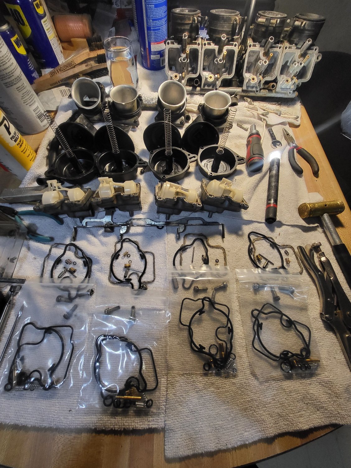

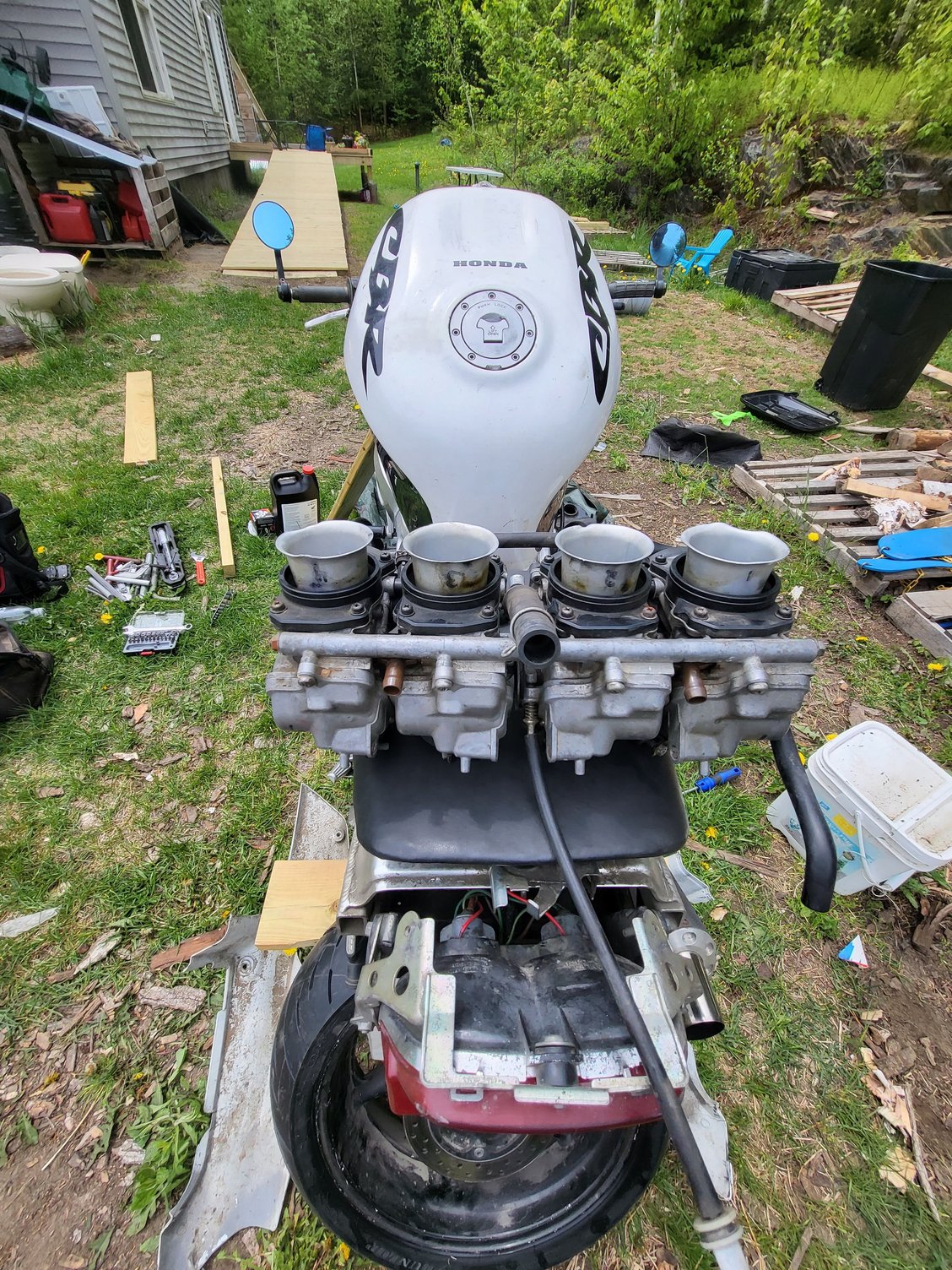

Carbies, note that the black plastic carb caps were all broken to **** and cracked really badly and i also had to order these and replace all 4.
A little carb rebuild in action here

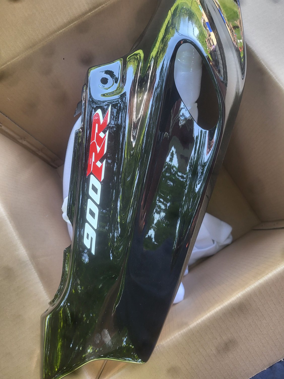

The new farings look really nice. Im not going to spoil the end of the movie but i will be painting the bike black and red. Im not telling you where what colors are going to be painted but the bike will be painted to match up with the new color scheme of the new fairings. I also orderned new upholstery and cushions for both seats as well that match the new fairings and a red fairing bolt kit.
