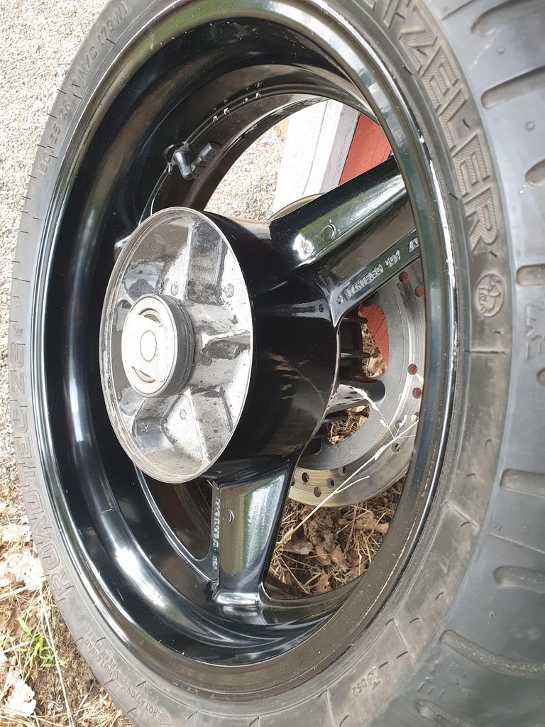

Then I removed the baggage rack because I didn't like the looks of it. After that took the rear wheel off and went to work with the rim. Holy **** what a worksite it was to get even a tiny bit of original paint to show. +25 years of chain lubricant and road dirt + pitch is a hell of a combination. I tried all kinds of solvent washes - nothing. Then WD40 and let it sit for a while - still nothing. Then my uncle suggested I try xylene we had lying around. That goo was the breakthrough. It still didn't clean up easily, but at least I was making progress. I spent maybe couple evenings alone on cleaning and after that I coated the rim with color-enhancing black wax and polished the whole thing. Overkill maybe, but I hope that my efforts ease up the cleaning process in the future and the dirt won't stuck that well anymore.

And here's the finished product:

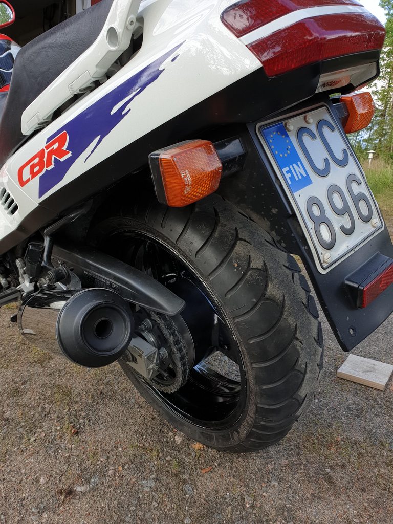

Next up was the sprocket and the piece underneath it. It was filled with the same gunk
(This is the same **** the rear tire was covered in before the "treatment")
But now I knew the tricks. Add some xylene and hour of painstaking scrubbing and I was left with a clean piece. For finishing touch I added some metal polish and voilá, I wonder if this part shined this bright even in the start of 90's...

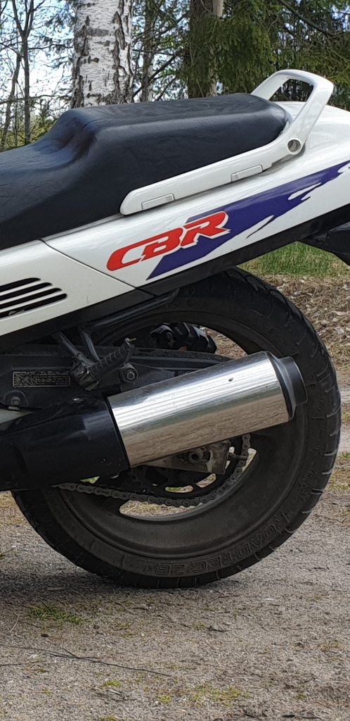

When the bike was sitting on the center stand and the rear tire was removed, I jumped on the opportunity and also cleaned the rear part of the exhaust system, mufflers, swingarm and rear mudguard.
I waxed the swingarm and the black exhaust covers. Also cleaned the chainguard

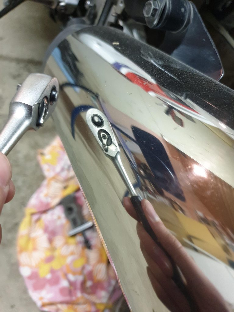

I polished the custom chrome muffler-wrappers (those are a nice touch. Almost looks like a custom exhaust)

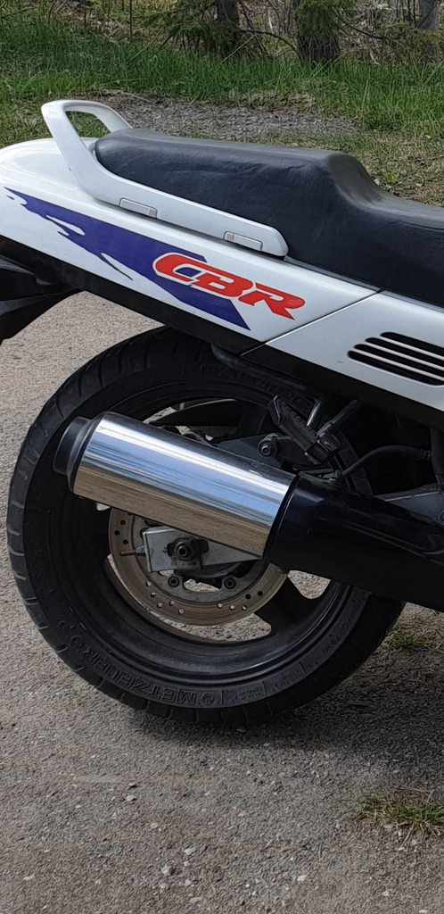

Then there was only left to put everything back to part again and I would say the back end looks mighty fine now!

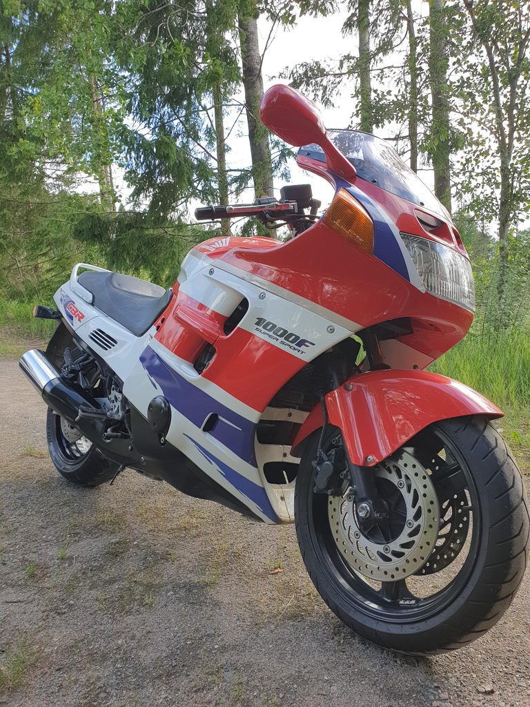

For now, the girl looks like this
