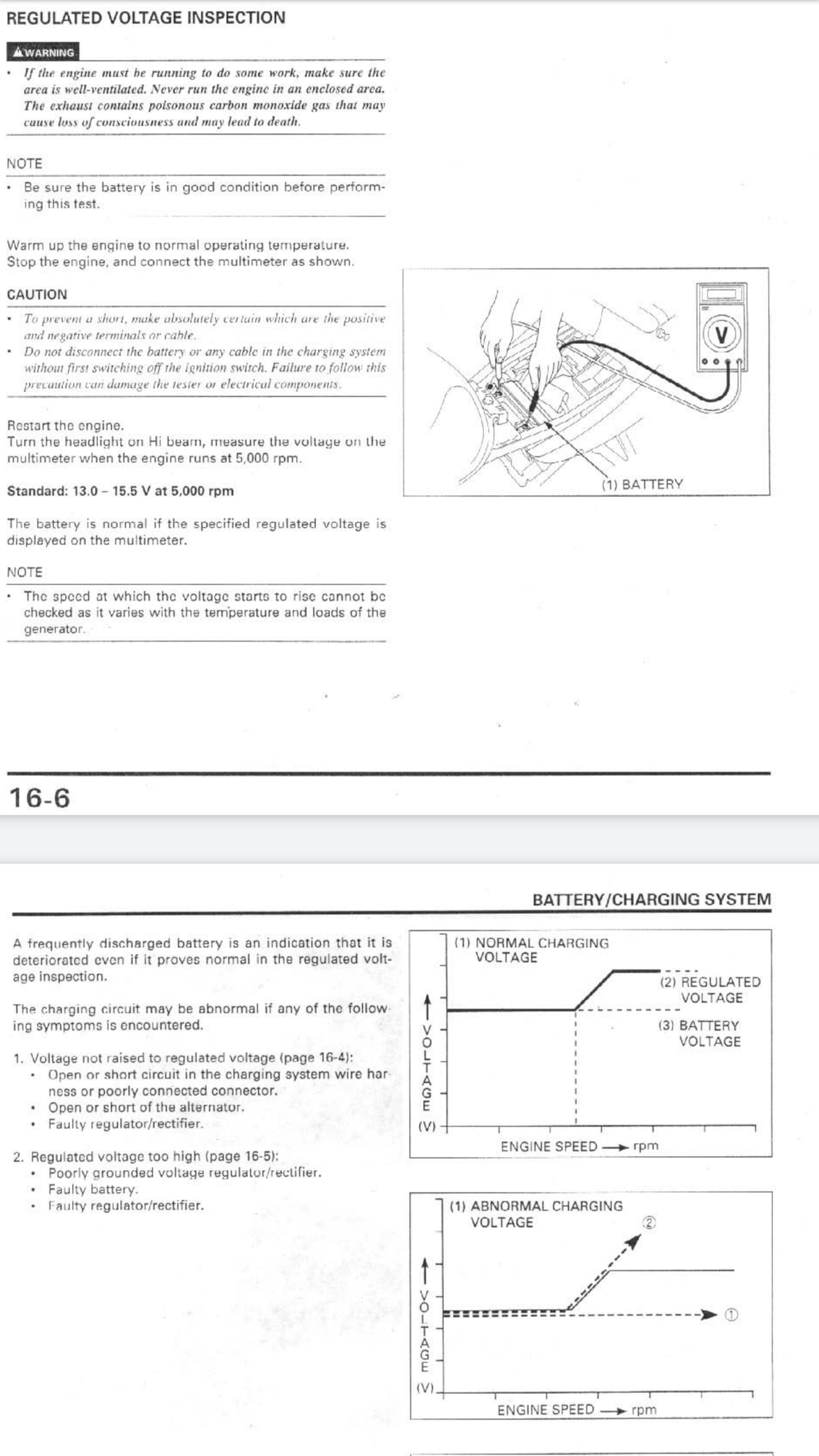

I checked the battery while idling with a multimeter and it seems to be keeping the charge ok no under or overcharging ?

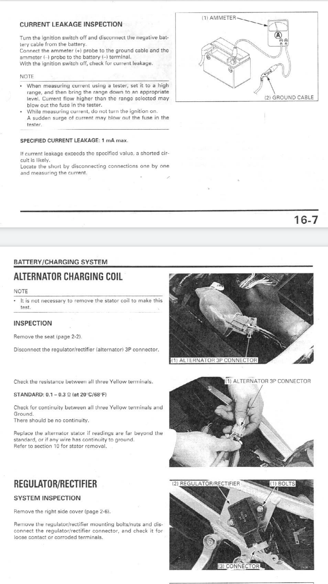

Try a continuity check at the plug coming away from the R/R. Unplug and test back to the unit. I believe shouldn’t be any. From memory it’s three yellows ( I think ?)
