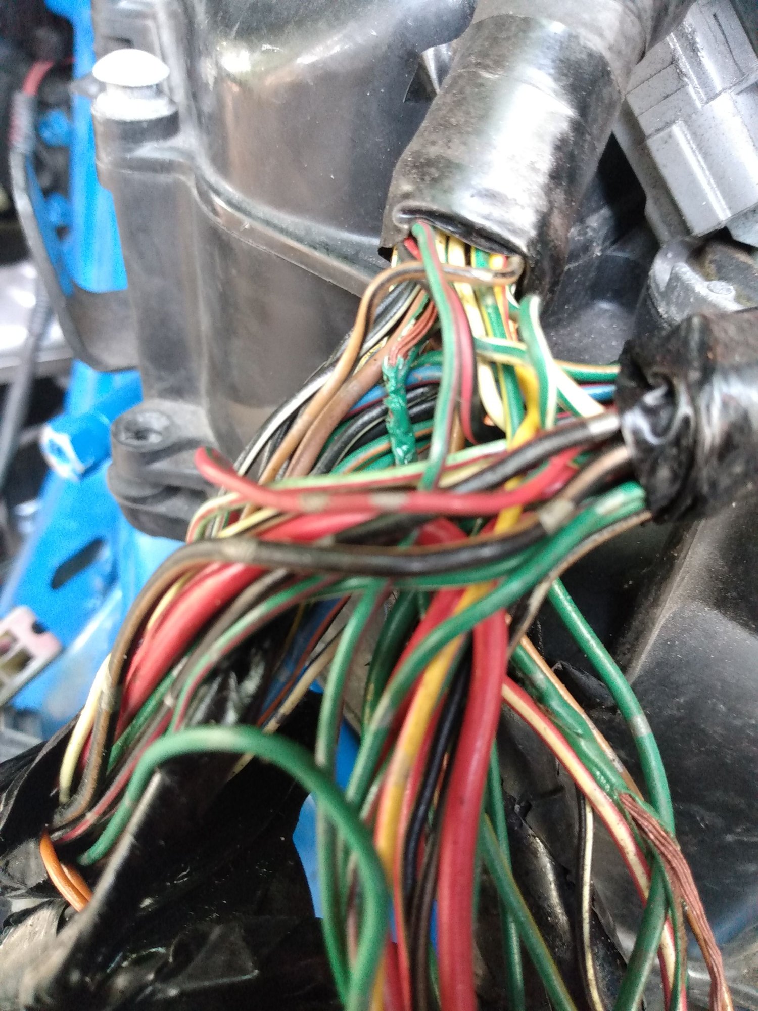

Old Aug 28, 2021 | 09:12 AM
BoomBang's Avatar
Joined: Aug 2021
Posts: 14
Found more shyte

What a mess. Your best bet is to look for another harness.
The yellow box with all the green wires isn't a fuse box, It's a ground junction.
