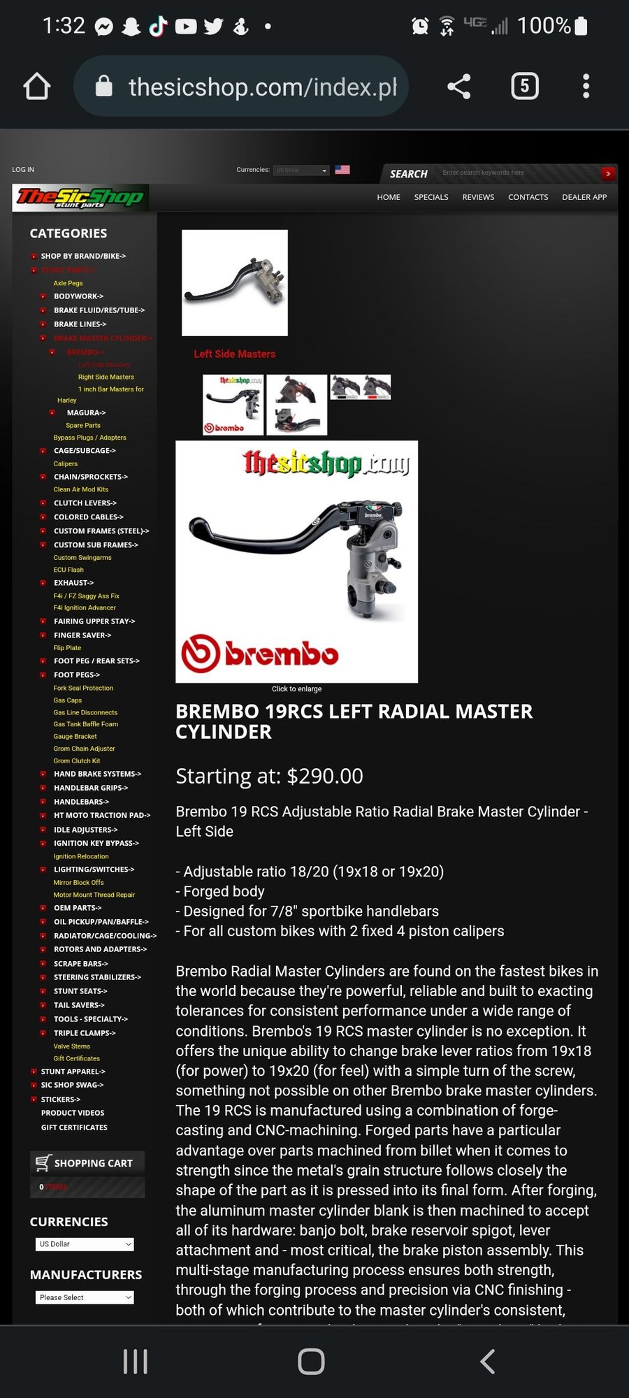

So this is basically what I'm looking at at the moment, roughly $400 for the entire setup. Not including the raised mount that I'm going to have to make or the new line/s I'm going to have to run, other than that don't really want to go with the El cheapo Chinese versions, I've only had bad luck with them..

@darkyuy OK, this helps. Pictures are surely worth a thousand words. Lets see what the community can come up with.
