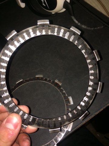

I just removed my clutch plates and found that most of the friction plates were worn in. I also discovered that the previous owner didn't put on the wave washer or the flush washer back onto the idle gear. Can both of these things
cause clutch slippage?

Yes matey
