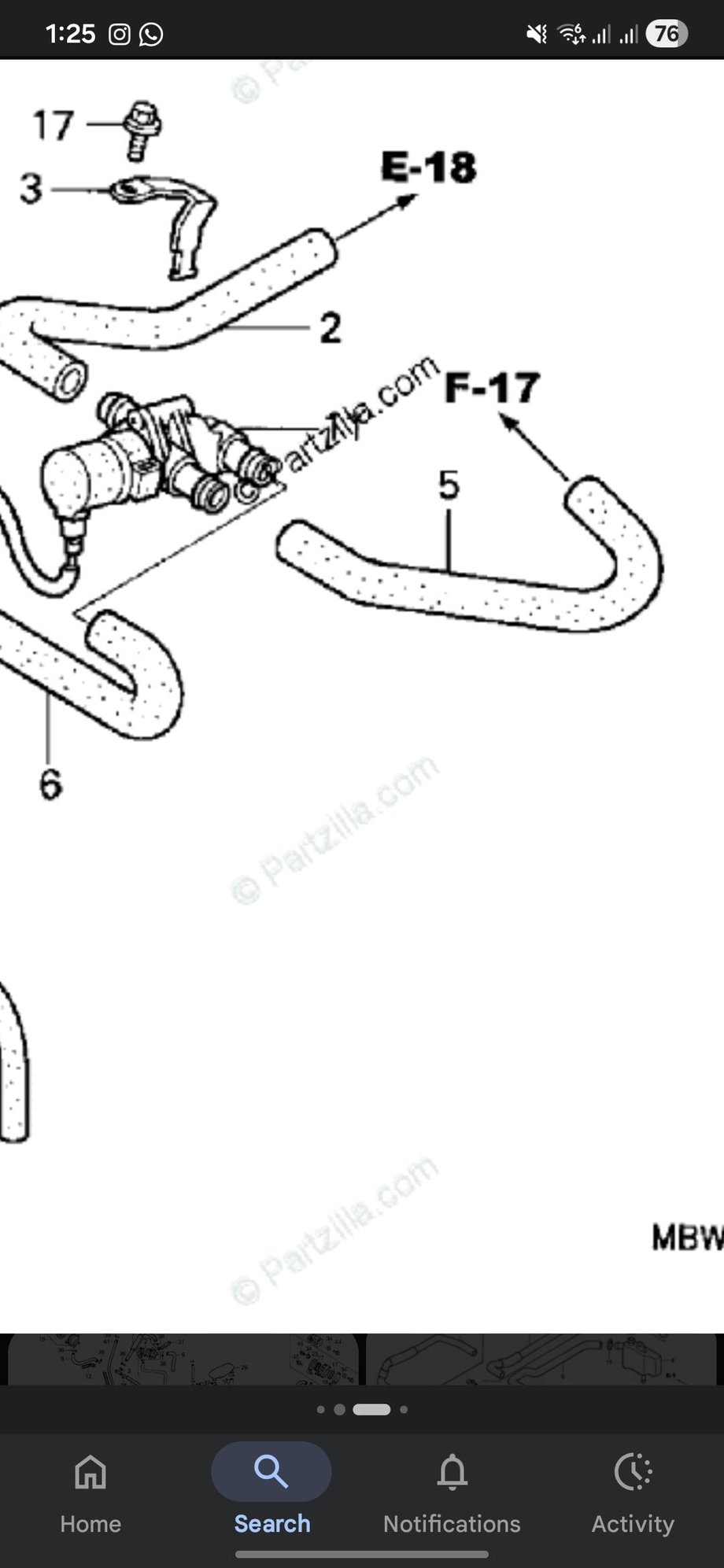

1. So i need to replace an air hose it is the: "17271MBW000" or called float chamber inner air vent hose. It is tearing from the inside. but the hose is discontinued and no where in the Netherlands it is in stock. And I just cannot find the right inner diameter to buy a generic fuel hose. It is smaller then a 15mm ID. I am thing 12mm.
and do you guys have any ideas on how to replace this hose in the best way possible
Nr 5 is the hose I need
