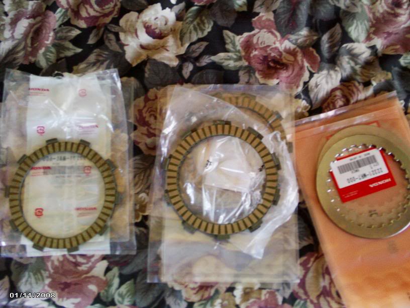

If you are going to get the OEM plates you'll need Two #5's, Five #6's, Six #7's, and Five #9's. I'd also suggest getting a couple of #11's just in case. You'll find out why later.

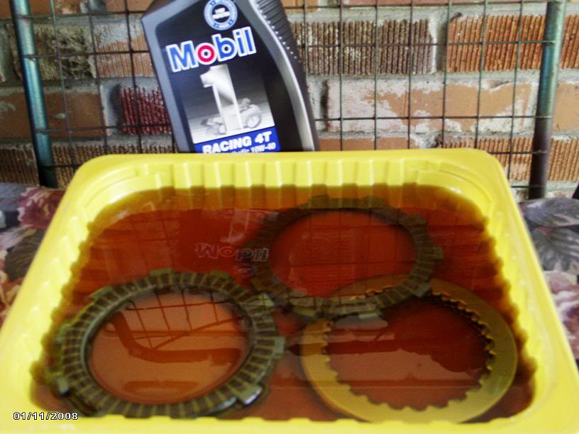

Stick them in some oil. I planned to reuse the oil when I was finished but a fly landed in it and probably a couple of other things too.

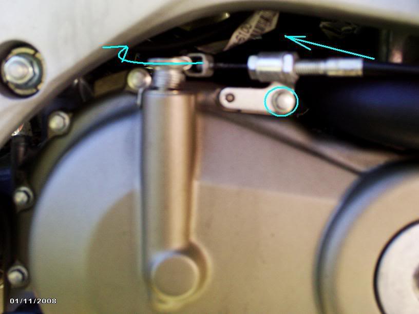

To take off the cover unscrew the bolt thats circled then disconnect the clutch cable from the lever. Proceed to turn the lever counter-clock wise toward you. That will seperate it from the lifter piece inside. Next, unplug the clutch from the wire harness. The blue arrow points toward it. Then just unscrew all the bolts around it.

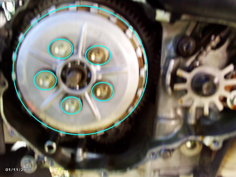

Unscrew all five spring bolts then you'll beable to remove the pressure plate.

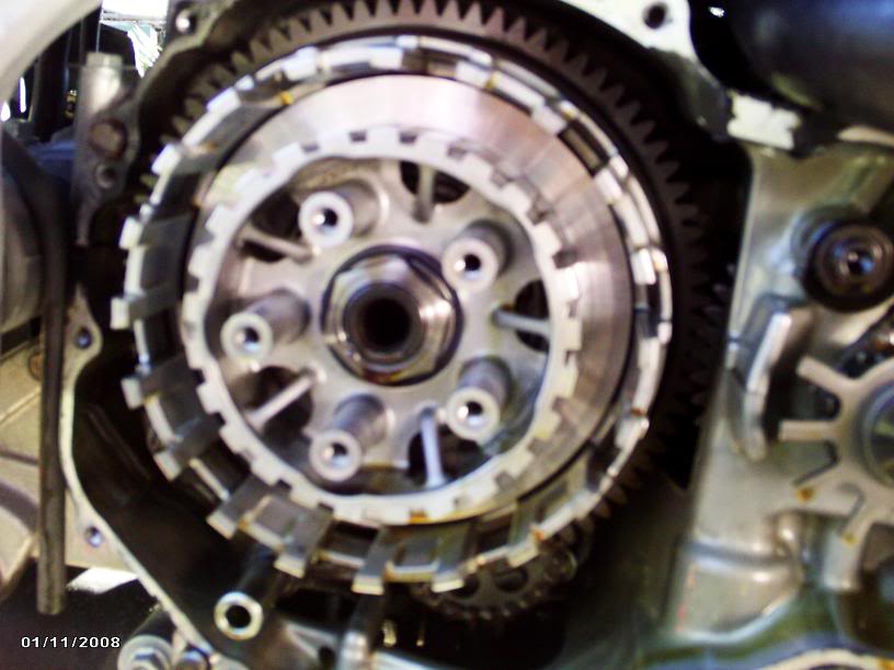

Take out the clutch. You might need to use a flat head screw driver to pry out the last few plates.

Now to put in the new one. You will put them in the deep gooves. First, put in a #5 then a #7 and then a #6. Repeat till your out of #7's and #6's and the last one will be a #5. The last one will also go in the shallow groove.

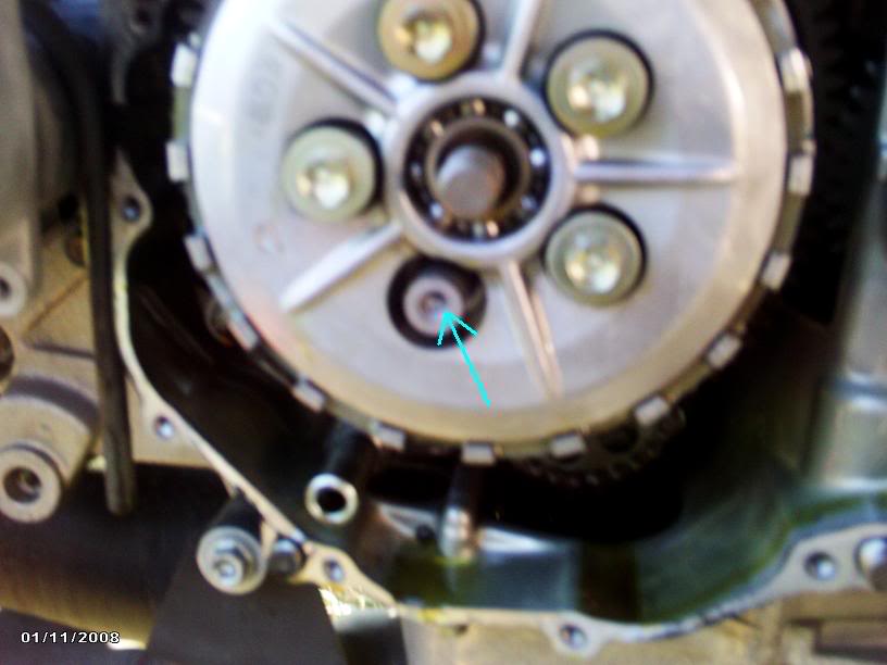

You can go ahead and put the pressure plate back on. Put in the new clutch springs and tighten them in a star pattern. You'll need a torq wrench and set it to 9ft/lbs.

If you over torq them the heads break off easly. I fount this out the hard way. TWICE. I had to drill them out. Thats why I suggested to buy a couple extra screws as they are specially made. I had to go to the hardware store and find a new screws and washers that matched the old ones.
