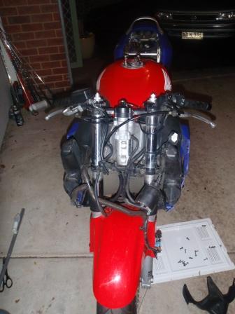

all the bits off
and the bracket that you will need
and the middle photo is where you mount the speedo and mirrors to and look at the big crack in it got it for free but dont think it will do apperently if ur in a crash its the first thing to break so im going to have to buy a new one, ill ring my honda dealer tomorrow

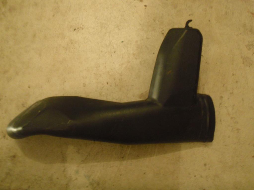

airbox duct are to big but if you look at the pic there a big bit that just sticks up ??? whats it for???
can I just cut it???

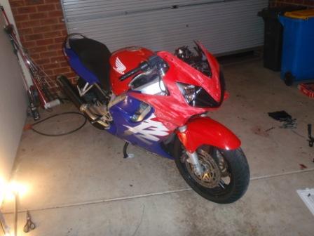

and this is it so far
those bumps are where it is held onto the fairing stay. You'll need the F4i ramair covers too and they will cover the bumps up
