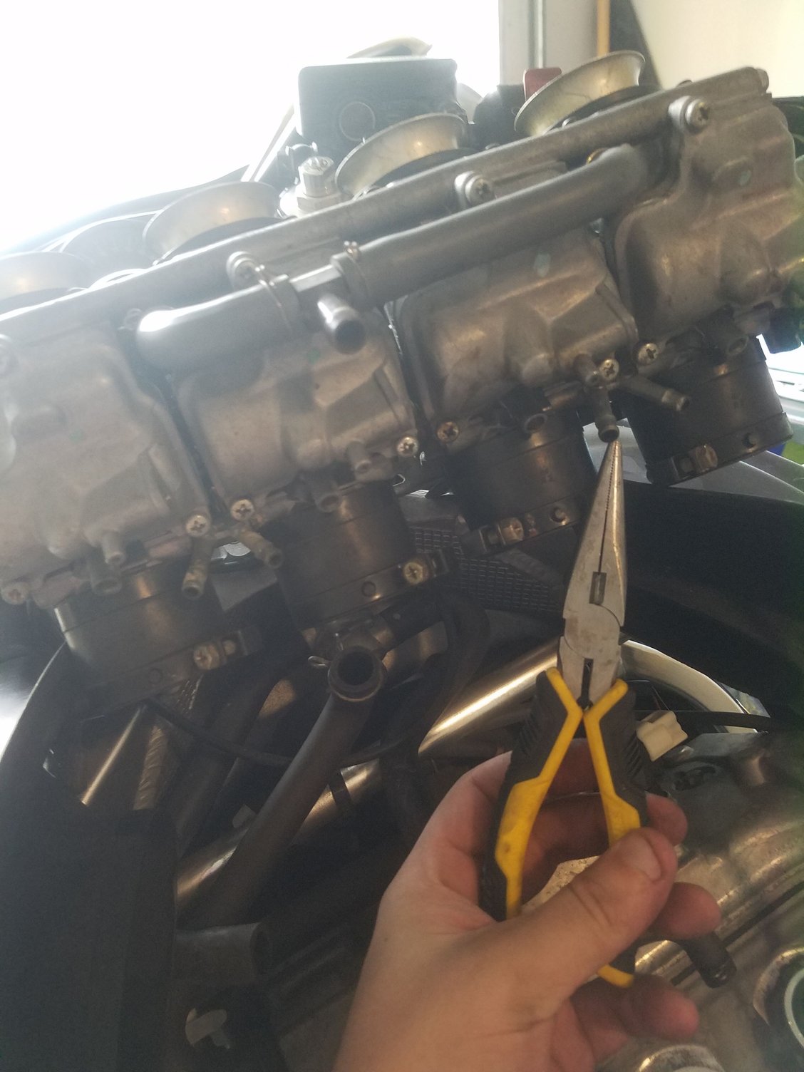

So i have a terrible coolant leak that happens when i turn the bike on for about 45 seconds. i found a cracked hose that was attached to my throttlebody/carb and i want to just double check this is what i am looking at and if someone can point me in the direction of the part...
and educate me as well. working on never having to see a mechanic again!

You are correct. Those are coolant lines. They aid in keeping the carbs from getting too hot. Looks like you've already done the hard part by removing the carbs.. You can buy OEM replacements from a parts site or a dealer. I'm thinking a fuel line of the same diameter from a parts store will work also.

Looks like a standard sort of auto hose to me. Go to a motor factors and you should be able to buy it by the metre. Much cheaper than the main dealers

Hey quick question. From right to left of his picture about the coolant lines, Where does the first line go to? I have my set back together but i need to know where i tie that one into?

@cbrjamesdean little late for my response. but the 2 fixtures i am referencing in the pictures have a hose going from one to the other. The other hoses the the left and right of those 2 were fuel hoses. I honestly cant tell u much more. But if you google around and read the mechanical manual then u can possibly find your answer. Sorry!
