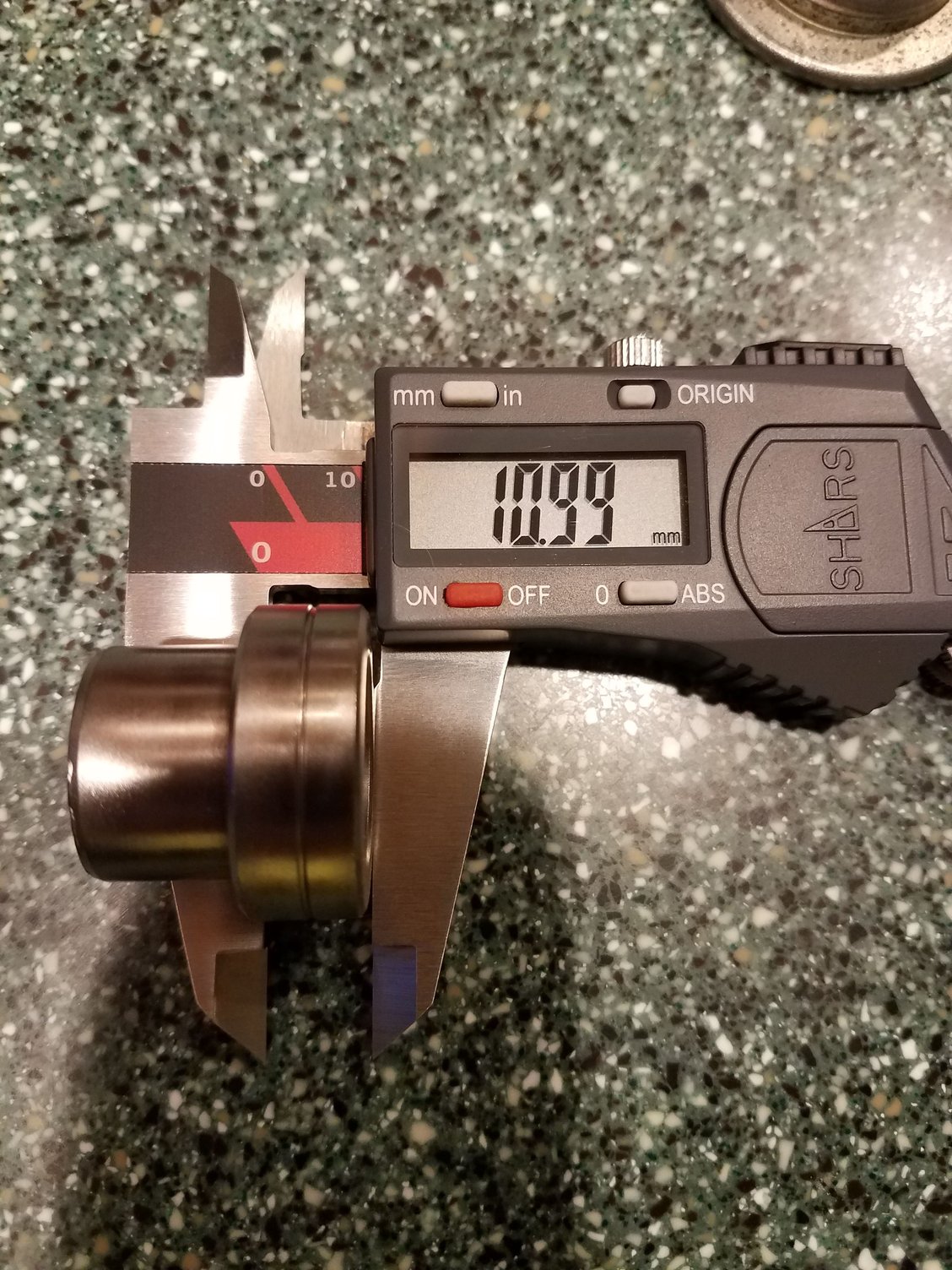

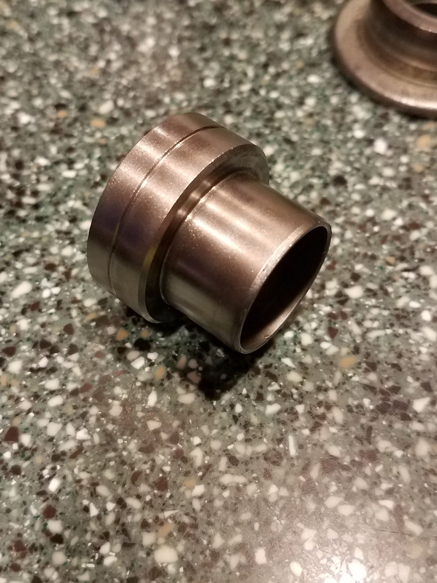

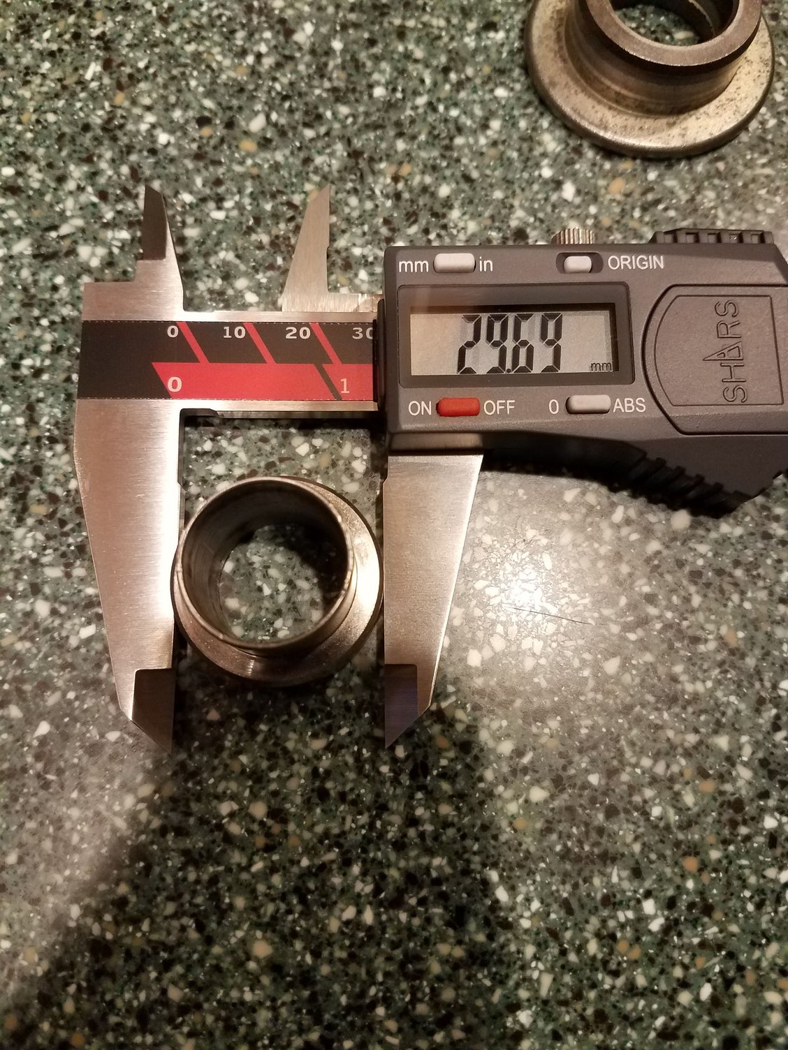

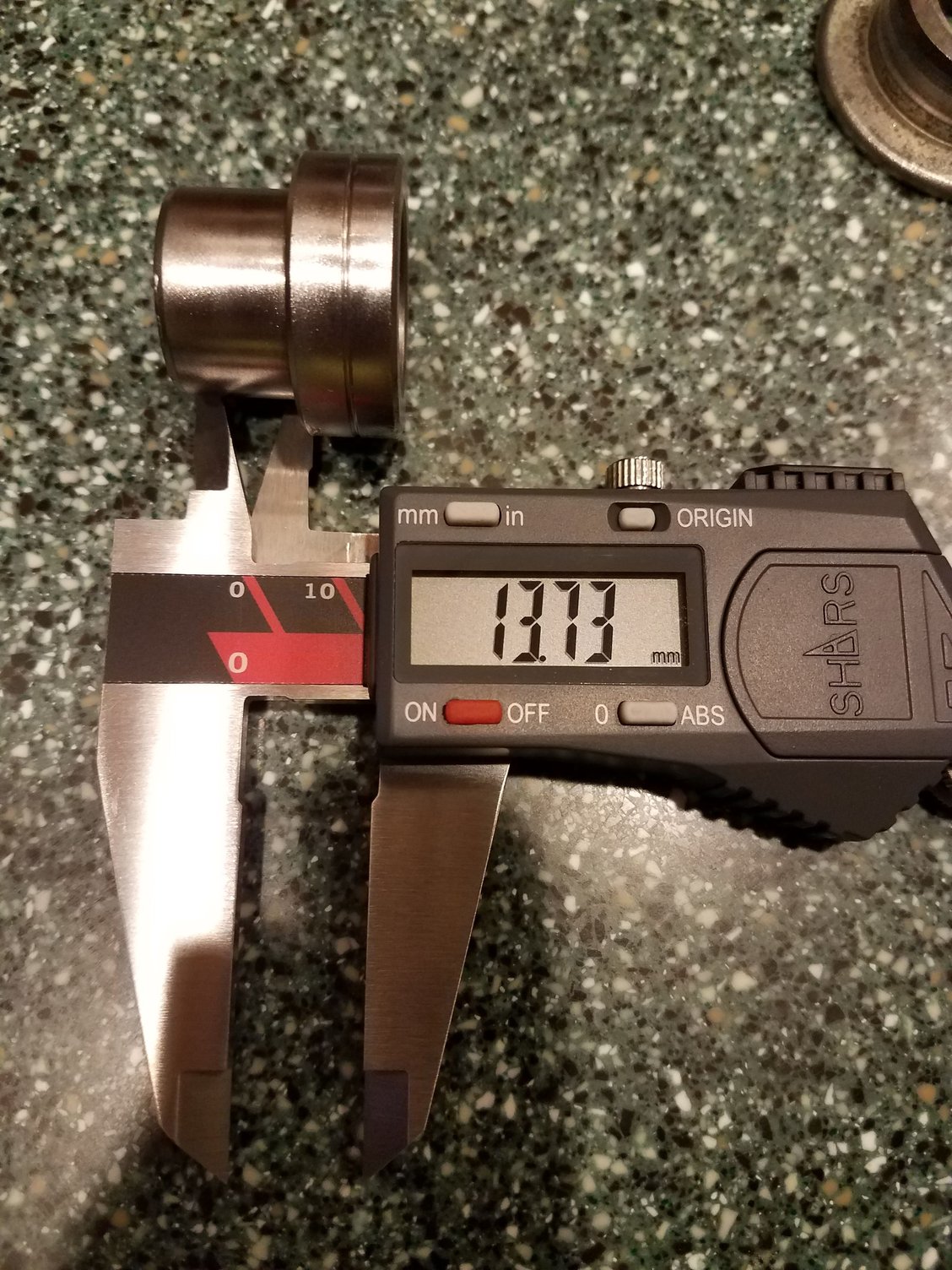

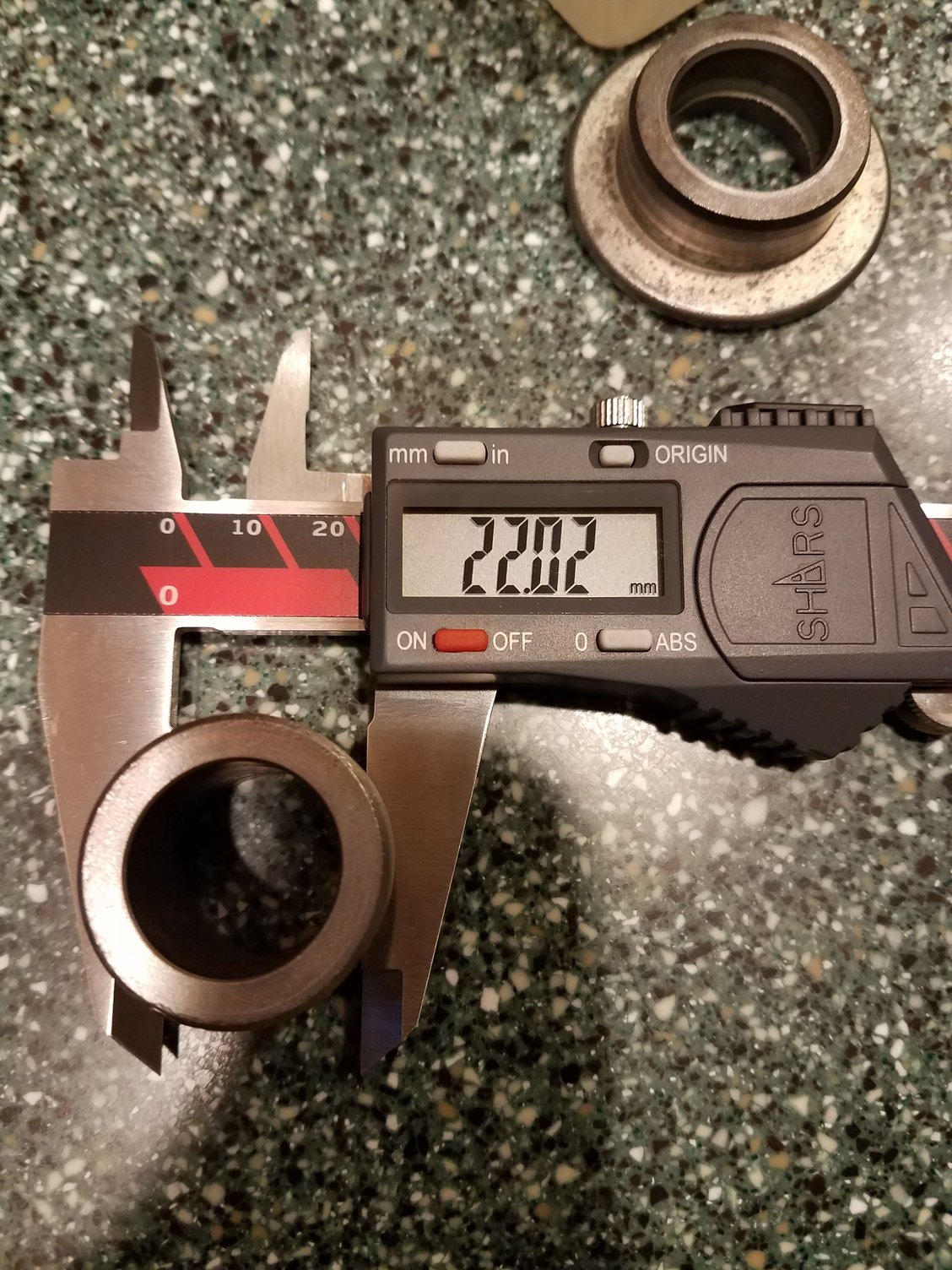

@CPH007 Well, because I was in a friendly mood (and you never know when you might need the help of someone that has access to CNC equipment, LOL, JK), let me know if this helps.

Help? That’s bloody perfect, thank you. Did you take the wheel out for this? If so I owe you one 👍
love the rear end on your bike, looks like from a newer bike.
thanks again, will knock up a spacer now or maybe 3

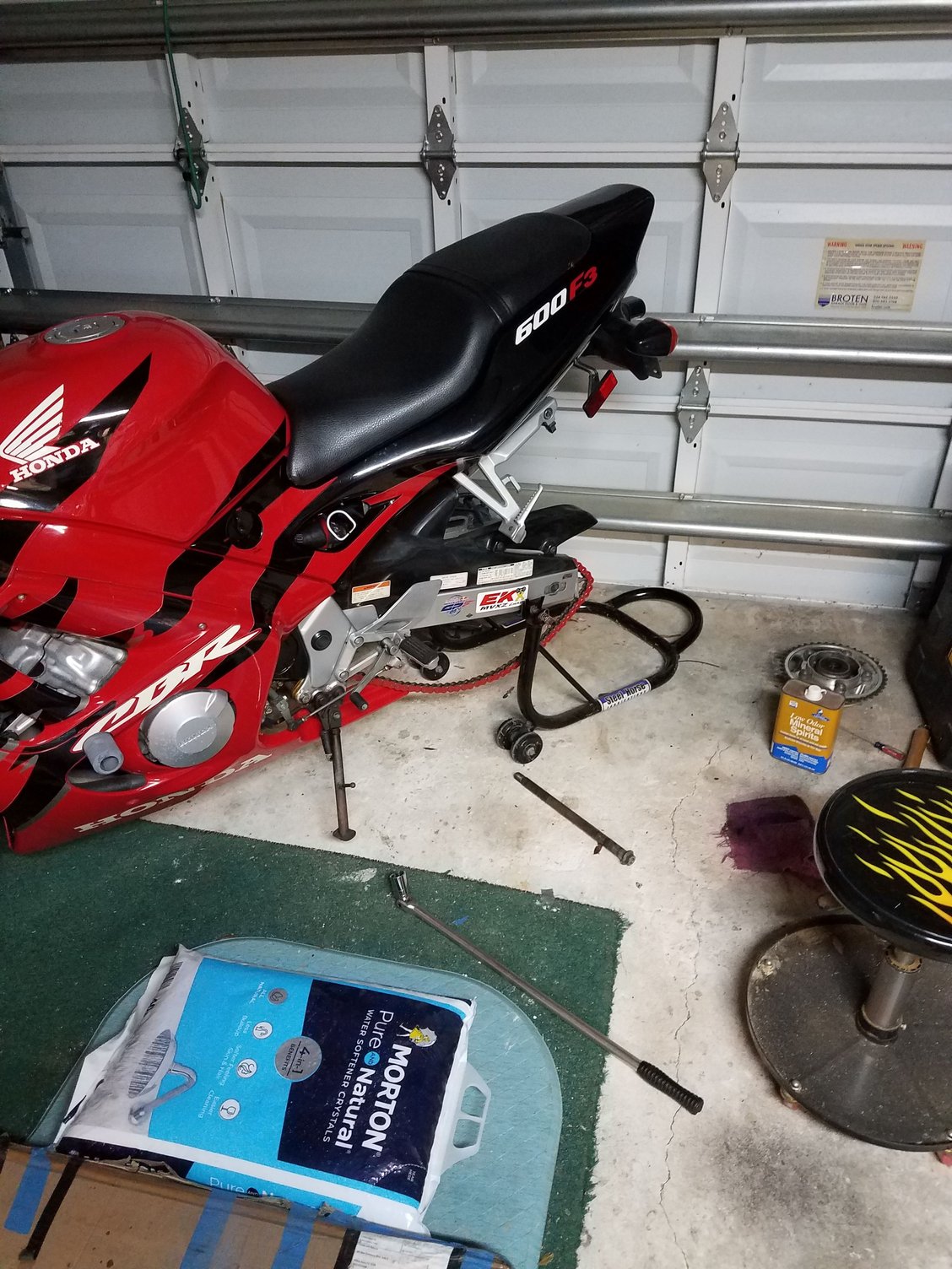

Yes, I took my F3 apart for this. Had to move the F4i to get to it as it's in front of it. BTW, my wife thought I was insane, she's probably right.
That is the standard rear end of an F3 in the US. They did not have the rear grab handle on them like in the UK.
Yes, you owe me... for sure.. LOL.
