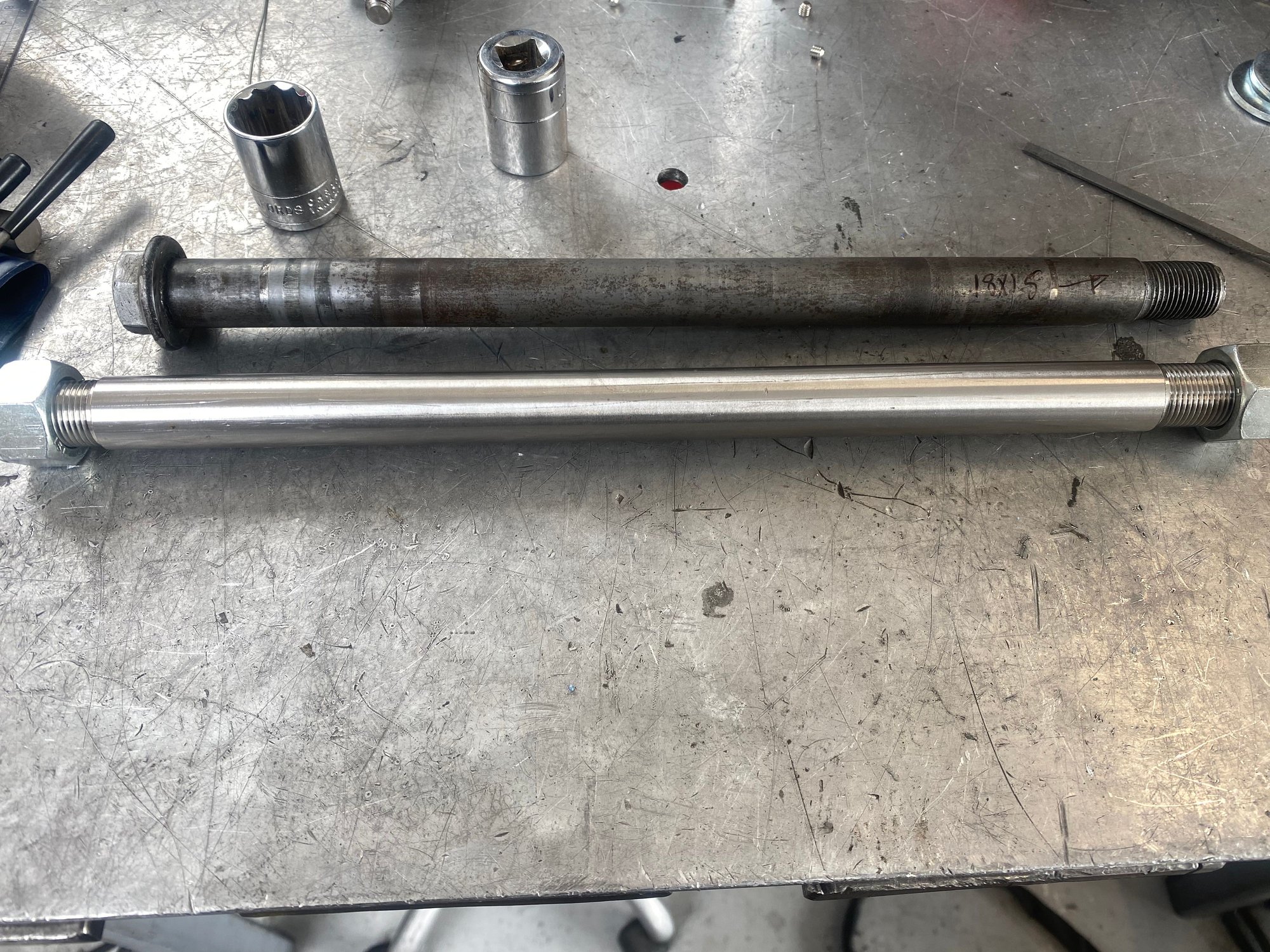

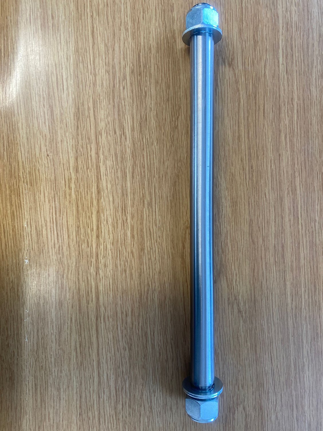

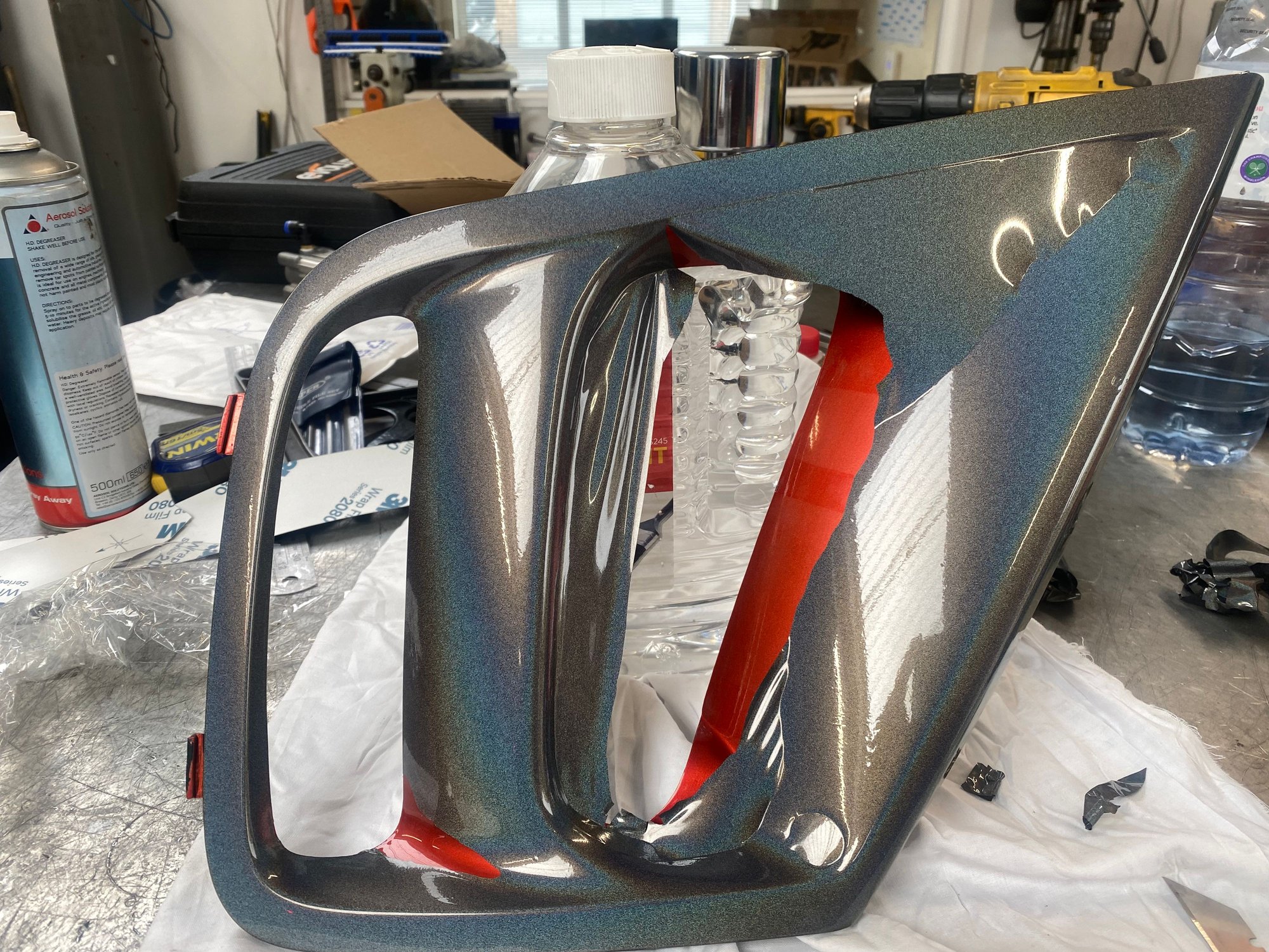

New Axle made for rear today and new spacer for the Cush drive hub.

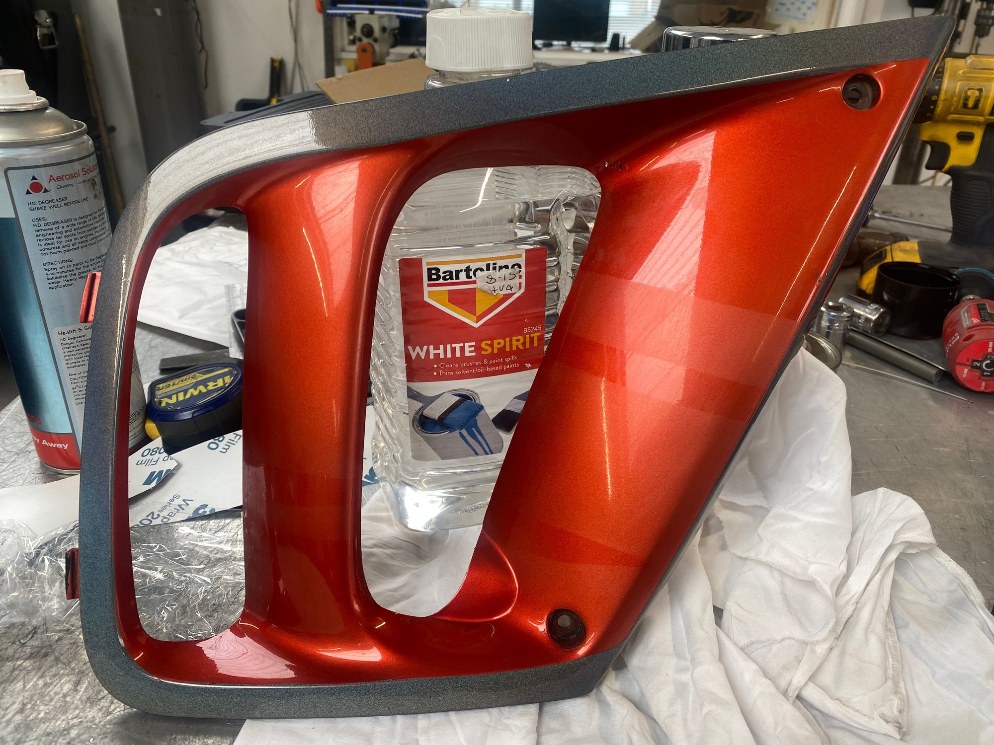

started trying to learn to wrap also. Attempt 2 this weekend with inlays
Old Sep 11, 2021 | 10:03 AM
  #22
CPH007's Avatar
Joined: Sep 2021
Posts: 21
Likes: 11
Now finally got it wrapped but next one will have different inlays to improve. Happy with it for first attempt though and down to the help of CK Wraps
Old Sep 11, 2021 | 03:35 PM
  #23
Man that's awesome! Axel and wrap both look great. Nice job man.

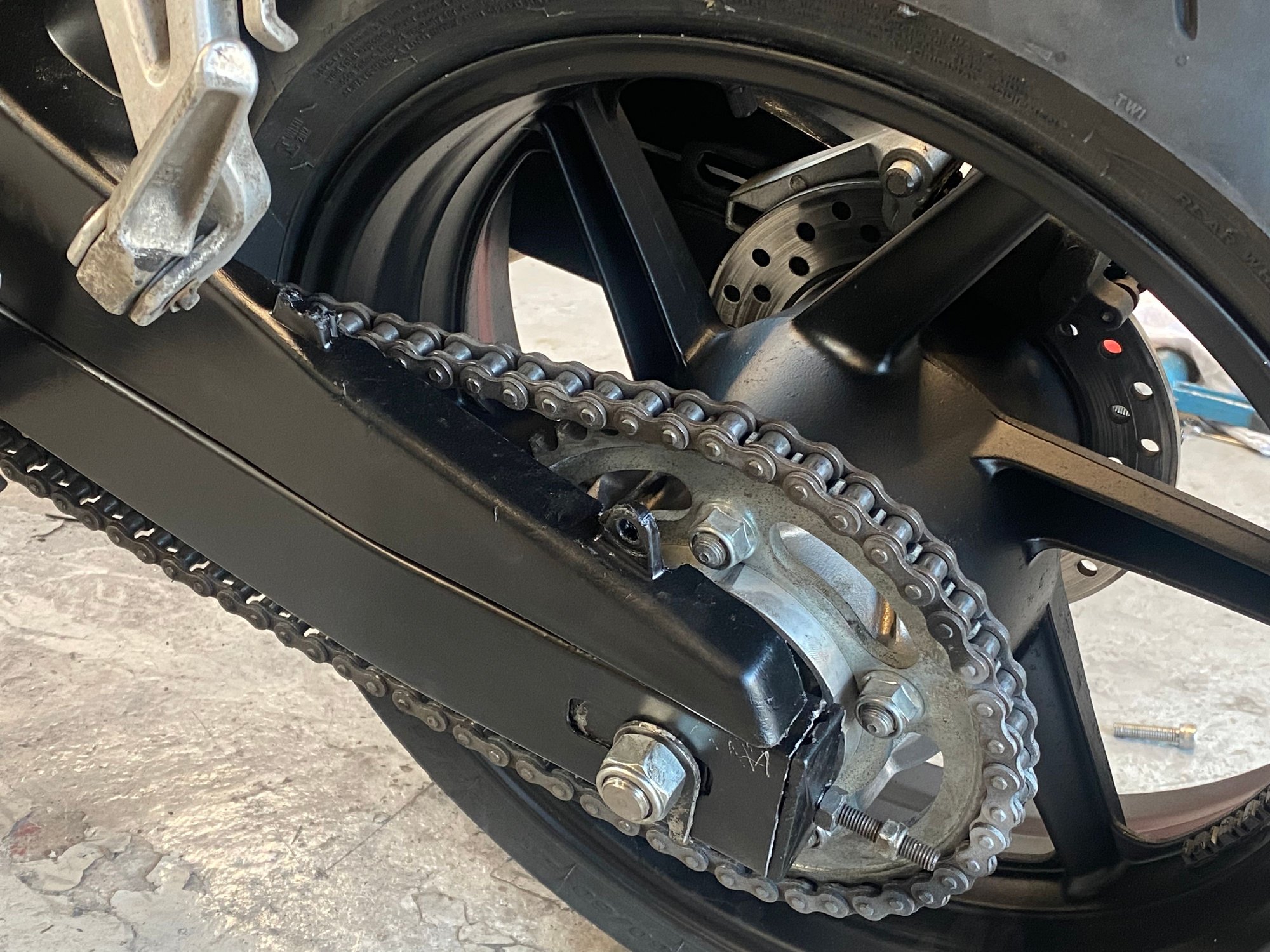

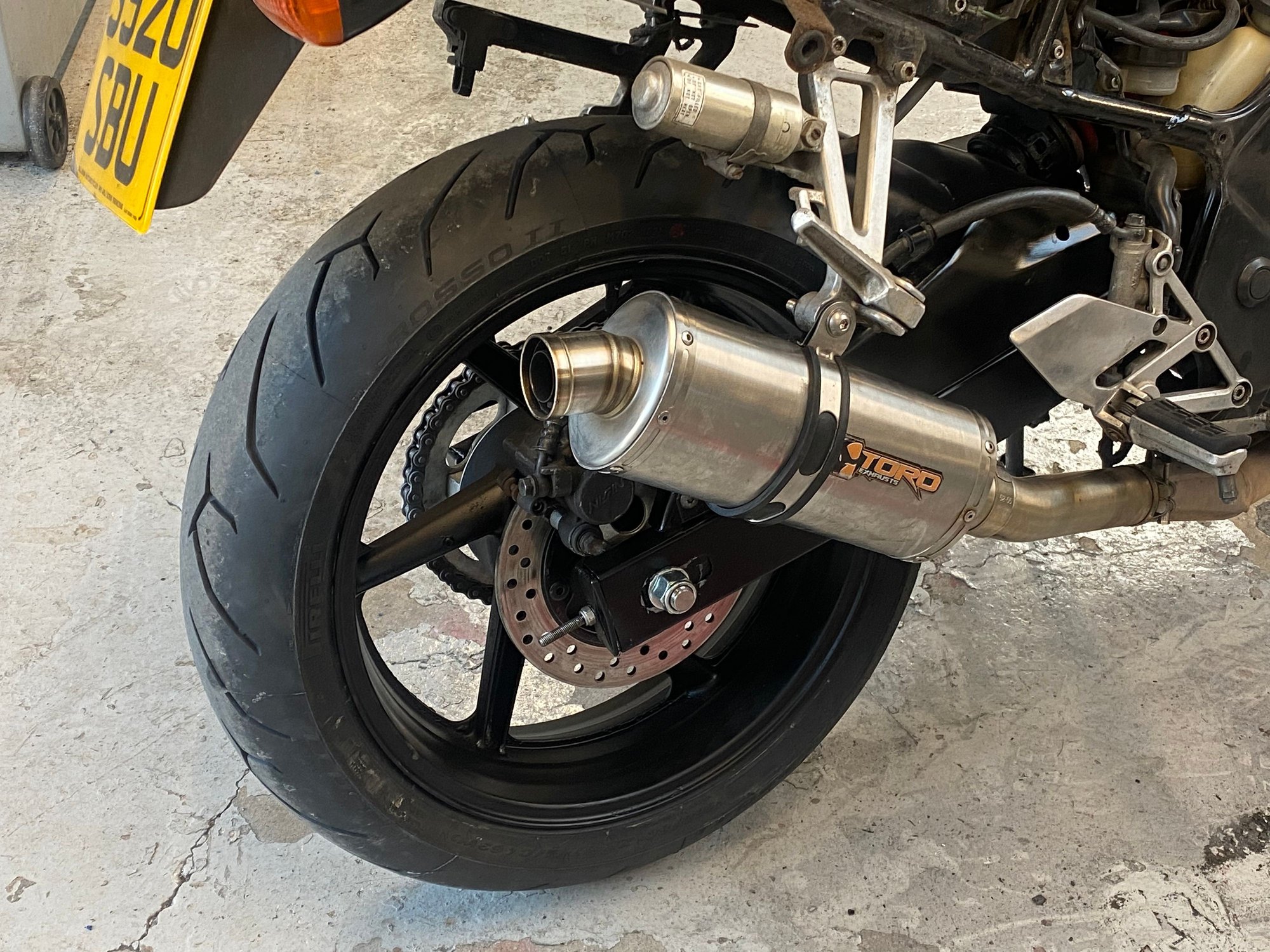

Rear end is finally assembled and a quick test run to check OK.
All felt fine except rear brake is very weak but probably pads glazed due to continuously running disk before. I’m guessing fluid might be cooked also.
Will get a set of pads on her ASAP. Rear end now all
satin black ready for the wrap.

I'd flush the fluid for the brakes as well. Nice job man, congratulations.
Old Sep 23, 2021 | 04:50 PM
  #27
Oh yea, after you get your rear wheel aligned, don't forget to put the lock nuts on the adjusters so they don't move.

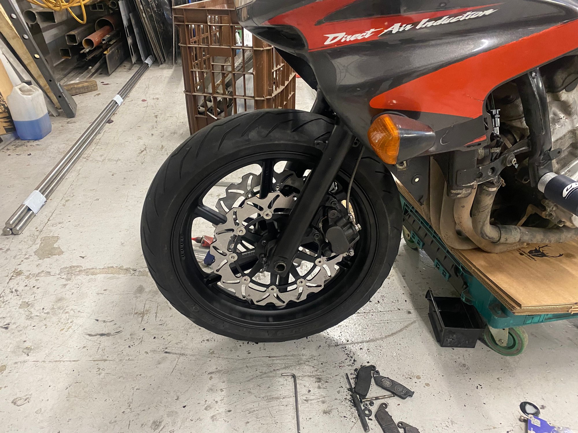

Managed to get some more done. Fork seals completed shot and seized in there solid. New seals after local bike shop helped get them out. Then callipers had been bodged and disks were shot also.
this cheap bike doesn’t seem so cheap now! New disks and sintered pads
Old Oct 19, 2021 | 04:26 PM
  #29
Looking good, nice job.
