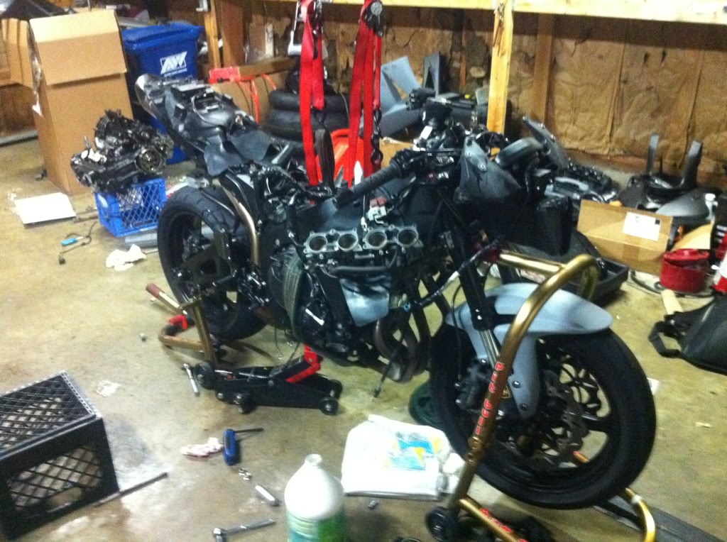

I am currently doing this exact same thing (https://cbrforum.com/forum/cbr-600f3...-ol-f3-139381/). Have the engine sitting on a flat board that is on the ground. It's stable and you don't have to worry about the engine falling. With the frame only, lower it onto the engine with a engine hoist/cherry picker. You can control the rate of decent easily with it. Once the frame is on the engine, you can then lift the frame up and begin installing the suspension.
