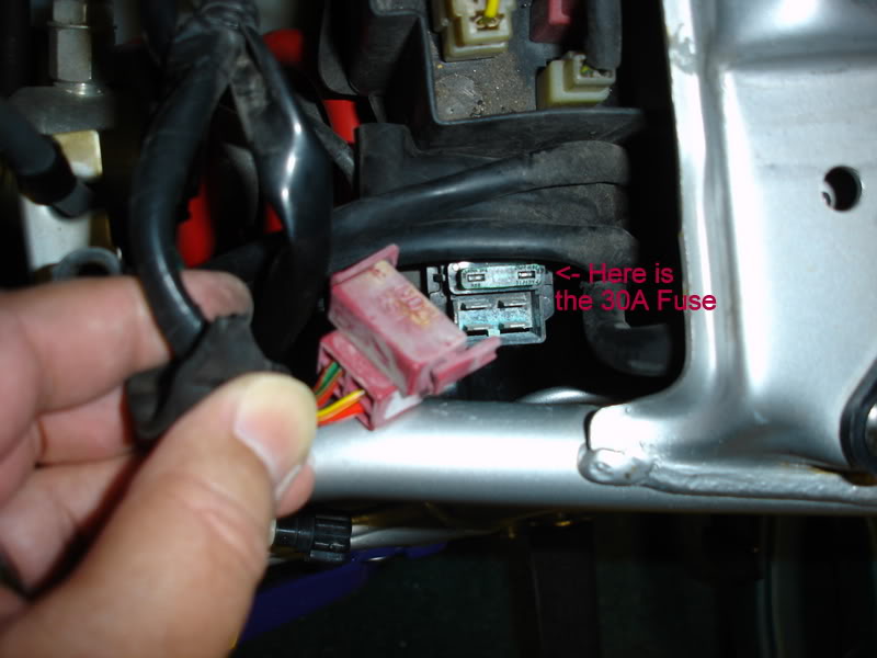

I don't know how your bike is wired since it's been modified. The clock could be wired directly to the battery. If everything is off, then I'd check the main 30A fuse. It's near the battery, just in front of the bracket that the rear of the tank is bolted to. It's part of the main relay.

that did the trick, and here i am taking everything apart -_-.. thanks again for the help!
Old Mar 30, 2011 | 10:51 PM
Well, that's great, but that's only half of it. You've fixed the symptom, but you haven't found the cause. A blown fuse, particularly the main fuse means that something shorted out to the frame. You also know that it's not something that's tied to any of the other fuses since they didn't blow. I'm thinking probably something with a fairly heavy wire.
