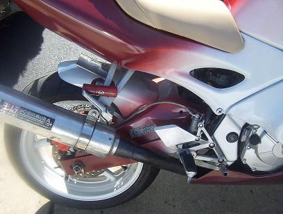

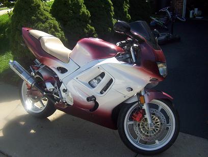

Nope, did the samething, it would have cost me $400.00 to have the F3 shock rebuilded. Look though the club and saw that the F4i would work and lift up the rear a bit higher. Look at a couple of bike with it install and was sold.
The only issues is the hose is mounted on the other side of the shock and that hangy thingy is mounted by the idle adjuster ****.
I am 6'4" and i love it, don't feel like I am on a little bike.
If you under 6' in height I wouldn't suggest getting the F4i and just stick with the f3.
See my bike with the F4i shock on
