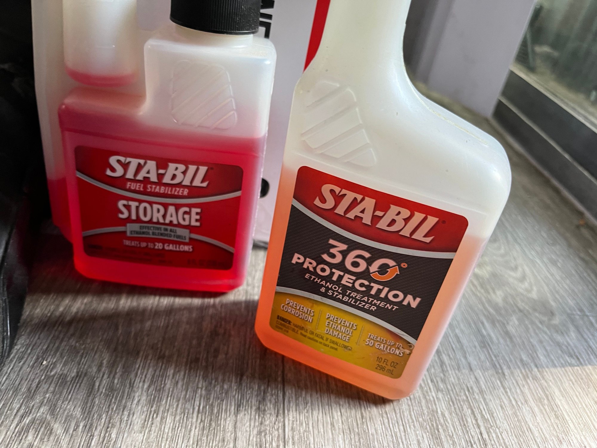

New on the left both don’t have expiration dates.

At this point, too late to use Stabil. That’s what you want to put in before storage. Now it requires completely disassembling carbs down to every last bit for scrubbing and cleaning.

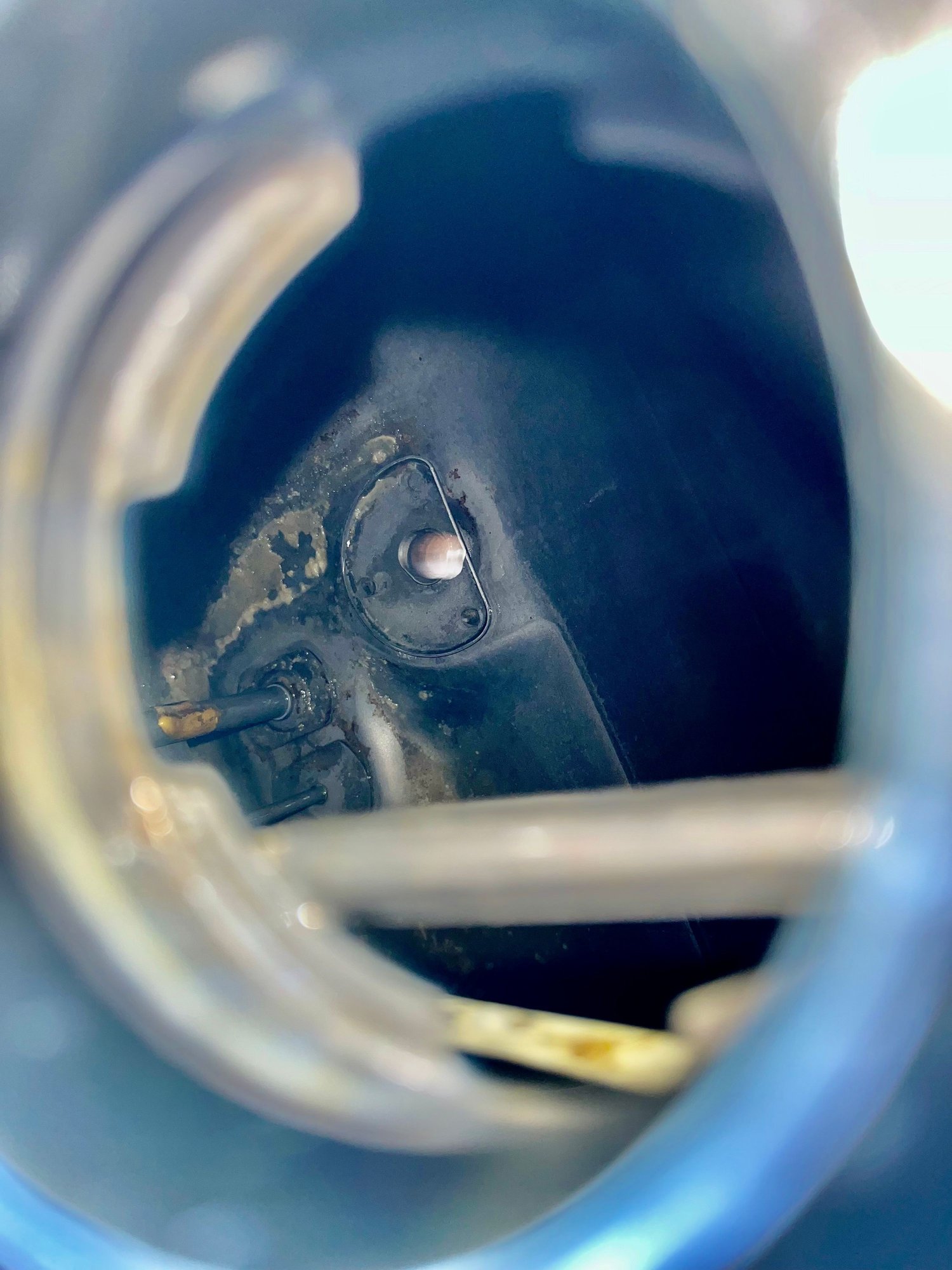

is there anything could use to wash the inside of the tank out with that does not cause flash rust? Maybe Evaporust?

nah, any bare metal will rust. Rust-removers actually just make it worse by removing rust coating and exposing bare metal below.
Phosphoric-acid works best because it leaves mildly protective phosphate coating. Can find at Home Depot as concrete stain/rust remover. Read label carefully to make sure it's 100% phosphoric acid. Best to completely fill tank with petrol immediately after rust removal.
