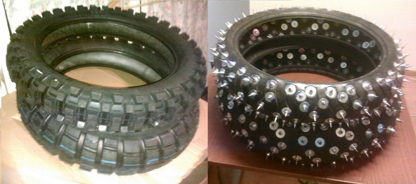

I have found what im looking for on EBAY 13/48/50
I going to be using these tires Pictures below sometimes & i want the gearing to be "more fun"...
With the spikes, the rollingressistace is very big indeed & you probably will never reack above 120mph at all, with the moto-X-tires i just want to have fun on gravel roads now & then.
