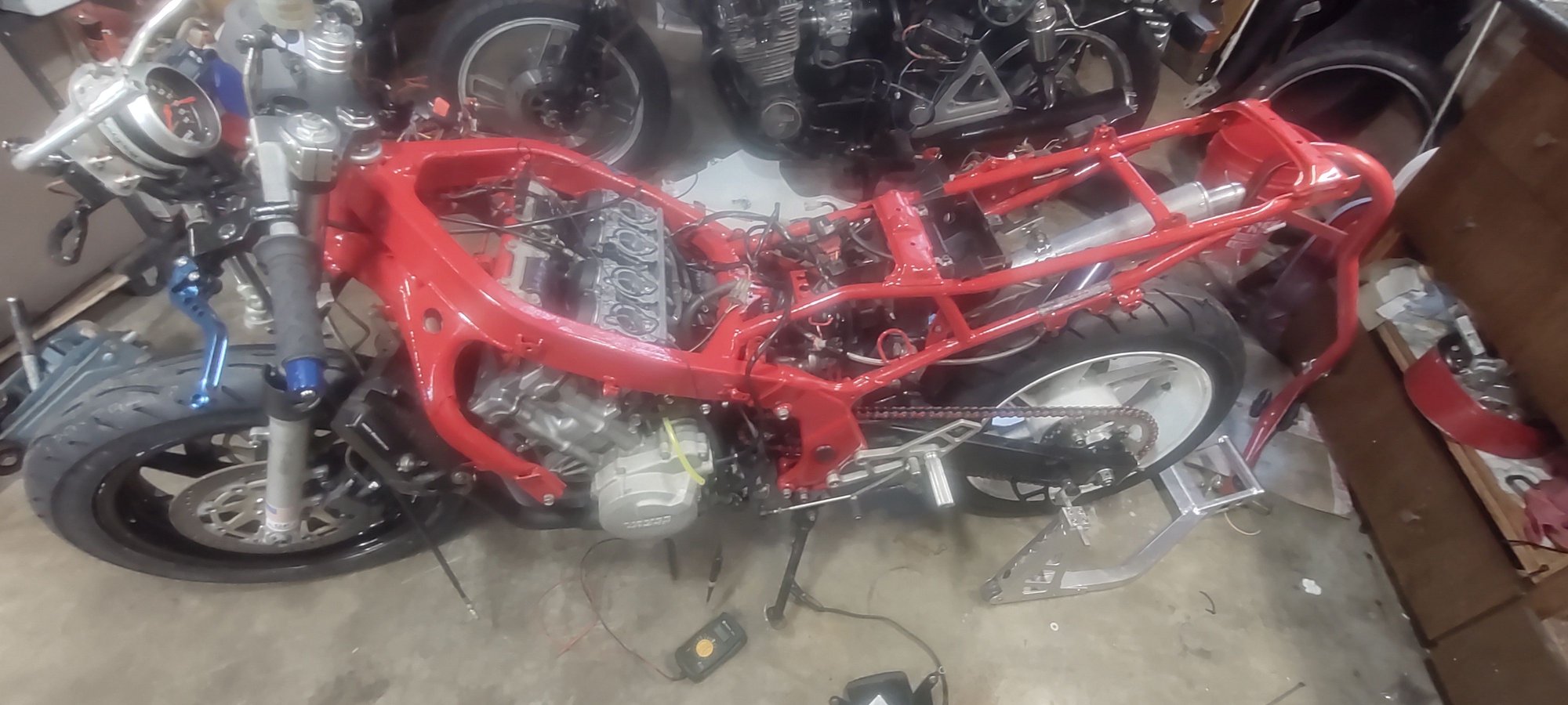

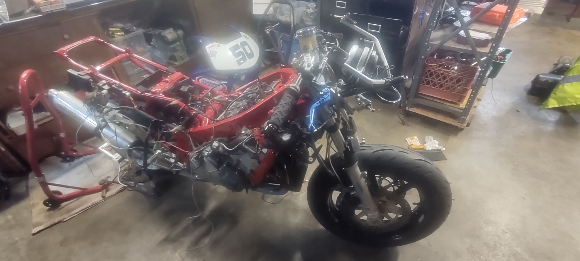

I'm no stranger to renovating bikes, cars or planes, but this 95 CBR 600F3 is new to me. It was running when I got it. I switched everything over to a titled frame, hooked everything back up as it was ( or so I think), but nada. I have power at the switch. Both the kill and start work. Juice gets through the start wire to the 4-pin connecter on the solenoid, but that's where the fun ends. No fuel pump noise, no starter turn over...I bridged the solenoid poles and the starter works.
Solenoid is shot, I guess? The ECU, maybe? Usually the ECU wouldn't prevent a turnover, would it? Am I overlooking a common ground somewhere? I'll figger it out eventually, but a friendly tap on the noggin helps...
I actually did not snap a single photo after I brought it home, very atypical of me. The attached are how she looks, right now...
Not much to see now...

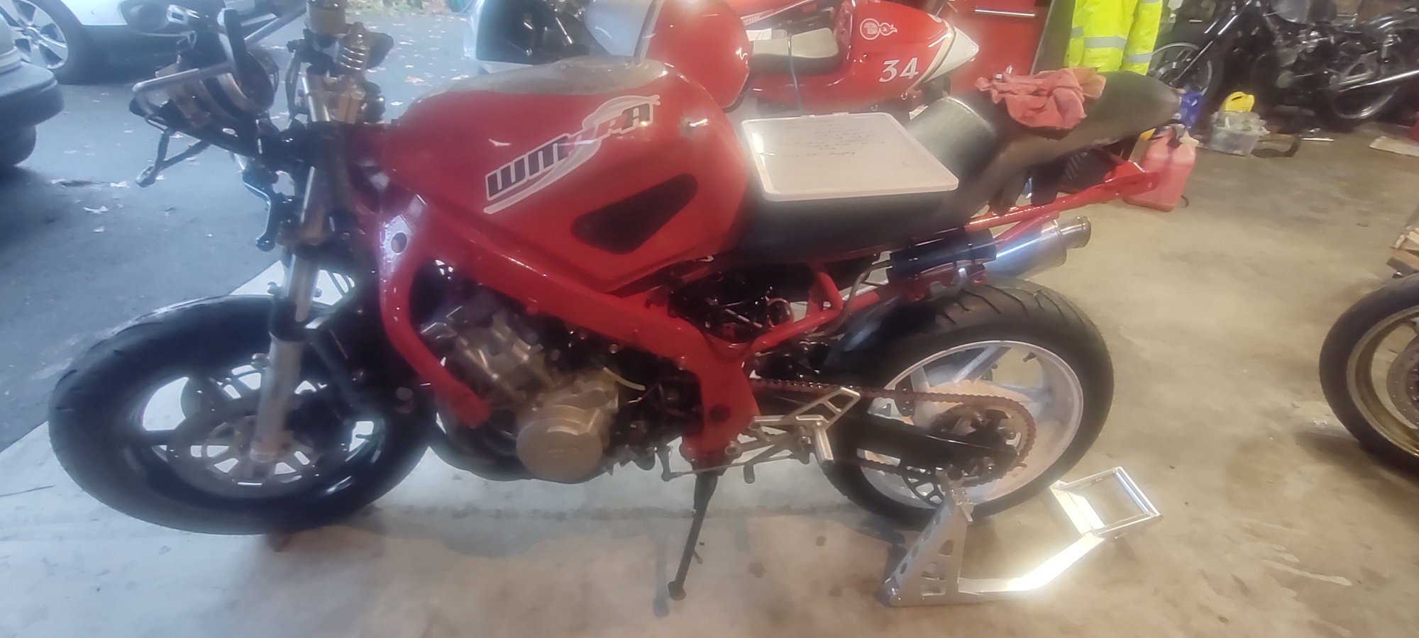

Here is a photo of the F3 assembled, right after a test run. She rides nice, but I have some tweaks to make - throttle, chain, clutch. Front wheel wobbles a bit, even though it was perfectly balanced by the shop...I have a street 95 F3 that I just picked up. The racer F3 sits 1" higher in the back, even though everything looks identical. Will see what that's about...
