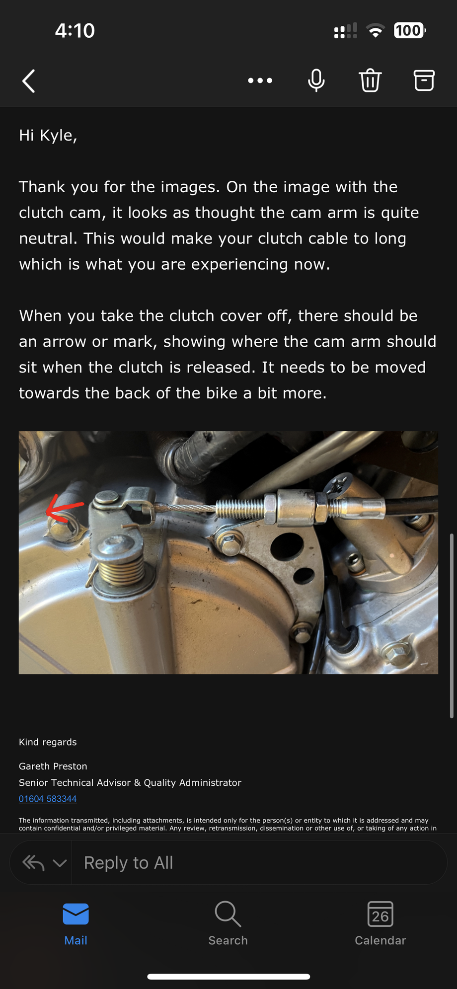

How's your bike's cable & clutch-arm compare to their photo?
This was their photo. I explained with the arm back the lever won’t pull far enough to engage. Most likely needs a longer adjustment bolt.

Post photo of your clutch arm and lower adjuster. We can compare to theirs.

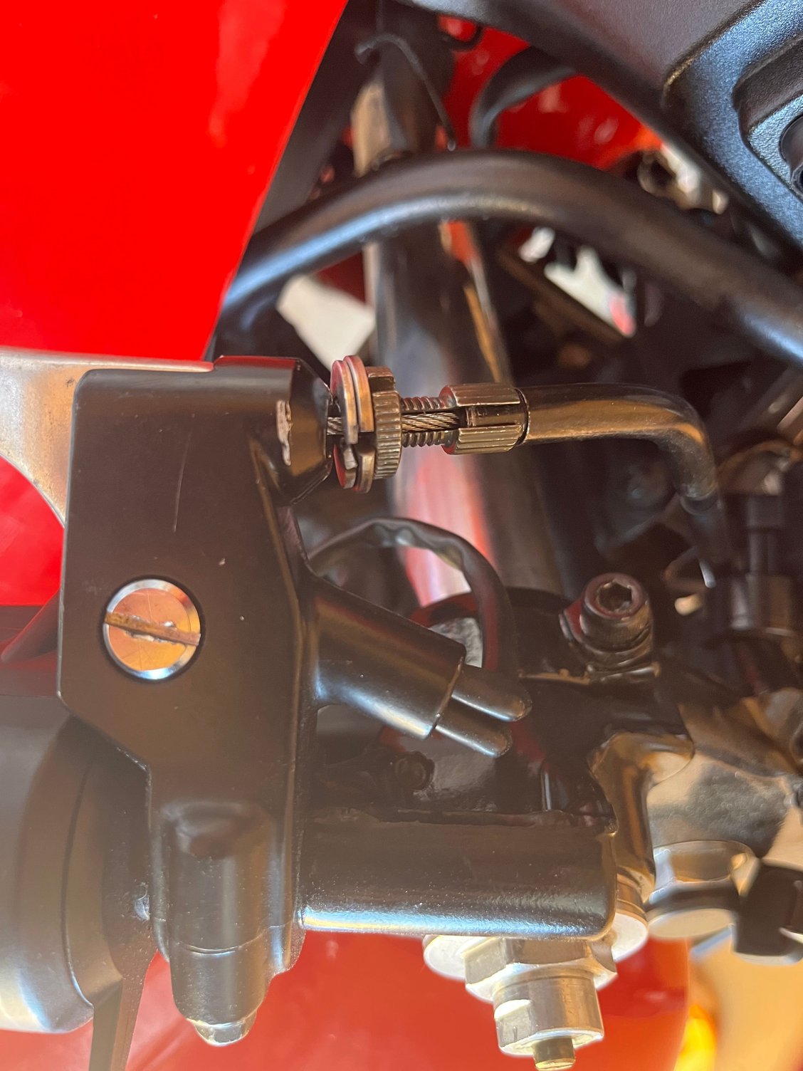

These are photos of mine. They reposted my photo and states the lower adjuster should be further back except then the clutch lever won't grab enough cable tension to pull into a gear. It really seems that everything is adjusted nicely just the adjuster screw is too small for the tighter EBC Clutch Springs and there needs to be more tension.
