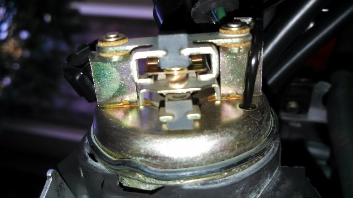

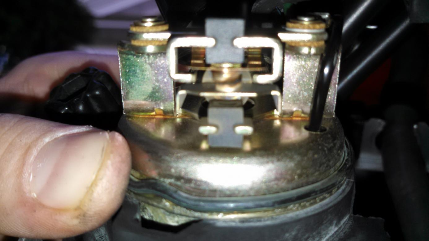

Old Nov 11, 2014 | 05:14 PM
jondecker83's Avatar
Joined: Oct 2011
Posts: 37
From: Jersey
From what I can tell it looks pretty good. Any thoughts?
Old Nov 11, 2014 | 08:21 PM
sjona2011's Avatar
Joined: Oct 2011
Posts: 777
From: Monticello, Indiana
seems ok, but a new contact costs $10-15 and about 10 minutes of your time, so it'd be a good idea to go ahead and replace it
But i would go ahead and check out the carbs, make sure the floats/needles are free and arent getting stuck.
Old Nov 19, 2014 | 05:14 PM
gpfan1's Avatar
Joined: May 2010
Posts: 417
From: Saratoga, California
The shots are kinda fuzzy, but it looks like they are burning on one side. Uneven points and carbon build up can make the points wonky. Especially when hot. If you can run a points file in there you can clean them up. New ones are nice too.
