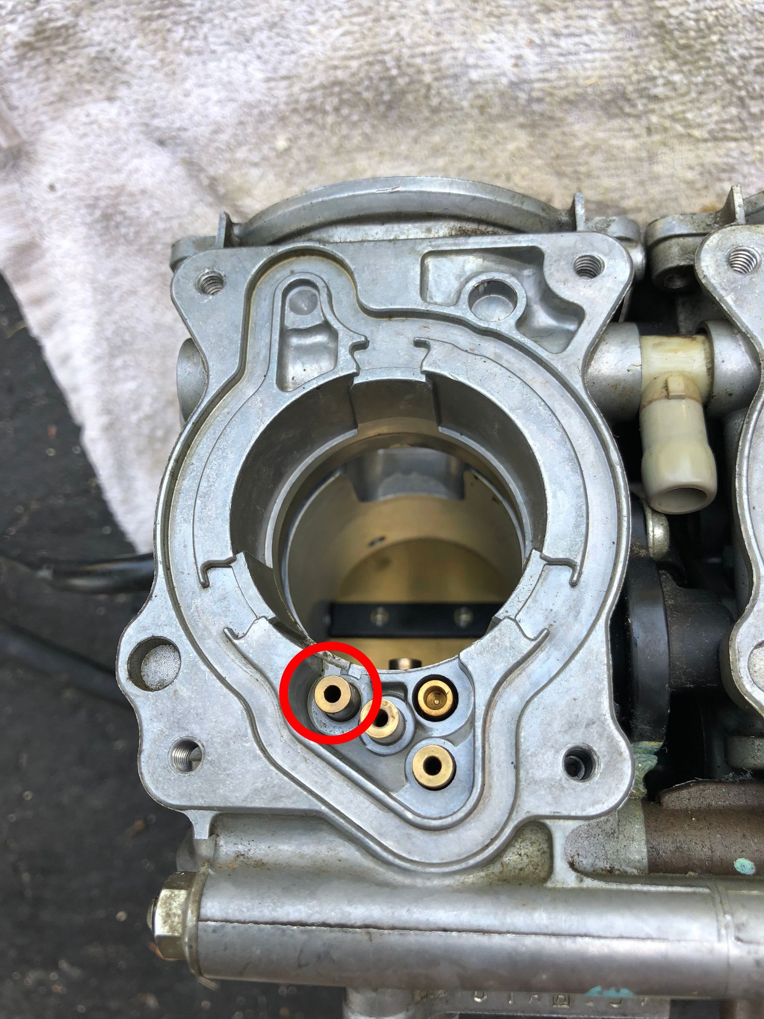

Finished my "re-clean" of the carbs. I did notice 2 jets that weren't completely cleaned out. I went through all the passages as well. Just have a question.
On this pic, I tried to spray carb cleaner through this passage (circled) but it seems sealed. It is the same on all 4 carbs. Is this correct?
And the same on this one (circled)...
Old Aug 13, 2018 | 05:06 PM
Posts: 7,177
That is the fuel pickup tube for the enrichment circuit (choke). It should be clear. You can't remove it though.

Ok. None of them are clear. Suggestion on clearing them? Wire?
Old Aug 13, 2018 | 07:43 PM
Posts: 7,177
Wire and carb cleaner. Also, I don't think this will make a difference but open up one of the enrichment needles and see.if you can get air through it then. Very far chanced but it may be functioning properly and the needle is blocking the passageway. I highly doubt it, but its worth a shot. If not, it's cleaning time.
bpifer15, first thing is excellent photos, really well done. Now, to get the carburetors working properly you're going to have to split them apart and soak the individual bodies with all the other parts removed. I know it sounds scary but it's not really. Before doing so, make some really good observations on the operation of the throttle and butterfly. Notice that when the throttle is closed, the brass butterfly pretty much seals the throat of the carburetor. This would be looking at it from the engine side. Also notice that as you open the throttle, each brass plate butterfly opens the same amount. Operate the throttle while watching it move open and closed. You can also notice that the butterflies are actually kept in sync by springs located between the carburetors where each of the throttle linkages push on each other. The idea after putting it all back together is that for the most part, the brass plates open and close at the same time. If they look like they are, then they are close enough for the engine to start and run. What part of the country are you in?
This is the end you'd be looking in. (disregard the red circle and number)
