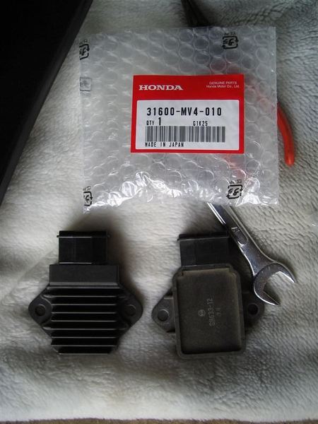

Rick's stuff should be good.
It's extremely rare for a stator to go bad.
Reg/rec go bad if you look at them sideway. Especially the original ones (in pic on right). Often they can take out the battery too.
I've fixed around 20 F2's with 'charging' problems since 91. New battery and new updated Honda reg/rec #31600-MV4-010 fixed all but 1.
Thanks for the part number, I will order it from Honda. Also I will double check my wire harness for any loose connections.
