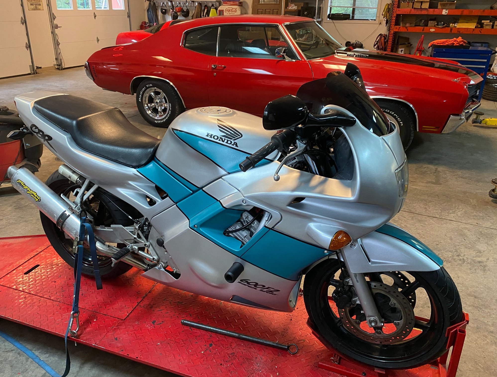

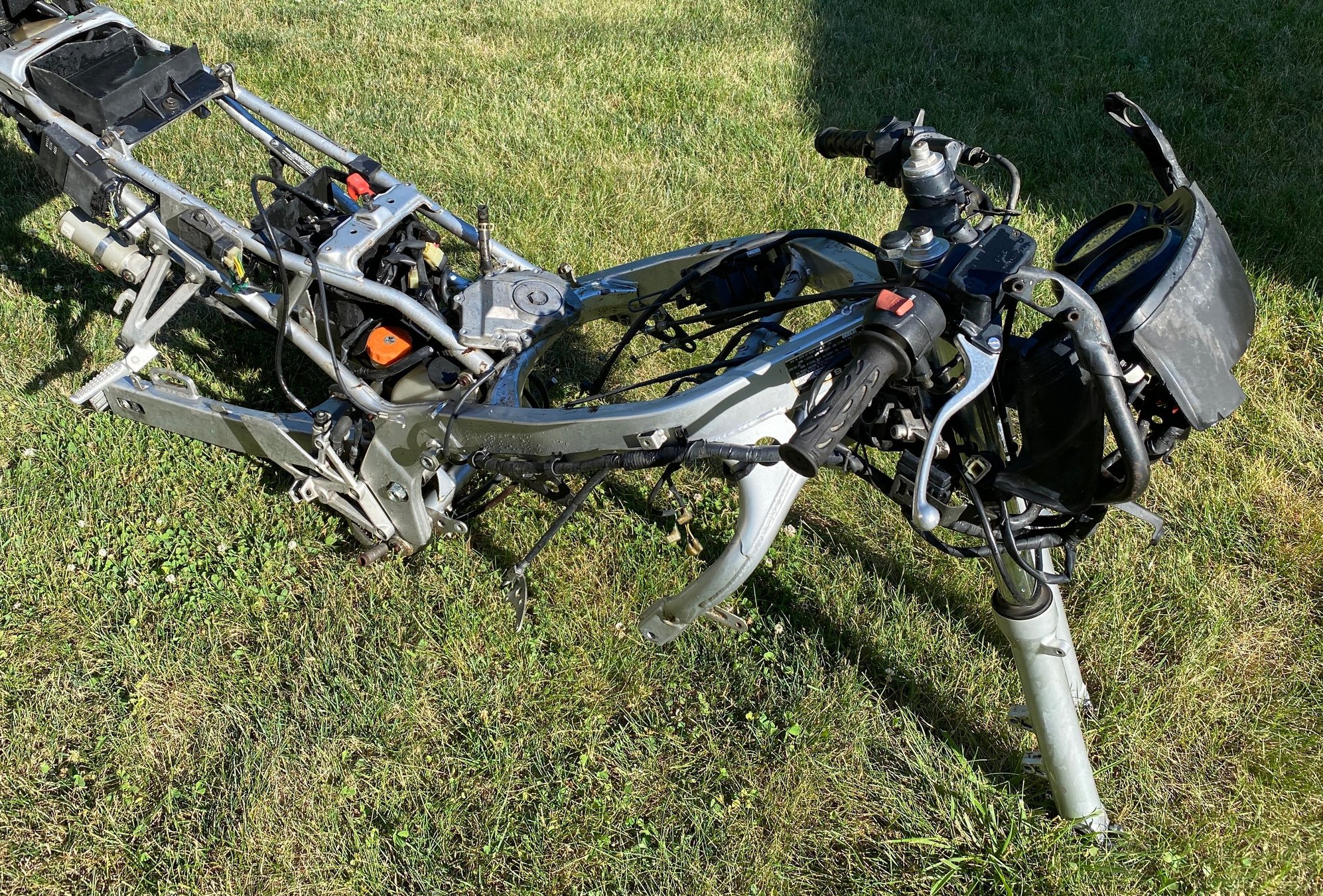

Hi! I’m new here. Have been reading posts for a while, but now I need some recommendations. A few months ago we dragged a ‘93 that had been wrecked then sitting in my dad’s barn for 18 years. We have almost completely rebuilt it. Lots of new parts, but also still lots of cleaned up original parts. We finally got it finished up yesterday. First trip out, it ran great, but bogged down taking off once after a few miles. Second run, bogged down at one take-off again, but otherwise ran great. Longer trip today, after about 20 miles, it decided not to run anymore. It will start and idle fine. It will also rev up high just sitting. When in gear and attempt to move, it will just bog down and die. We haven’t really checked anything yet, I’m just frustrated.

You have done a great job with the resto on the F2 it looks great.
I also have to agree that the tow car and its garage pall are mighty fine indeed
You issues seem related to fuel starvation so could be carb or fuel pump related. Did you get the carbs properly clean?
