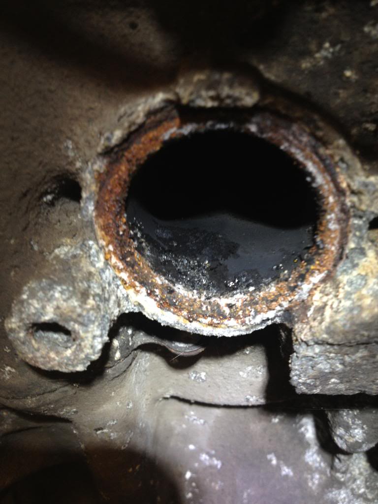

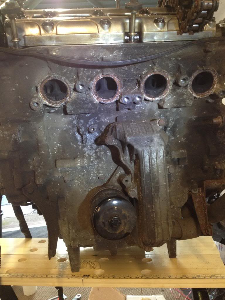

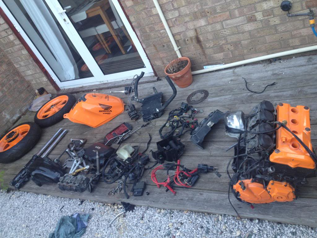

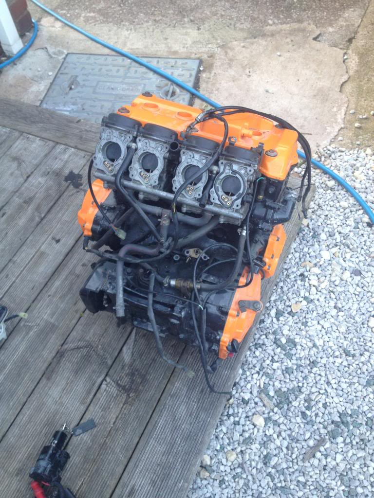

Ok. So. As I hit it with the centre tap before attempting the drill, it pushed the remaining thread through into the engine. So it did drain the oil. But I'm going to have to do a strip down of the engine that I was not planning to do. Eurgh.
Anyway. I've booked the entirety off next week of work as the misses is away all week. So I can have all day and night for six days on the bike. I'm trying to get everything ordered ready now for next week so I can crack on... Is there anything you guys recommend. Someone's already suggested oil seals, which I'm guessing is going to be a must now I'm going to take it apart. But is there anything else, any other seals or gaskets that are worth changing whilst I'm in there?
I have some photos to upload of the engine and what state it's in. As always. If you see anything that needs attention please speak up.

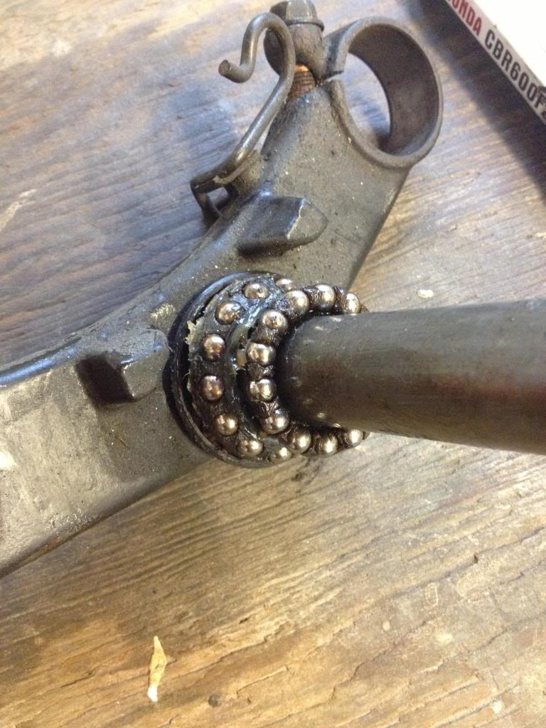

Worth while upgrade?
no use all ***** tapered head bearings made in the USA i did them on my race bike and they take slop out the stearing you dont even notice was there untill changed.

dont bother with a gasket, much cheaper and easier to use a decent gasket goo, we build race motors with goo (blue stuff) and holds well if applied properly.
no need to change any sort of seal just drop the oil pan out retrieve sed piece of bolt then clean the pan if you want to get any loose bits of metal, clean old gasket off and goo the mating surface, reapply oil pan torque the bolts and leave to set.
oh and as for the chunks of metal off the bolts they wont actually cause an issue, drain a bike look at bottom of the oil pan and there is always metal flakes usually off the gearbox with honda's
also whilst you have the cam cover off change the exhaust camshaft for an inlet camshaft (extra bhp) and do the valve clearances

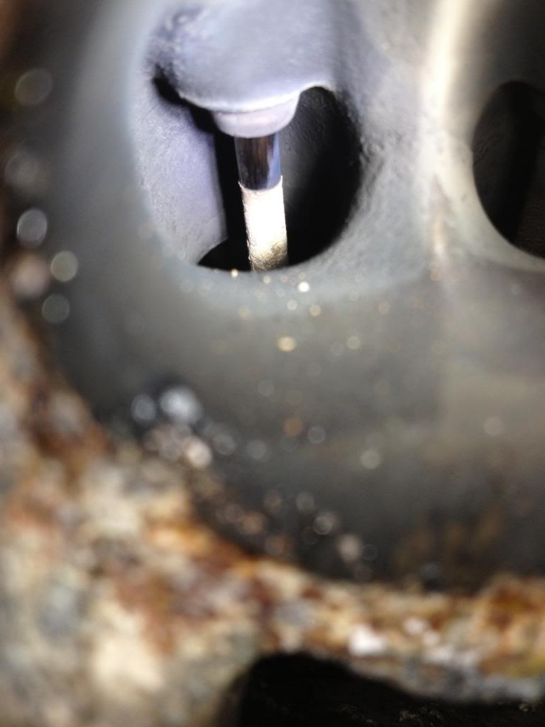

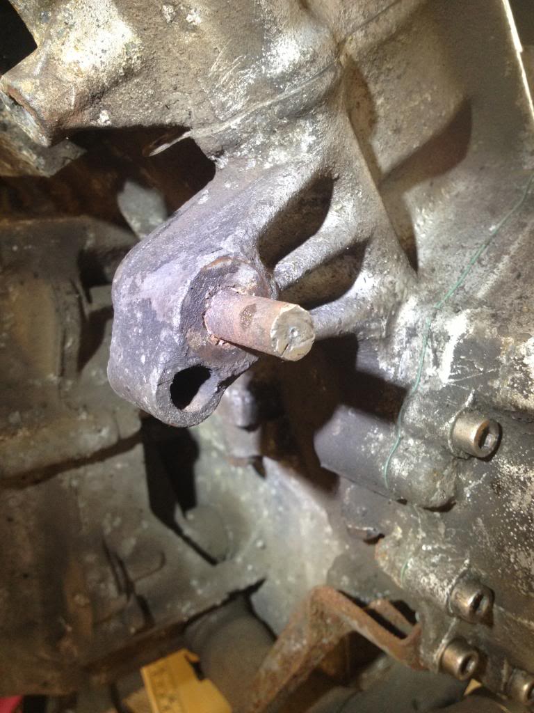

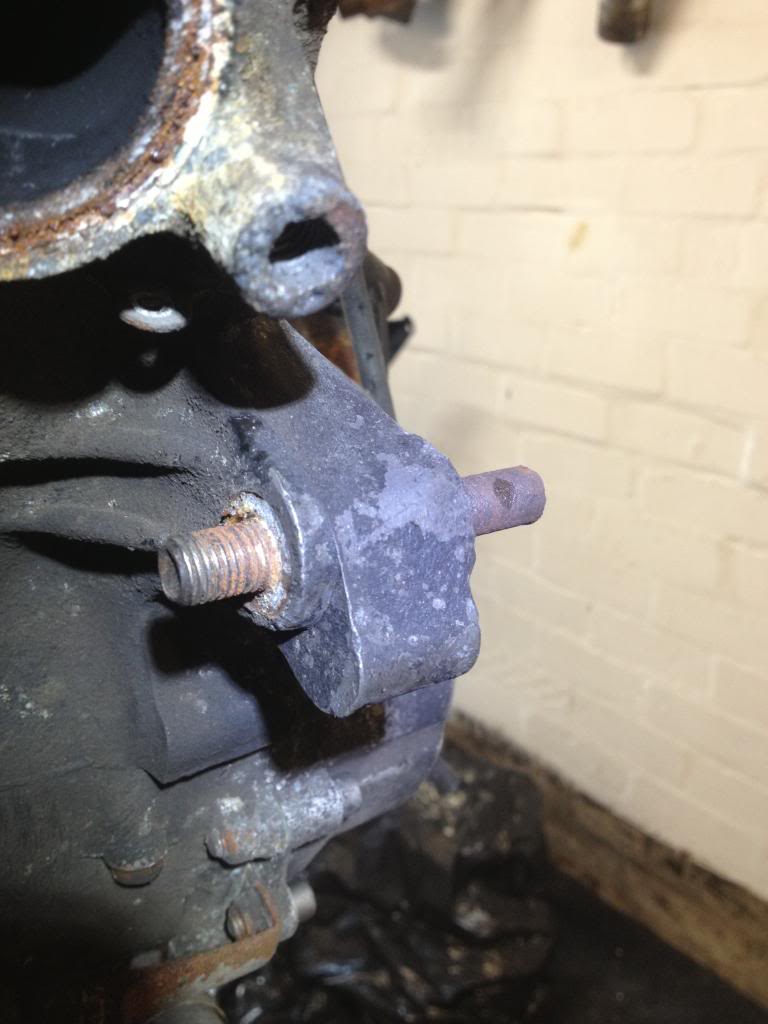

This is an engine mount bolt that snapped as well... ive tried drilling it with some HSS Metal drill bits but it wont make a mark it.... any advice....

Like Jackojeff said, it's simple enough to drop the oil pan and to get the bolt thread out and while you are there you'll get to see if any metal from your alternator issue is in there so it's win win.
It's probably a good idea to check the new drain plug bolt fits in the cover ok before you put everything back, just in case there's an issue with the threads on the case.

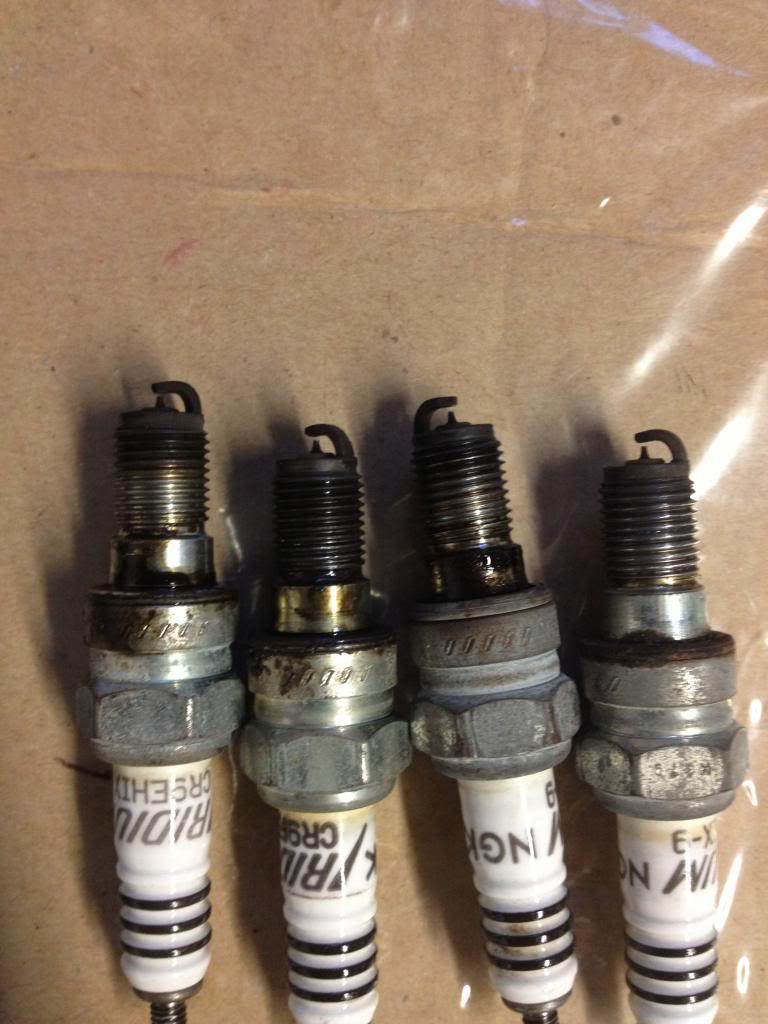

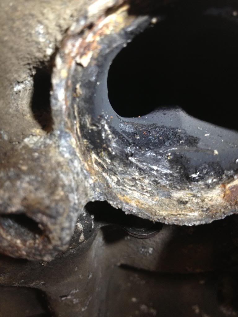

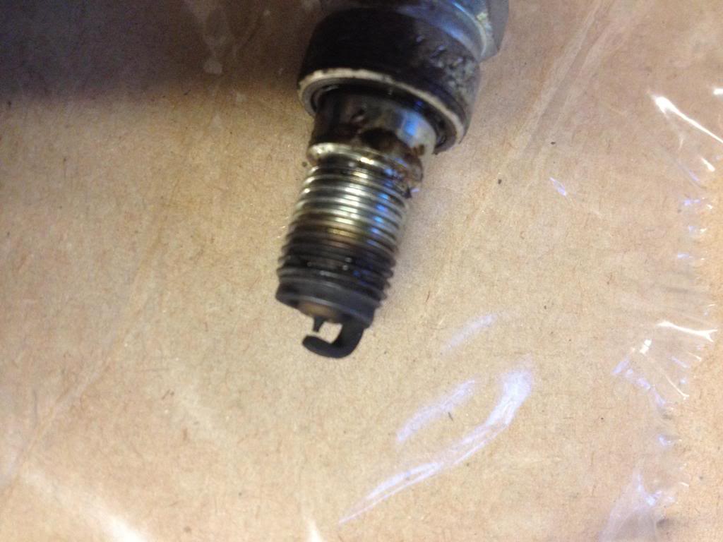

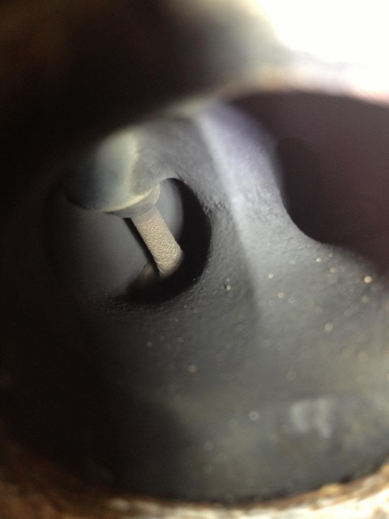

your running really rich and i wish i had a picture of my new head to show the difference all that build up is going to sap the bhp from your bike it needs cleaning off, a gas flow by a professional may be a good route to follow. im based in Cheshire and if your in the area i can send you a few contacts as far as dyno work and engine work go i spent 6 months finding people who are good at what they do and charge surprisingly the least .
as for the stuck engine mount bolt-
soak in penetrating spray wd40 isnt technically penetrating but should help lots and lots over a few days
you can then file the circular part of the bolt to flat on 2 sides allowing a set of big mole grips to get a strong grip of the bolt and hit said mole grips with a hammer this should 'crack' the bolt and make it spin out
reminds me of my build but loads less grime involved in mine and i did it in 3 weeks
oh and have a look at soda blasting might be worth a try for that grot stuck on your soon to be pride and joy

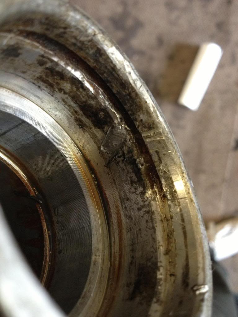

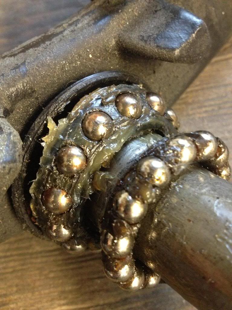

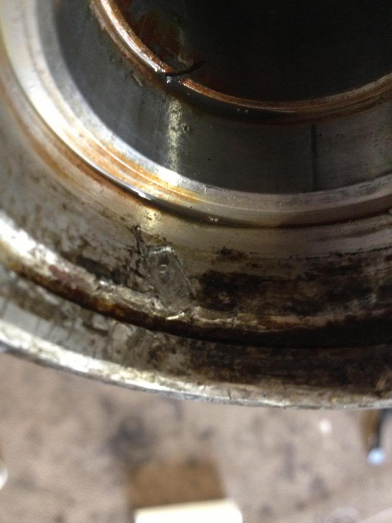

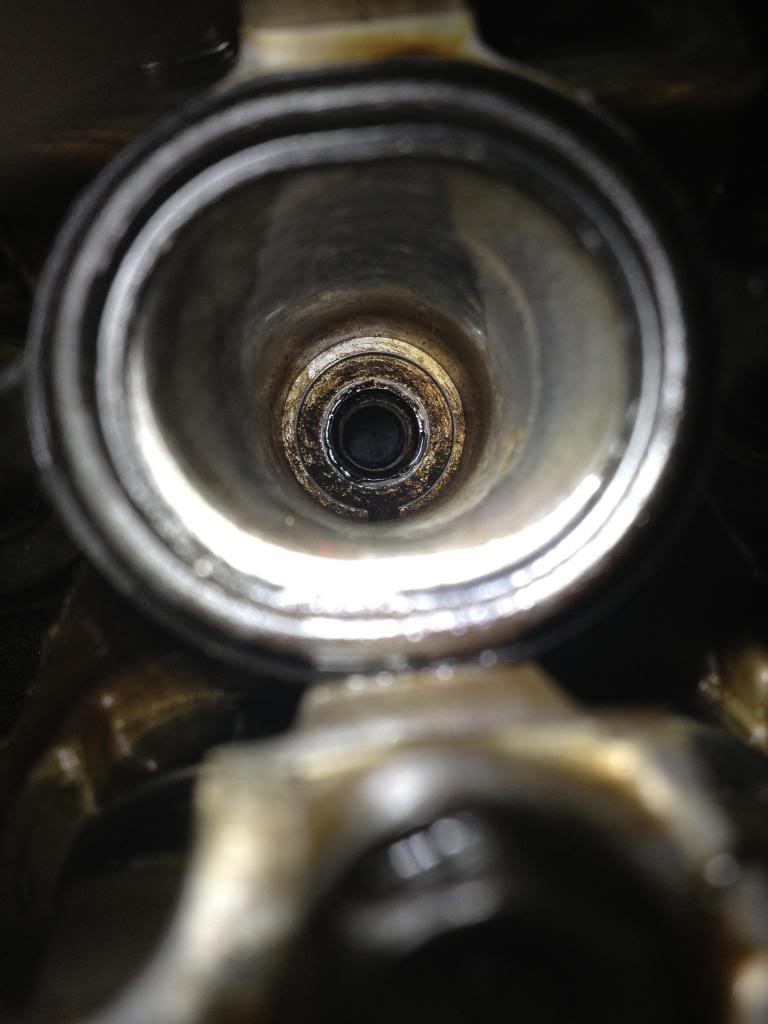

first off, can anyone tell me, do these bearings look ok, or shall i just replace them??
This looks abit dodgy??

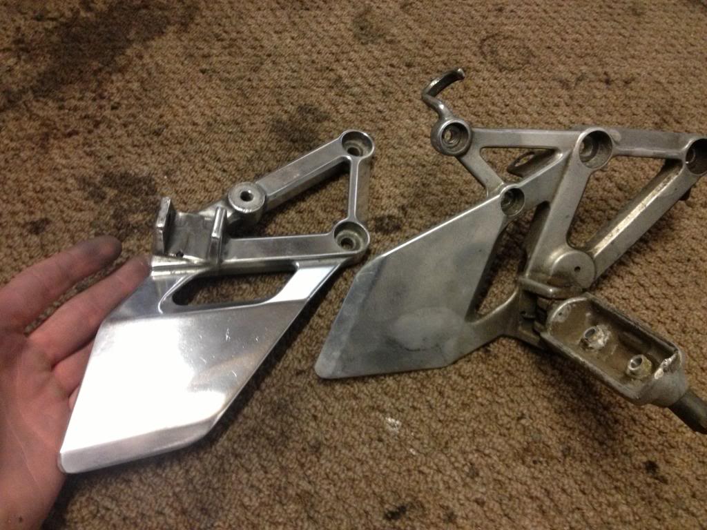

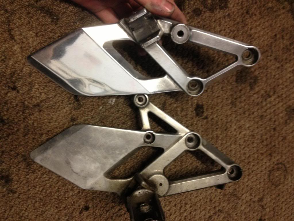

Started polishing the metal parts up should look nice next to the gloss black frame

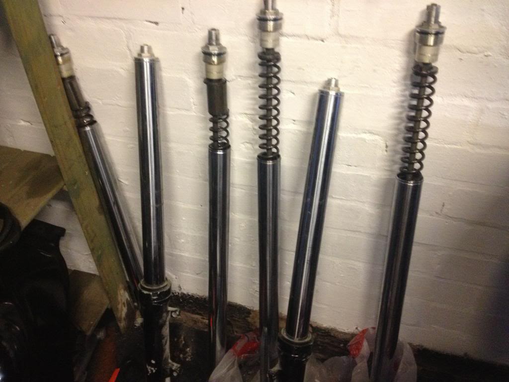

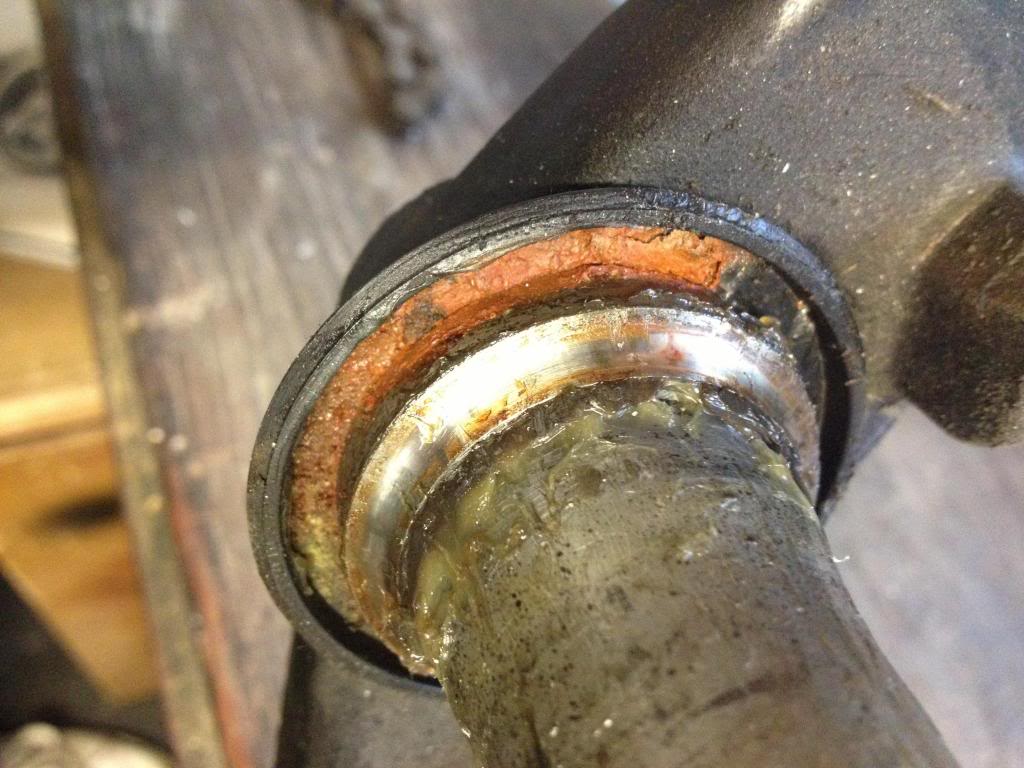

Took apart my other set of forks today, to see this. No wonder it was leaking oil.
Im assuming its ruined?
seems whoever went in there before me used a flat headed screw driver to get the seals out.

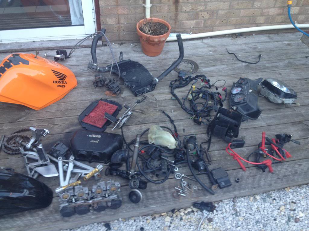

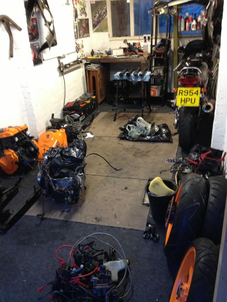

I, have bagged a bargain! Praise the lord for ebay.
All this, for £100 or, $154 in todays market.

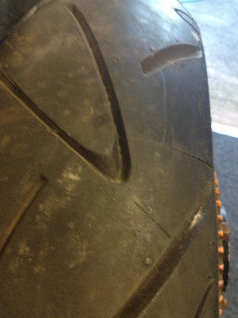

Brand new tyres
I think ive got enough sets of forks now!

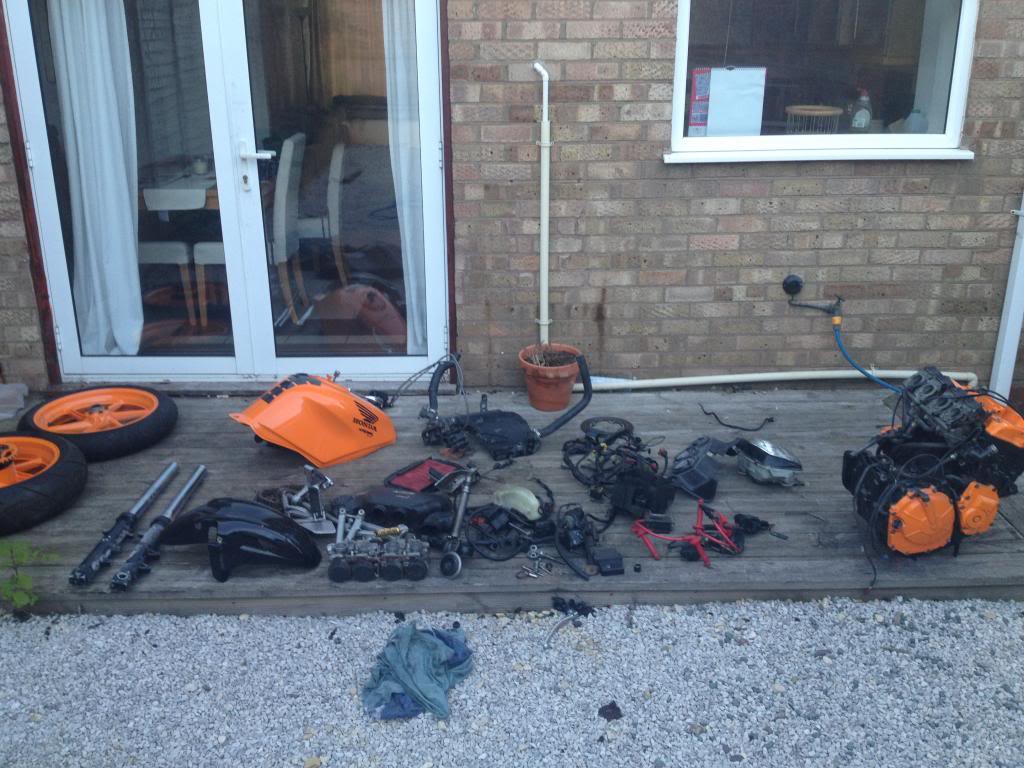

My garage has offically turned into a honda cbr F2/F3 spares shop.
