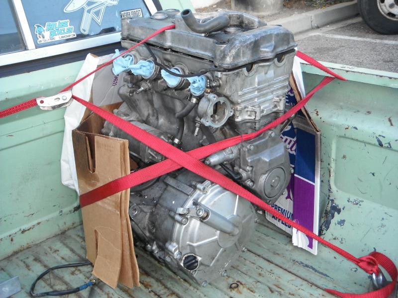

picked up another motor from an f3 for dirt cheap and came with a couple water pumps and a rear fiberglass single seat body piece, it has a bad headgasket so I can use the lower parts like the stator cover and stator parts...

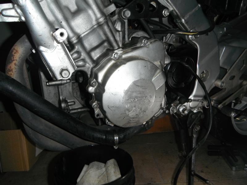

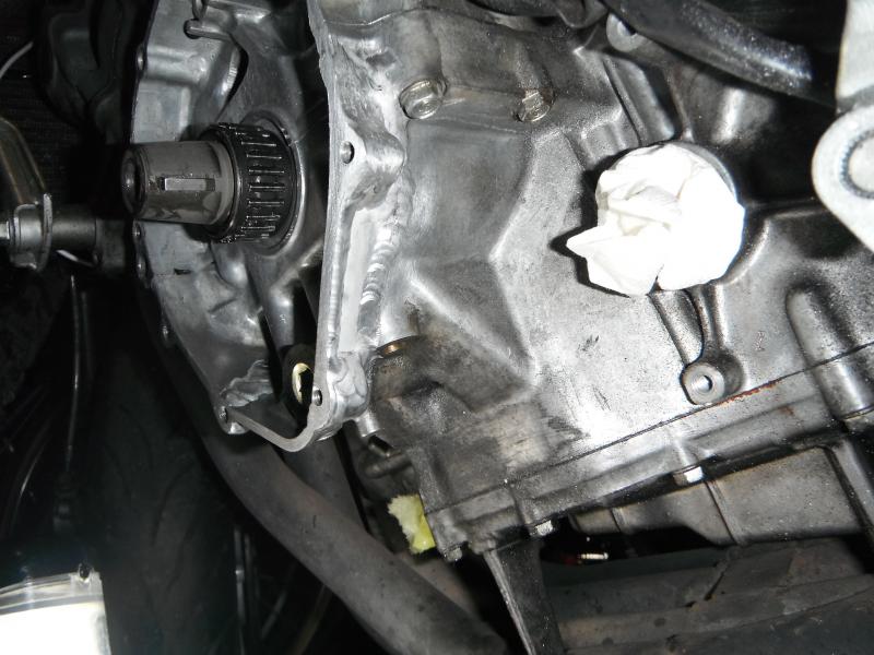

so heres the deal, and I please need some good technical advice here...
got the stator cover, flywheel and stator from the f3 motor into the f2, but the chipped off edge on the case is still leaking oil even after I sealed the heck outa it with grey sealant
should I pull the motor and have the chip fixed?
Or should I get the head done on the f3 motor (blown head gasket)and drop that in with my f2 everything else, would that even work?

chip on the edge of the case is wider than I thought...

Yeah, that is definitely not a chip!! You're missing a significant bit of metal there!!
I was going to ask what this grey sealant was, and recommend JB Weld, but that isn't going to be fixed with anything like that.
Honestly, I don't know if a good aluminum welder could repair that - a VERY good one probably could, but the cost would likely not be worth it, and it would probably be cheaper to replace the motor.
You've already got the F3 motor, which is a viable option, but you'll need at least the F3 airbox and wiring harness as well, and there may also be other considerations, so I would just do some searching on projects of the same sort... it's been done plenty of times before.

Yeah that's not gonna be fixed with any sealants, even if it would be welded you'd need the missing part. And it would need to be sanded or grinded straight to ensure proper sealing. You either are gonna have to change the engine cover or swap the whole lump...

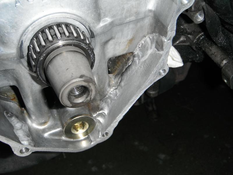

got the bike back last week after getting the case repaired...
stator cover on and fluids filled, bike runs good with no leaks, carbs seem to be boggy so I might have to check the jets and make sure they are clear...
pics of the repair:
from inside he even fixed a crack on one of the bolt holes

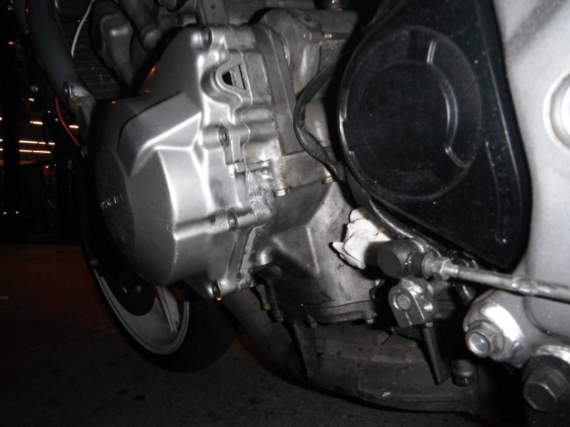

stator cover in place, matches up nicely, once I bolted it up I used some sealant on both side of the gasket..

Nice job! One of the cleanest alu weld seams I`ve seen, that guy definitely knew what he was doing! Nice to see you got it sorted!

The aluminum repair looks really good... how much did that set you back?

$250, yea Puccio (Pu-Gio) here in SJ does awesome work, its just one guy and it was his dad before him
