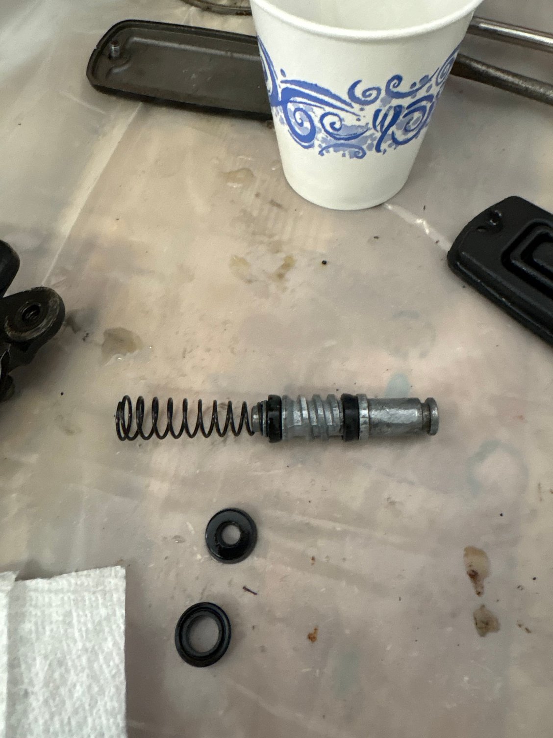

I checked for air bubbles again. None that I could find. To the master soar again. So put together correct. Although, when you push the piston in no fluid comes out. So now nothing is happening. I tried several times on the old master and the eBay salvage yard one. Same results.
So in my head it’s time for a brand new master or I got a bum rebuild kit.
Old Oct 14, 2025 | 01:56 PM
Ed Harris's Avatar
Joined: Jul 2023
Posts: 471
Likes: 126
From: UK,East Midlands
I’m with Rockpool on this one, I’d put my money on the seals being the wrong way round.
Old Oct 14, 2025 | 04:21 PM
bhchefyoder's Avatar
Joined: Aug 2016
Posts: 14
Like this ?
