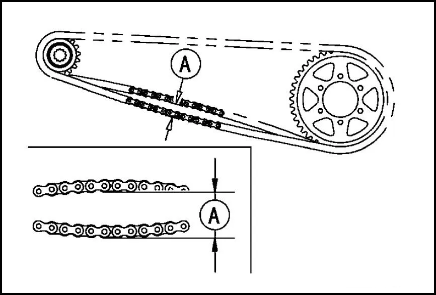

Hi Phil , thanks for the figs
When you say 15cm - 25cm i take it this is where you do the old sum of pushing chain up to swing arm & measure from swing arm down to chain & make note of the fig (A) & then pull chain down away from swing arm & take second measurement from swing arm down to chain (B)
Then B-A should = 15-25
would i be correct.
sorry to be a pain
Alan
PS - thanks for the other replies also. This info really does help

Not a problem. You've got it right. Here's a pic.
Wow Phil, an artist aswell as a font of knowledge. I have captured the pic & added text. Printed off & adding to my folder
