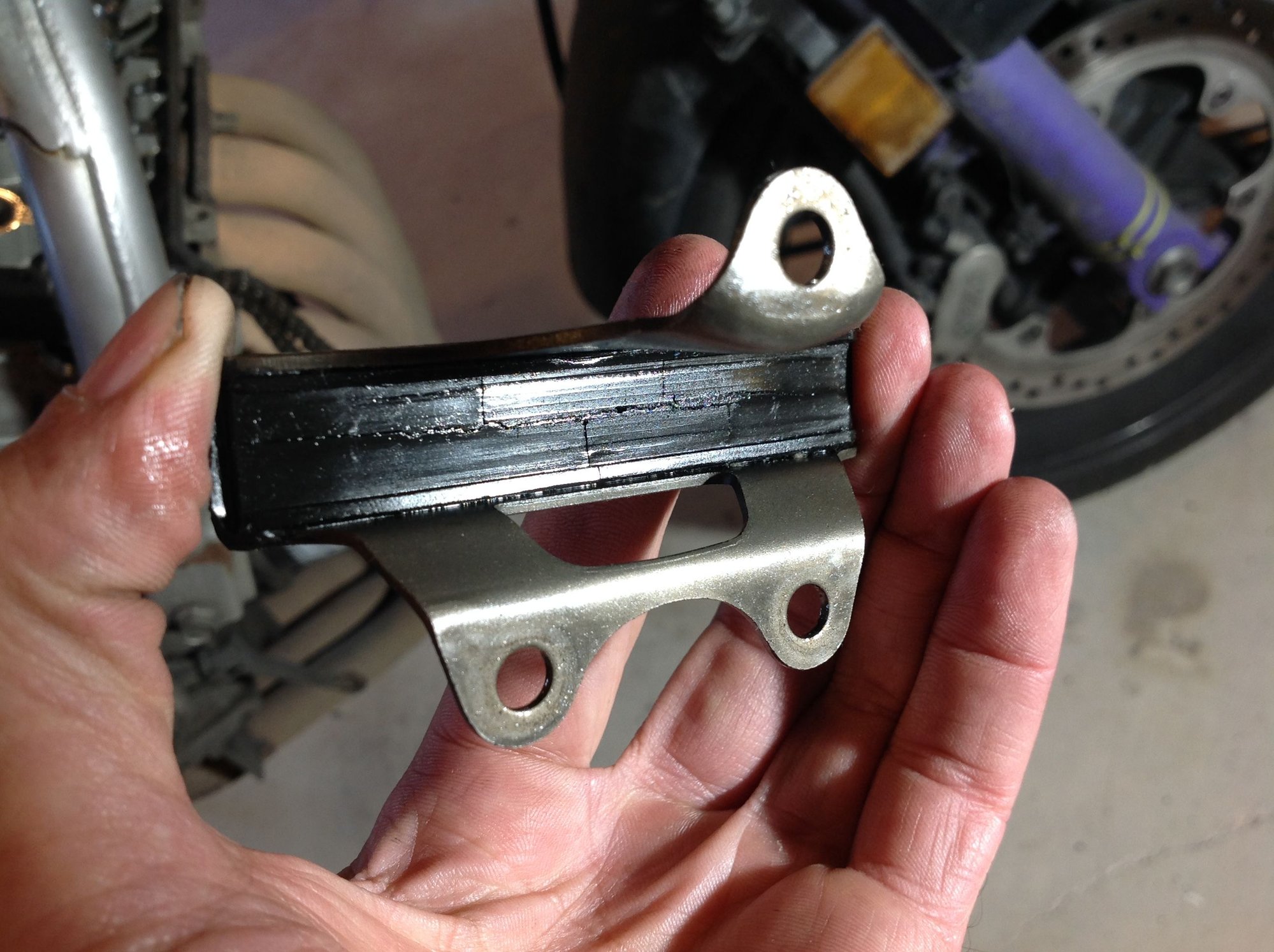

Here's the guides out of my high mileage bike when I replaced them.

Oh ok that makes more sense and wow id say they were a little worn lol. Well i guess until i get that ape manual tensioner i wont know for sure but i do appreciate the help. Ill be ordering that soon and ill update then. Hopefully she lasts in the meantime lol
