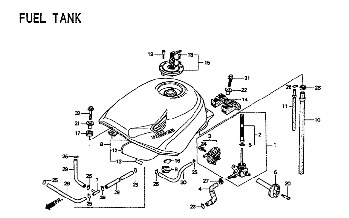

First of all does anyone know if there is anything that is supposed to be between the petcock and the carbs? Such as a fuel filter or a pump or something. The only time I saw under the tank was after they had stolen the tank and whatever else I am not sure. Secondly is there something I should be doing as it sat all winter in storage to make sure fuel is running right or anything like that. I don’t have a lot of experience wrenching on a bike.

You will always want a fuel filter between the petcock and the carbs, so you should definitely install one or else debris might get into the carbs and cause havoc
I'd check to make sure you didn't miss a vacuum leak. I'm guessing the thieves didn't remove it nicely, so they might have cut or ripped one of the little vacuum/vent hoses out. I'm not sure if the petcock is supposed to have a vacuum hose (30) or if that's just a california thing, but check to make sure that everything's been connected, and that there's no cracks or gaping holes in the intake system

it does have a vacum petcock. if that is not attached you have found your vac leak
