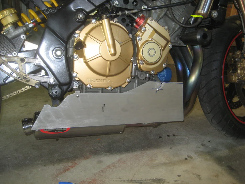

looks good bro imo though you should round off the front edge of the shroud (by the headers) on both sides so they flow with the 90 degree bend of the header and leave the back one pointy...
but ur call

haha... these are just the cardboard ones too... they will be fine tuned. i cut out aluminum sheet to finalize the shape. (like what you are talking about) and to get the brackets figured out. once i do that i will make the final parts of the honeycomb. (mmmm delicious!)

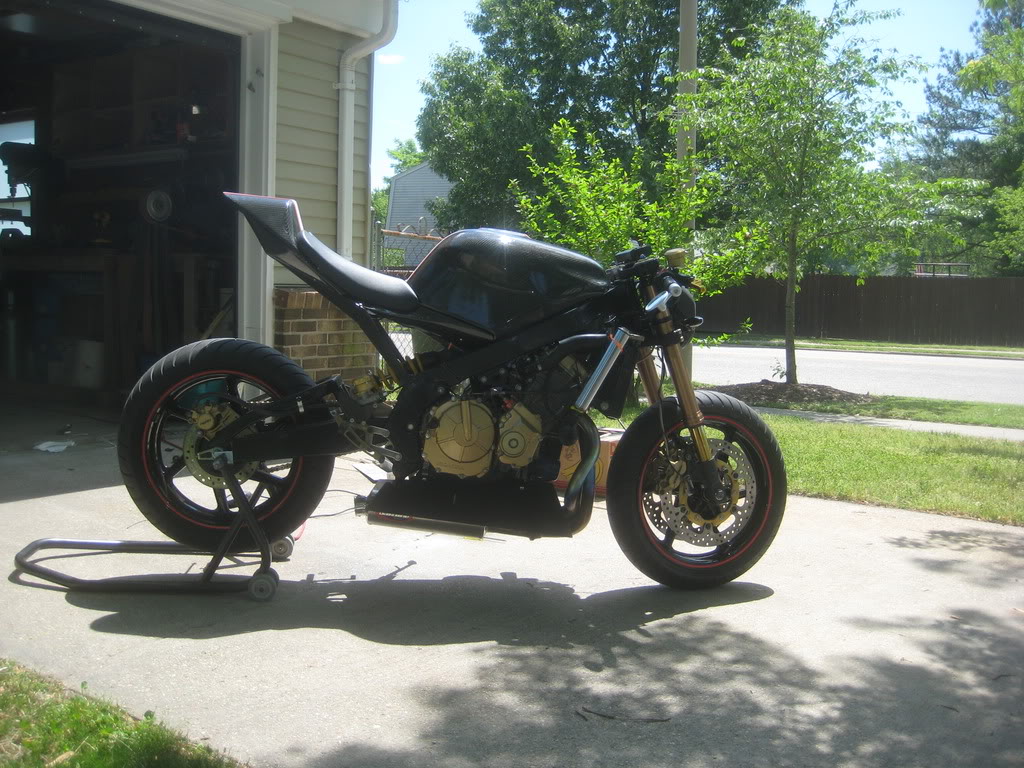

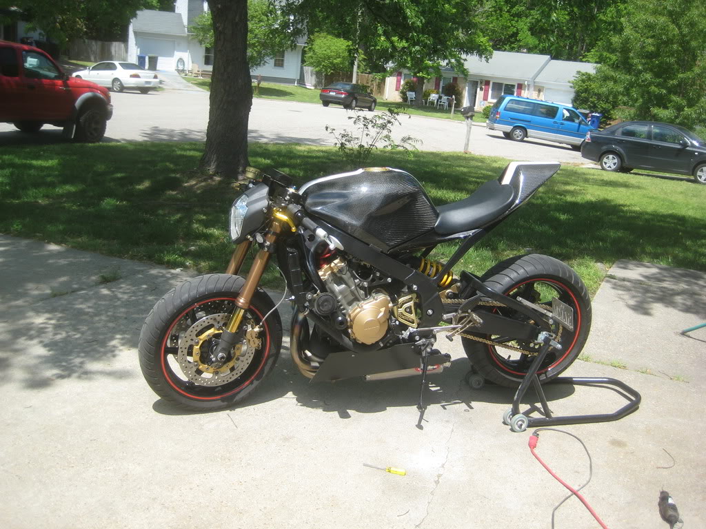

did some work.
mocked up the shrouds. mostly figuring out the mounting before i do anything else.
but then i had to flat-black them.
finalizing shape and material...

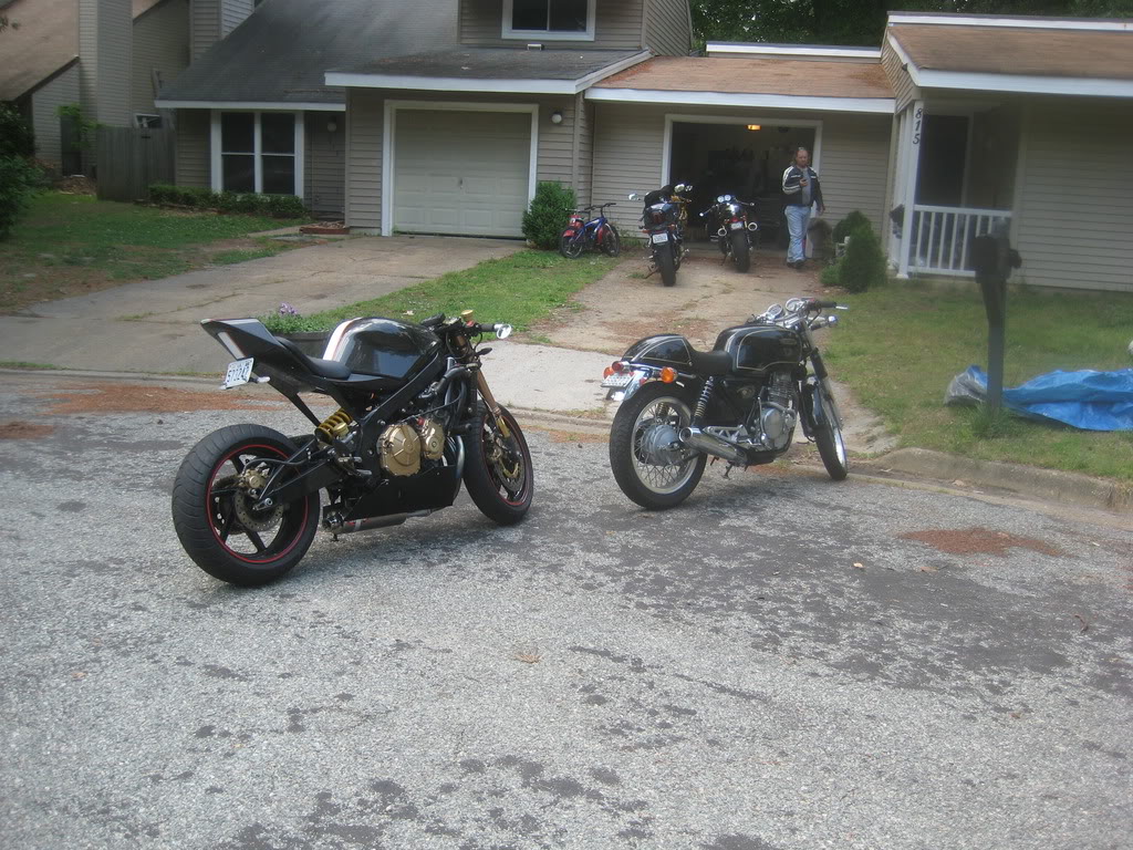

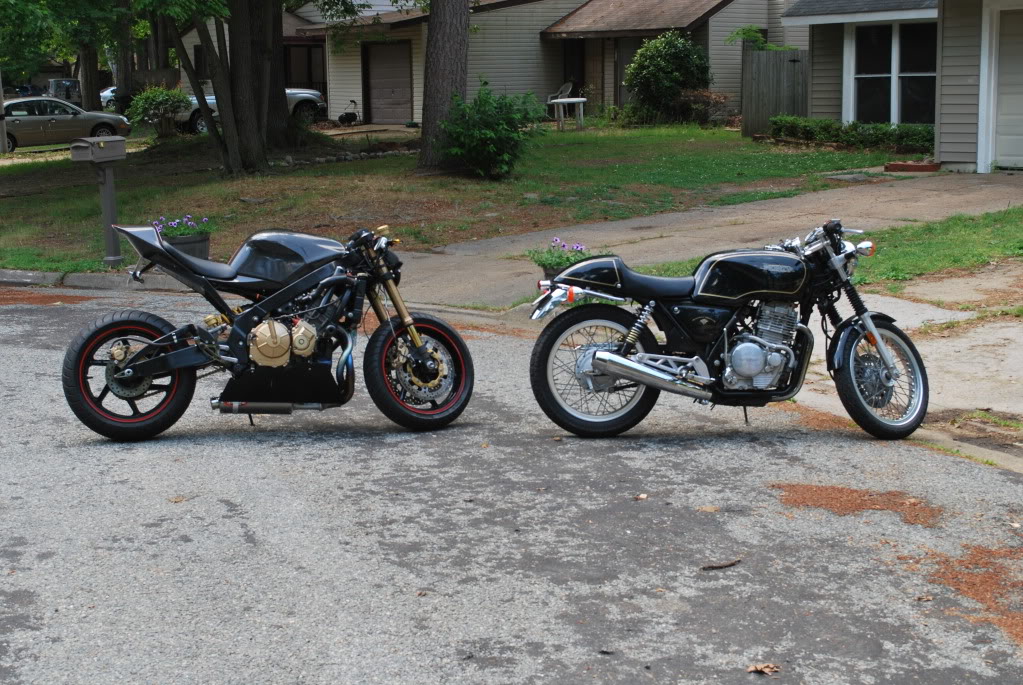

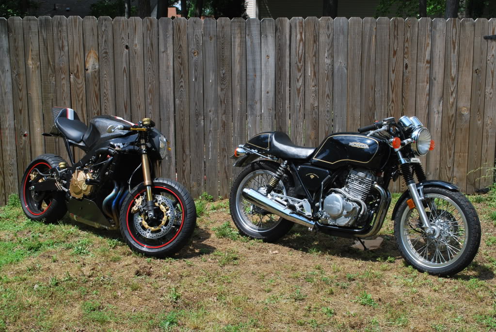

took it to a local meet/maintainance day with all my SV buddies. got to rub shoulders with a honda gb 500. and got some "old vs. new" pics. can you tell which was taken with my dying point and shoot, and which were with the new digital SLR?

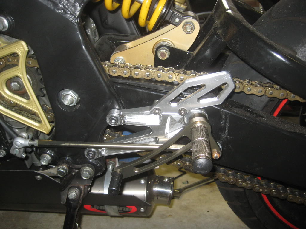

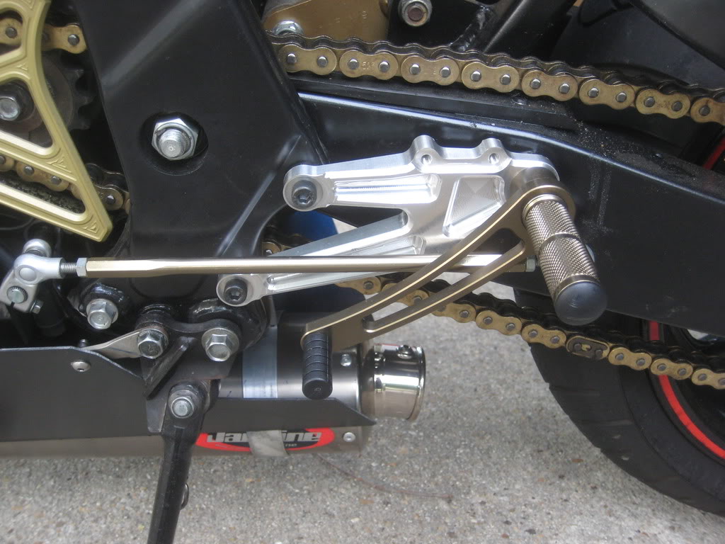

I started on some new rearsets. designed them or i could replace the existing rearsets one component at a time. levers next, then pegs
