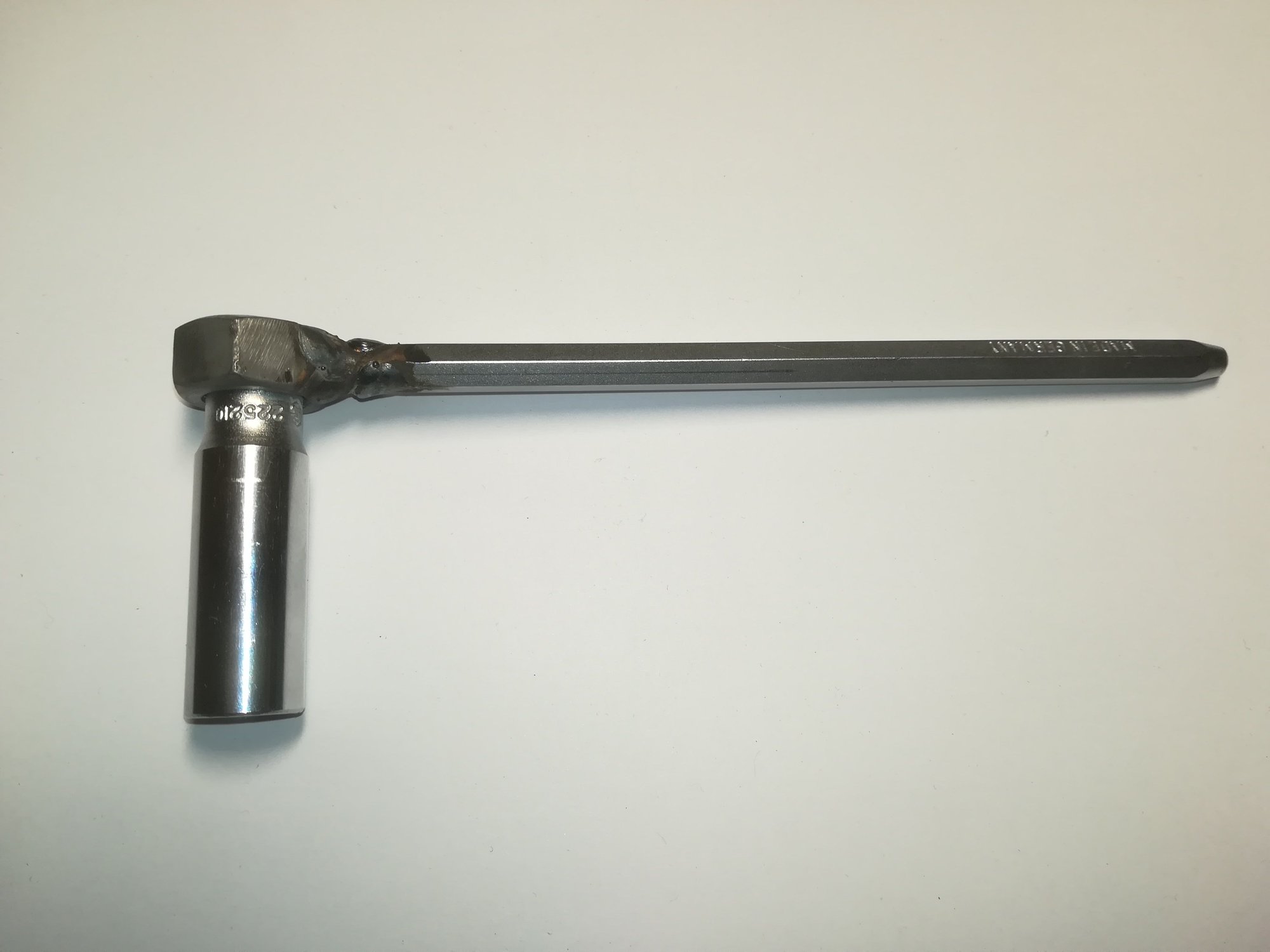

Old Jul 19, 2019 | 12:57 PM
joco812's Avatar
Joined: Dec 2018
My Valve Adjustment Tool (1/4 socket + nut)
