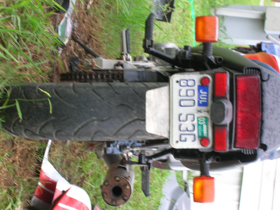

I have an 89 cbr600f. I needed a new rear tire. I have a michellin macadam 11/80-17 up front(stock size). I bought the Michellin Road Pilot(bias) in a 150/70-17 after checking with this forum. my reasoning-
the bike has a 3.5" wide rim on the rear, which can comfortably hold up to a 150 tire. while a 160 will fit clearance-wise, you change the dynamics of the handling because it is pinched, it won't corner the same. I was going to go with a 140/80 but after some calculations I found that the 150/70 is closer to the same overall diameter as the stock 130/80. matching the two second numbers isn't necessary, that's nonsense. the 2nd number is just the percentage of the width that equals the heighth. aspect ratio, right. so 80% of 130 is the heighth of a 130/80. keeping the rear wheel as close to the same height as the stock one will preserve stock geometery and keep your handling the same.
if you got a slightly larger than stock(total diameter) front tire then you would want to try to do the same for the back. how do you figure out the total diameter? and what if you want to do something crazy like use different width rims?
I have a great .xml chart that figures it out for you from a buddy over at the Honda SOHC-4 site where I spend most of my net time. it is on a list of resources as well as lots of stuff to help you do front end swaps and brake upgrades, etc. you just plug in the size of the tires,rims front and rear you want to use and it will tell you everything you need to know to compare the diff to stock. here's a link

I have been running a 150 rear since I bought my back and it handles fine.
I know the different characteristics of a radial vs bias carcas.
My ? is this. as long as the profile of the tire is "forgiving" meaning not pointy in the center, why couldn't we run a 150 radial?
I am looking at a set of pilot power's but haven't found an answer on how radials run on these bikes.

Heres what im running and for a newbie i dont have ANY chicken lines lol. I am smart about it though.
120/70/17 Metzeler Steel Radial MEZ4 front
150/70/17 metzeler steel radial MEZ4 rear
Hope these are good but they do have serious crowning issuse

After looking the mez4 has a straight sidewall, whereas the pilot's and battleax's have a sidewall that comes in more.
Can you post a picture of your front and rear?
I don't get crazy on the ole cane but I do like playing in the twisties and the previous owner put on avon roadrider's which suck. They don't heat up at all and have a crappy profile. At my best lean they still have 1inch or bigger chicken strips.
Not to mention that because of the hard compound and not heating up they feel pretty squirrely when you get over on them.
