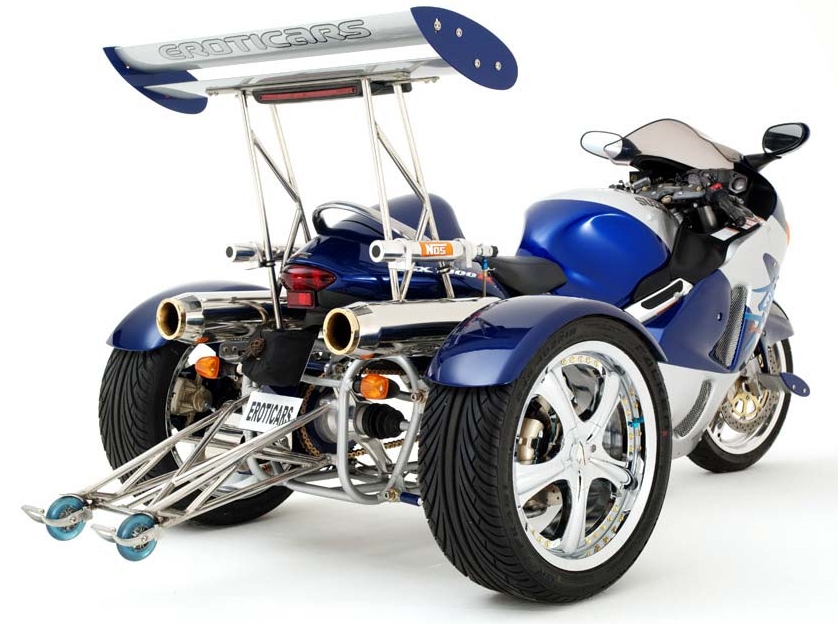

This will probably be controversial but I decided to make it into a trike. In doing some research there isn't much out there on triking a sport bike...but there are some that have been done. The easiest way to do this is to use the back end from a Quad. I'm thinking something like this.
I did some research and found that many Quads have swing arms that are a very easy fit. I found this 2004 Yamaha Raptor with a blown engine and picked it up for a good price. It has an aftermarket extended swing arm, 3" wheel spacers and a bunch of other parts needed for the trike conversion.

You won't hear why from me. Have at it. I was at a Chip Foose show a while back and MMI brought a Triumph Rocket III with them. Then they had a quad that had an R6 engine in it geared to do 150 mph.
You have 3 bikes, they don't all have to be practical. A suggestion, don't use spinners or big chrome rims like that gixxer has

For sure want some better wheels. There are better choices for the 4 bolt hubs, or I could do some adapters to go to 5 bolt and open it up. Would like more offset and deeper look than those two examples. I also want some fenders to make it look more finished.
