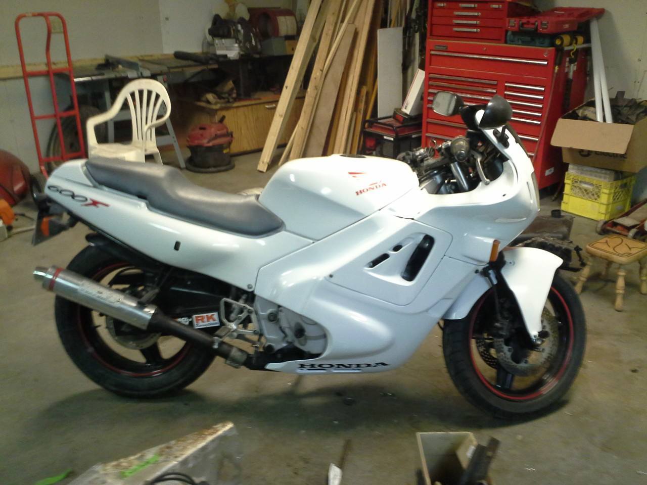

Got it! Rides great and is exactly what I wanted.
Now, as far as the quirks. The ticking on the low end is there, but I'll keep an eye out for changing the tensioner soon.
The frame has a crack in it, but it's not all the way thru. Can probably gauge and weld it.
Now, I think the voltage regulator or stator has ate it. The bike needs a constant charge every night to get thru the day, and when we put a multimeter on it, it was hovering around 12.5v at idle, and when I gave it a slight rev it bumped up to 12.7. I had the battery completely die today and put a new one in....and 5 hours later it died as well. I'm hoping it's the regulator, at least.
Congrats on your new bike. I have an 89 just across the border from you, still working out some bugs as it sat for ten years, but they are fun to ride. I bought one new in 1989 and had a blast on it for several years before my little brother totaled it.
Generally a good idea to replace as a set. Stator starts to go, low voltage, regulator working harder to keep up; and vice versa.
The voltage regulators are a known problem on these bikes . I replaced mine and have had no problems since. Check the electrical connections for it as well as they get loose / worn over time. It will be obvious if your problem lies there.
