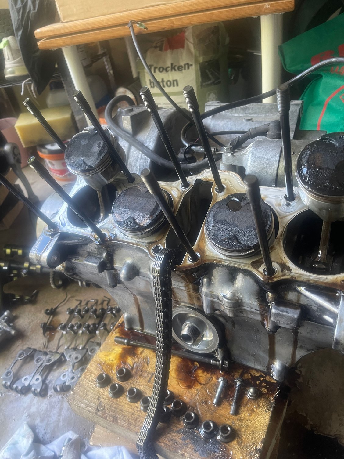

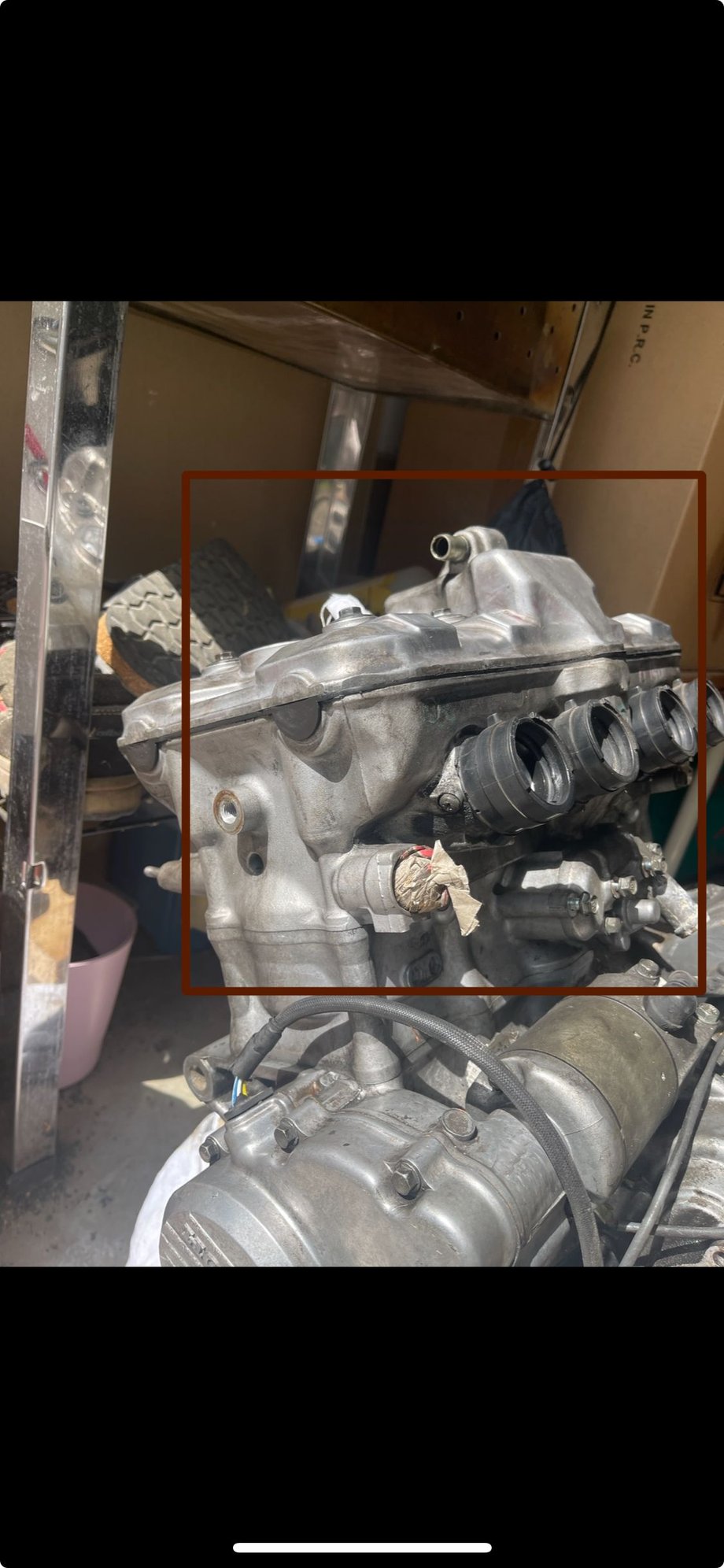

Is it possible to take this off and swap with the other so that the cylinders are good? How difficult is that to do?

You’ve highlighted the head with the valves, the cylinders are the section below that but regardless, if the cylinders are in good condition then it will be easy to swap but you must take the pistons too (and keep the pistons in the same bores they came out of).

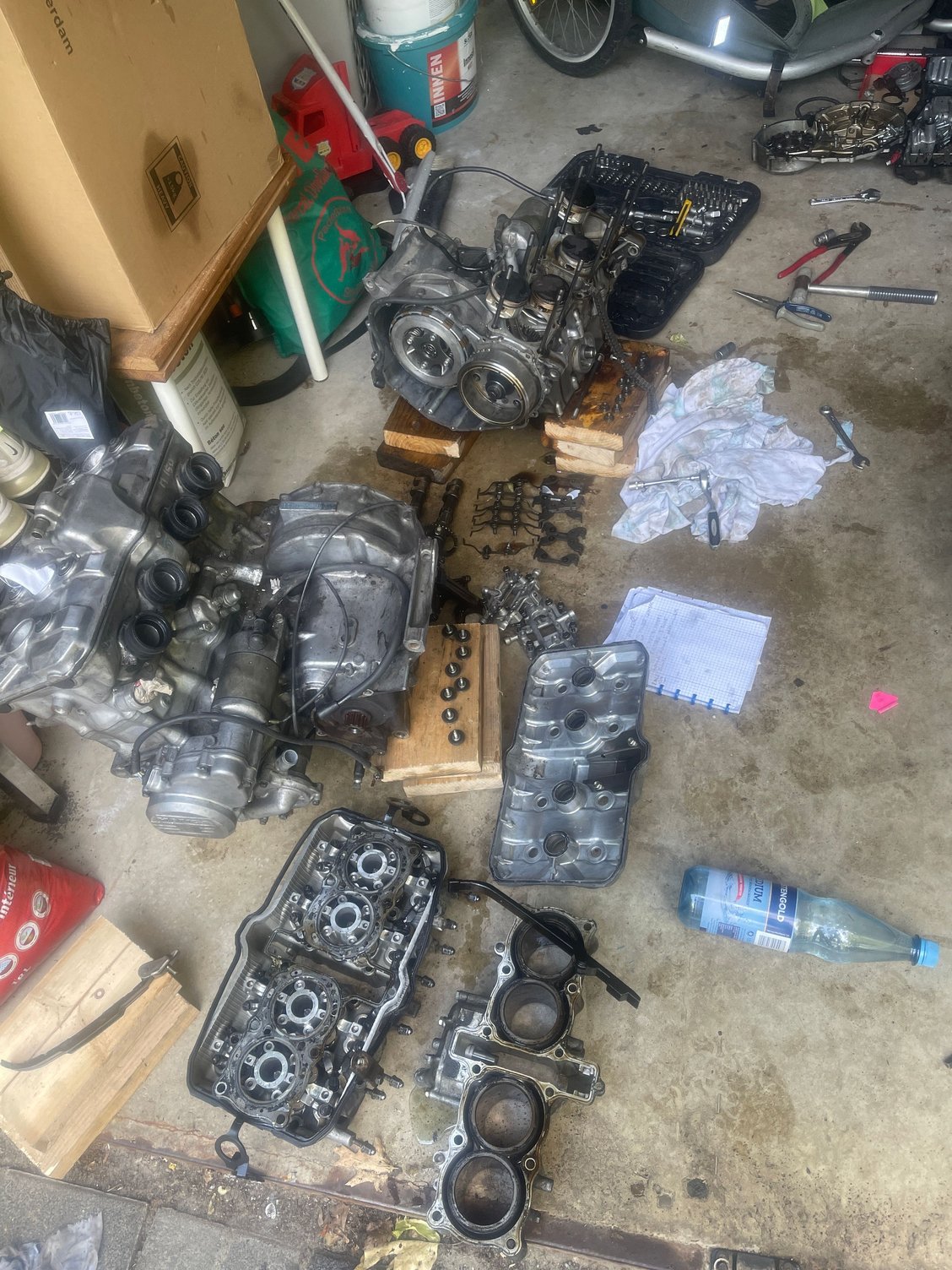

Cheers Dan , so the oil pump sprocket I didn’t torque and that’s what basically came lose and ripped up the teeth and then seized the engine I don’t know what other damage was caused so basically what I’m doing is transferring all the good stuff from the bad engine to the good engine
saying that the good engine looks like it’s never had an oil change thick Nutella inside , I’ve removed the sump and had it sitting over night and got my hand in with a rag and cleaned as much gunk out of it

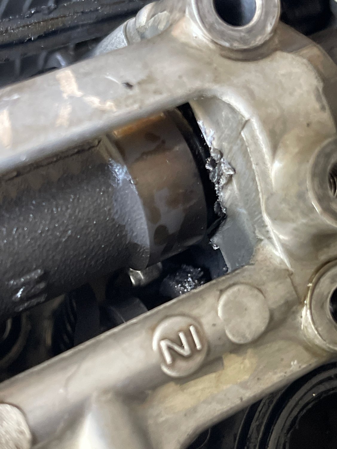

I’ve now got the rocker cover off of the bad engine and straight away I can see some churned up metal by the valves I’ll drop a picture below,
what I was thinking is if I take the top end out of the bad one and put in to the good one because there s a bit of rust on the good ones
if you can get your head around that lol

So in the old engine when I crank it it’s gurgling and you can feel and here the compression as the wheels is turning however on the new engine when I crank it it just turns I can’t feel any compression or hear any gurgling what could this mean? That it has no compression?

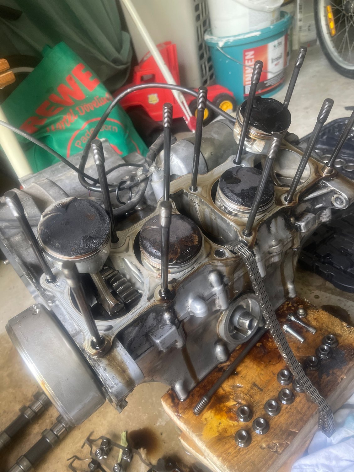

So without carrying out a compression test , cranking the new engine it just span and there was no air or gurgling etc when I rotate it, that leads me to believe that air must be getting past the pistons , so what I’m thinking is if I get the new engine top all stripped and remove the piston heads but don’t touch any of the bottom , then I swap the heads of pistons and everything above with the old engine ??
