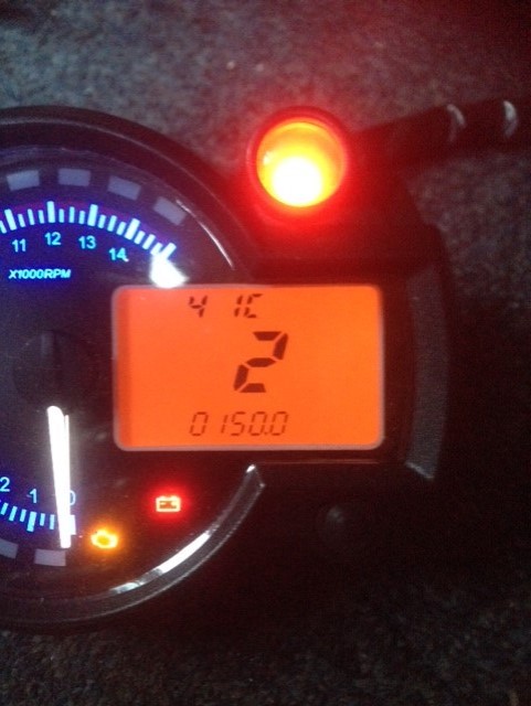

orange
big number in the middle was on 3 now on 2 and wont change bottom numbers first 4 I think are wheel dia 5th number goes to 9 but not sure what its for
top left goes 1 to 8
top right 1 or 5 only
letters top right c or e so I would think c for carb e for efi maybe

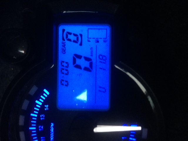

blue
have know idea what the u 11.8 is
other things I cant sort tacho not working ever thou its connected to the tacho wire temp light flashing fuel light staying on but this could be due to not having enough fuel in the tank

@mad73 - my memory is not good on what each number group signifies. I'd suggest reading the second page of the instructions that were posted on the customfighters forum, as it walks through the various settings. I do recall that on my ss182 the wheel setting was circumference, not diameter, in mm. Rollout of your front tire is the best way to measure it. There are probably settings for no. of cylinders, number of magnets on the wheel for the speedo sensor and possibly a setting for the resistance of the fuel gauge sender. Some of the stuff you are describing like the C and E does not ring a bell.
