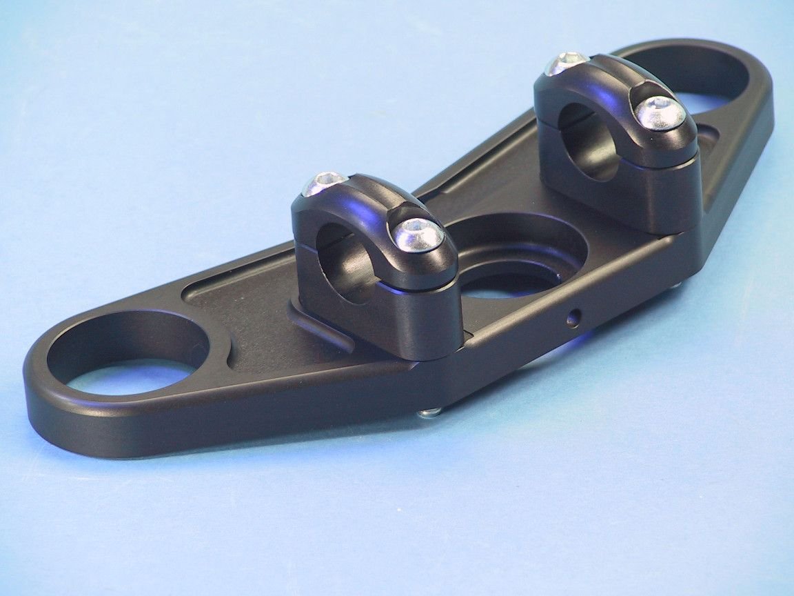

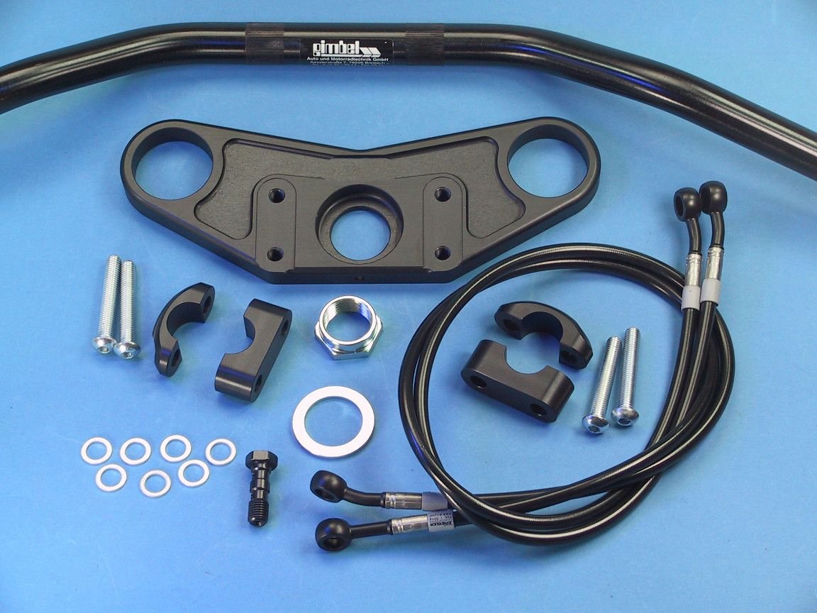

USA Ebay usually sells one bar at a time,usually the left only.I guess people crash on the left more often.Ive looked at the bike and 3 inch lift looks awfully close to the fairing.Heres an expensive option on ebay.
ABM Superbike Lenker-Kit
HONDA CBR 1000 F
1987 – 1992 (Typ:SC21/SC24)

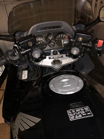

I fitted a pair of Yamaha FJ1200 bars to my CBR1000f, the stock hoses & cables fit with a few light mods. Has made a big difference to the riding position and the FJ bars are readily available - 41mm fork tube size.
