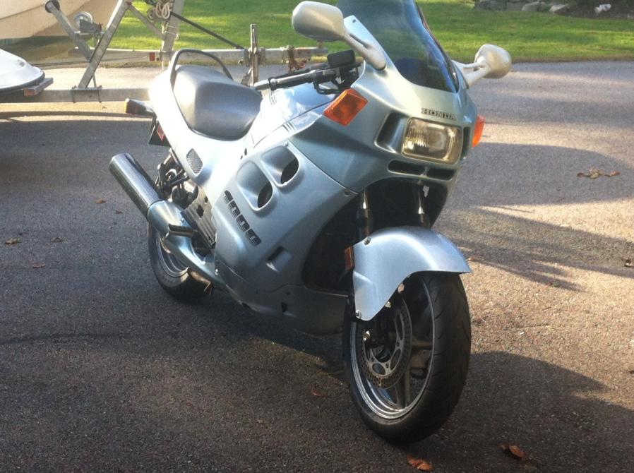

Excited!
Finally fixed the upper cowl on the 87 and buffed up the new MRA screen for it.
Also used Laquer Thinner to take the yellow oxidization off the oem mirror covers
and rubber boots - and then polished them to seal, also this is with the oem seat
I recovered myself. The MRA screen for the 87 was worth the wait (10 weeks)
from Germany
Both sides of that upper cowling ( the upper ears past the mirrors) are now
reinforced with steel strips epoxied on rear of them and concealed by the inner
covers - should last better without re-cracking imo.
Here's a pic...it's a great bike - rides quite different than the other two - becoming
my favourite in some ways - especially around town - get the wow - that's a
"Hurricane" comments from people at Cumby's in town.

Nice Sprock - Naga and I have one just like it!
It did strike me as a bit odd when I put the mirrors back on yesterday that they are a different colour to the fairing, but seeing your it is obviously standard. Seems strange to me.
I do like the screen.
Cheers, SB

Yeah they don't quite match - same with my silver 1990 when I had stockers on there too
Actually I need to respray the entire bike at some point as the upper cowl and
pipe covers have new paint on them and do not have 25 years of sun bleaching
to make them match 100% - they are darker toned - same color - just darker tone
So !'ll have to shoot the whole bike over at some point - but for now - I just want
to ride it all day long
oh and thanks Seb - yeah that screen is worth the 114 I paid for it
