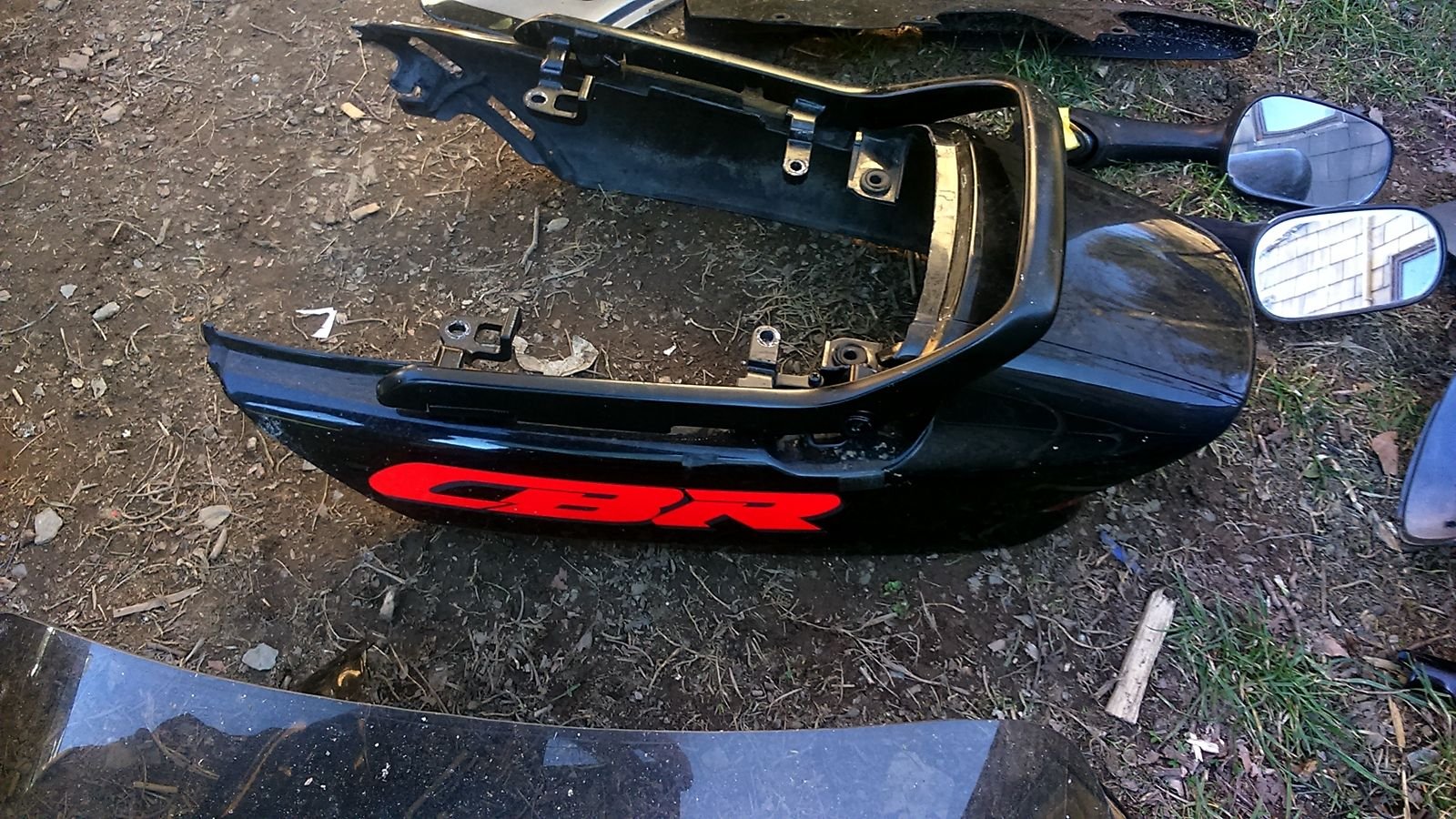

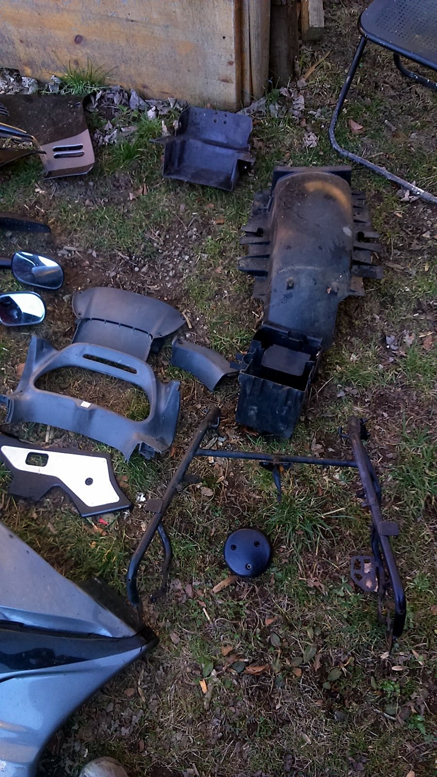

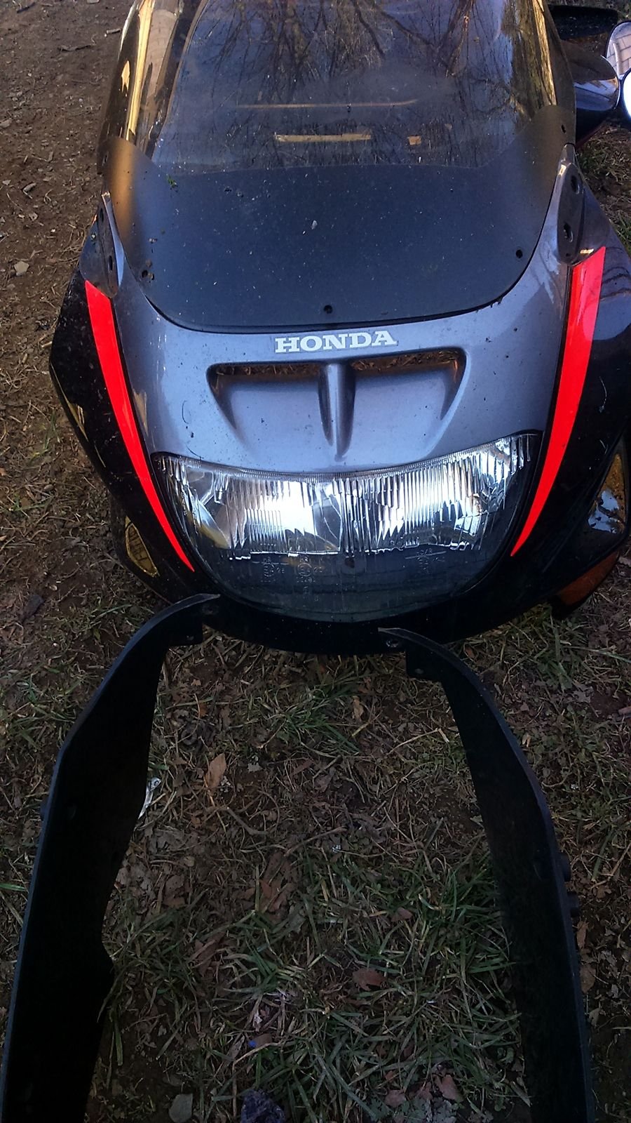

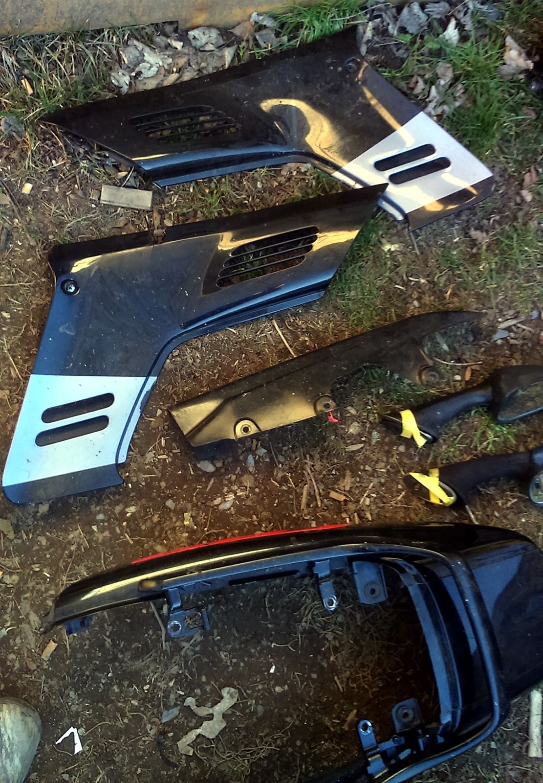

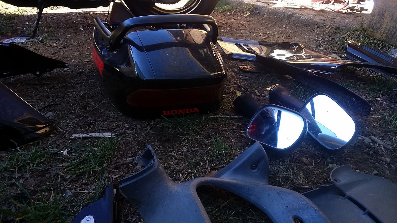

the fairings are for sale.
Everything you see on this photo
340 amerikan dollar and 159 armerikan dollar for postal service.
258 english pond and 121 english pond for postal service
300 euro and 140 euro postal service
Or you can always come and get it

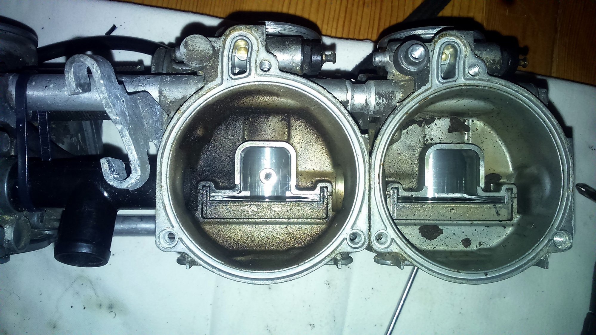

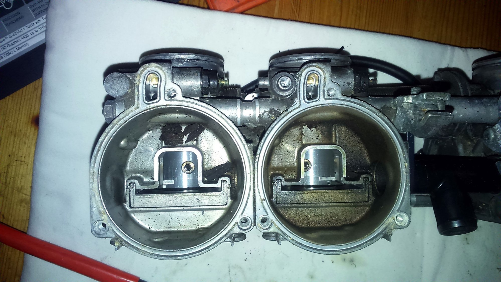

Yesterday I already took the carburetor off in anticipation of the jetkit.
I already opened it and what I found there was incredible, pieces of foam - dirty - and 2 of the four jets were covered with dirt.
Some photos of the carb
