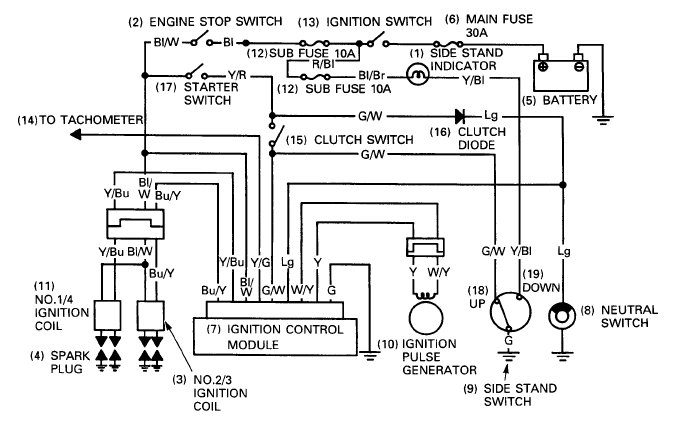

does anyone have the color codes for a 94 cbr 1000 ecu , i cant get power to the coils and i think i have the wiring wrong.thanx in advance
Old Apr 8, 2009 | 11:58 PM
Shadow's Avatar
Posts: 11,608
From: Mud hut, Zululand
Manual should have it - Thanks to Naga_Thai for the link
http://myweb.tiscali.co.uk/midlife/i...ice_Manual.pdf
if not, let me know ......
