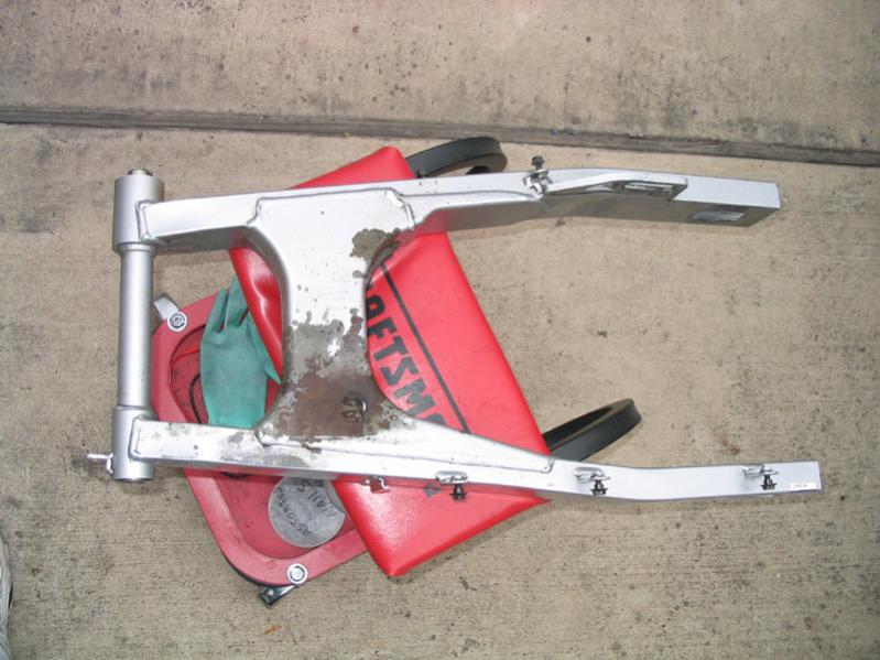

Here's a reason to consider AGM and other Style of sealed batteries
pic credit - gonzo
