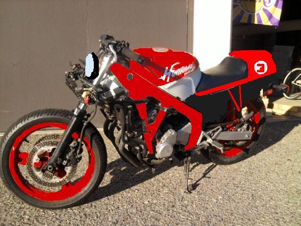

Welcome to the forum Deus! That design looks pretty sweet. Let me know when you start a build thread so I can follow it. If you have any questions along the way I'll do my best to help out.

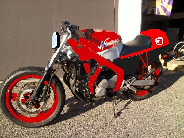

My concerns are where to get lowered handlebars, will the handlebars then hit the tank, and making a custom seat with the traditional cafe racer hump in the back. The tank seems fairly level so i dont think Ill need to raise the rear of it. I think I will need to raise the seat a bit to be more level with the tank, again, in the tradition of the cafe style. It seems most people who make naked bikes out of CBRs, make them into streetfighters rather than cafe racers. I really want the cafe racer style as depicted in the MS Painted rendition above. Those are my thoughts thus far.
