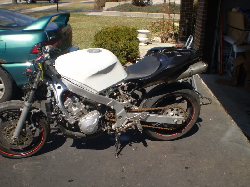

Right now it runs and I could technically start riding it, but it needs a headlight build, taillights wired, side fairings done, speedometer wired, and paint. booya.

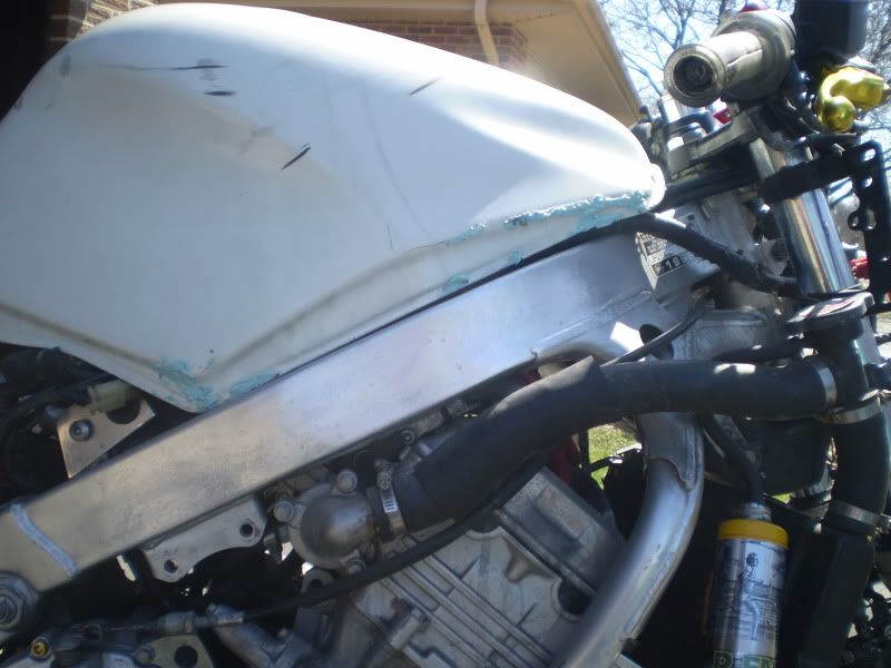

Progress progress progress. I tried to tuck my wires on the side how colorado steve did, but I ended up cutting all of them then moving them and soldering/heatshrinking them. No biggie. I love soldering.

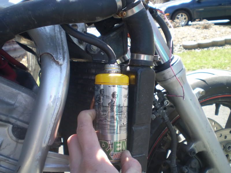

My lovely coolant overflow
I'm a runner, so it works!!

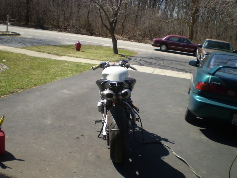

Gotta say her *** is the best part so far. I'm building her face right now so we'll see!!

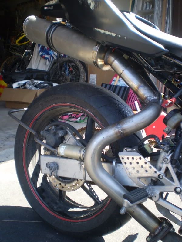

Thanks man! Although I think I'm going to go back and get him to put it closer to the swingarm because if I put my toes on the pegs I'm pretty much on top of the pipe. And the pipe is so pretty I wouldn't dare cover it up with wrap.

I 'tuned' it today. Or in other words, I took resonators out of the exhaust one by one until it ran right. I guess I put too big of jets in, because the exhaust is completely GUTTED!
Other than the cats that is. Sounds like an animal. But still an I4 so it whines a little.
