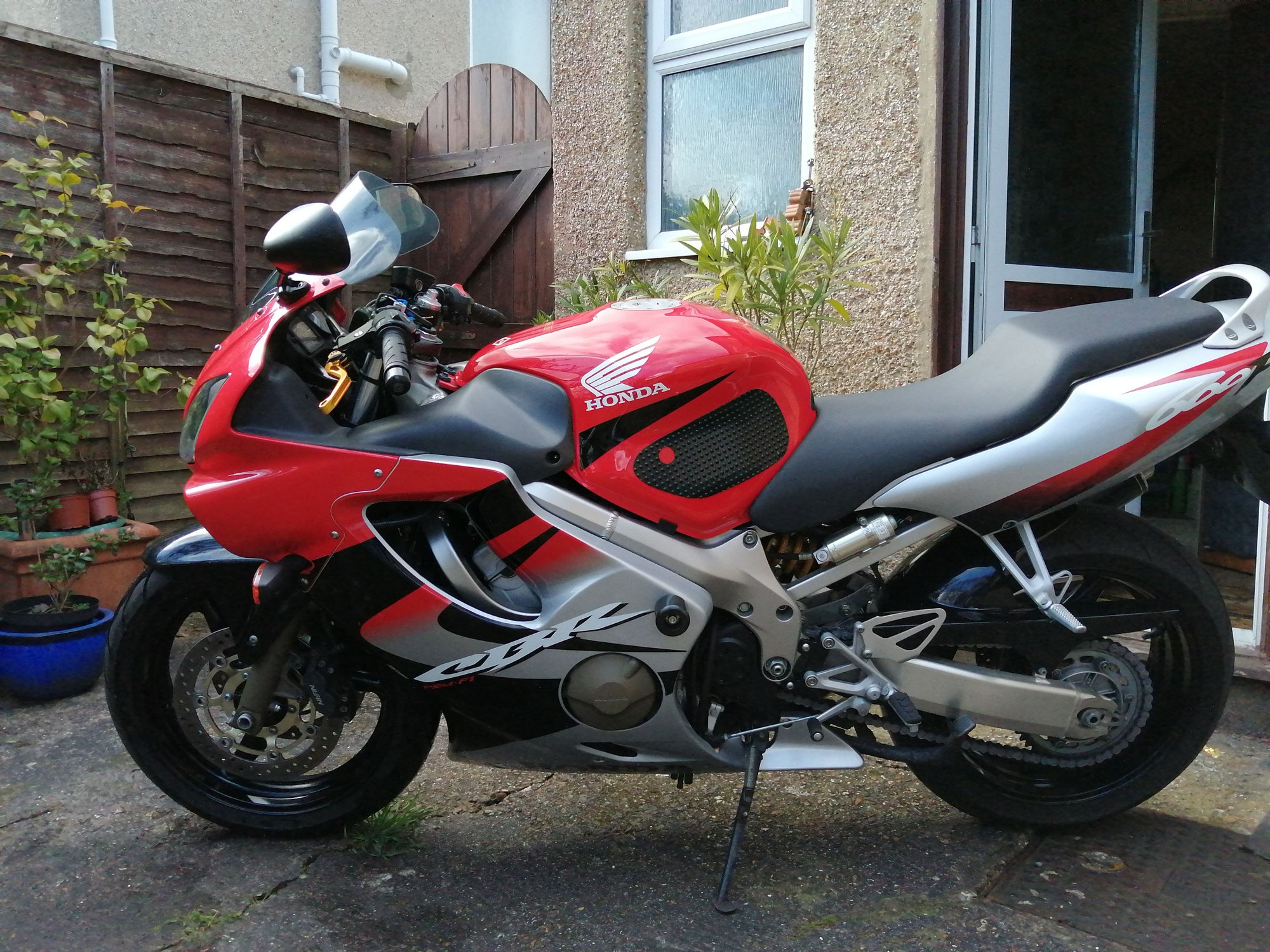

Last June I bought a one previous owner 2004 CBR600f4i with a low 5000 miles. (PIcture Above)
In that year i've tinkered and covered 8000 miles, 2 track days and the California superbike school. This is my opinion.

I have raised the rearsets ( see photo). This was fine but recently I raised the ride height by 10mm by placing a 3.4 mm washer (3:1 ratio) under the rear shock top bracket. Was 74 cm now 75cm. I also fitted a lowered seat (not in photo) and now my knees are low on the tank so I will make another bracket and raise them a bit more.

That's about it. Basically I have taken a brilliant bike I purchased for commuting and made it less comfortable. It now turns more to my liking but not as well as a similar year R6 or 600RR but i've had fun playing.
