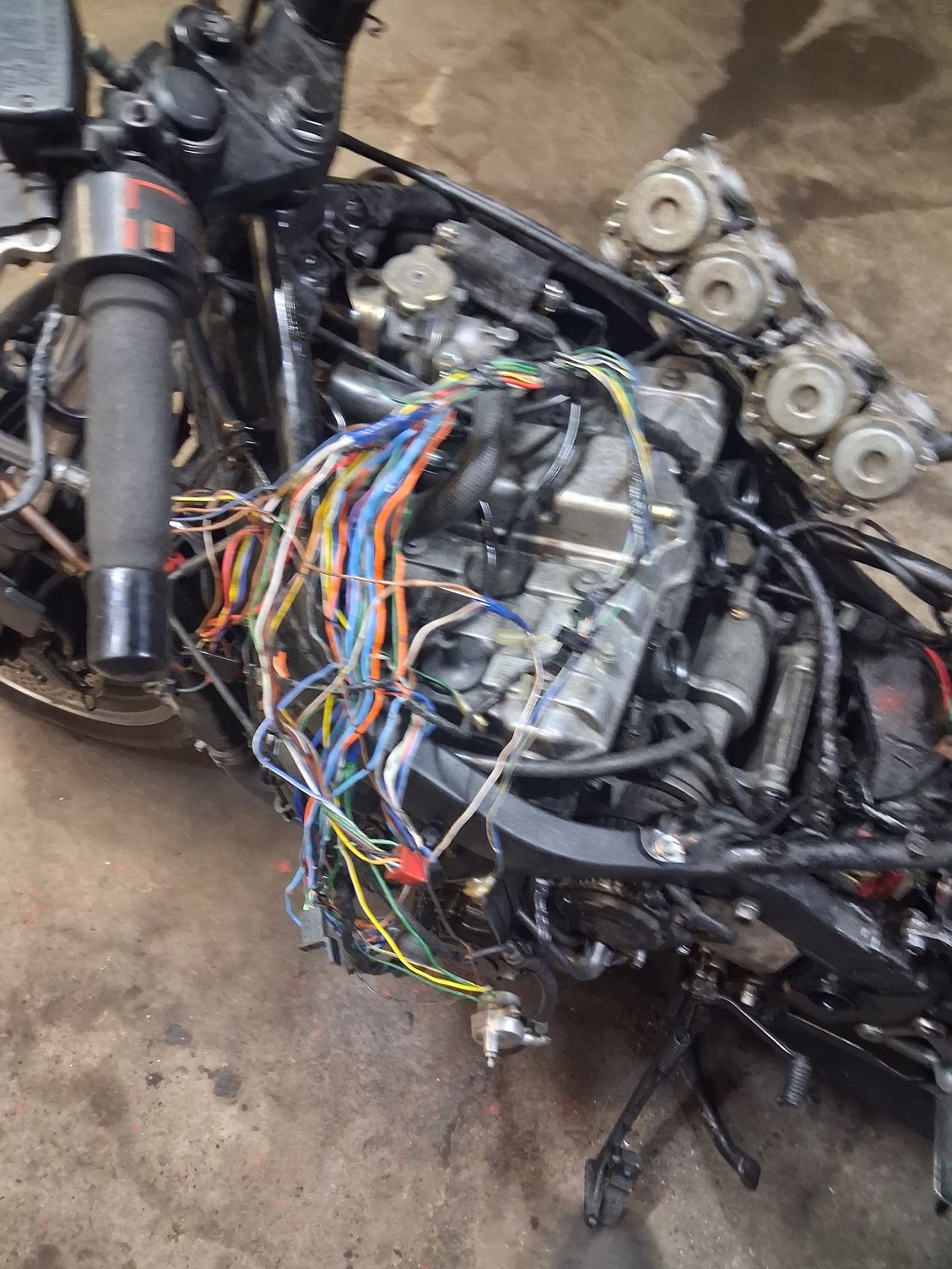

Like i said. Ive traced and looked over every single wire on this thing.

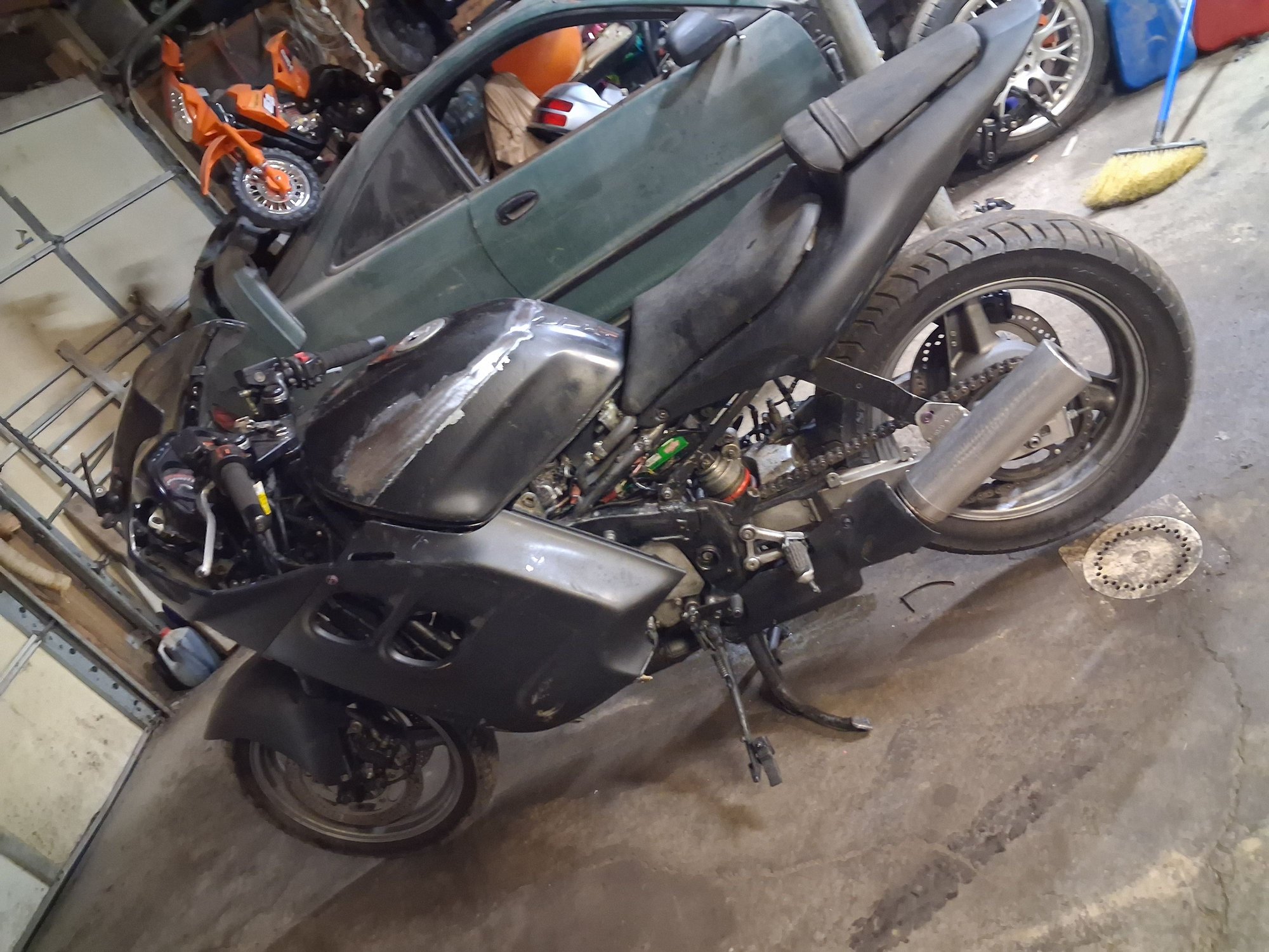

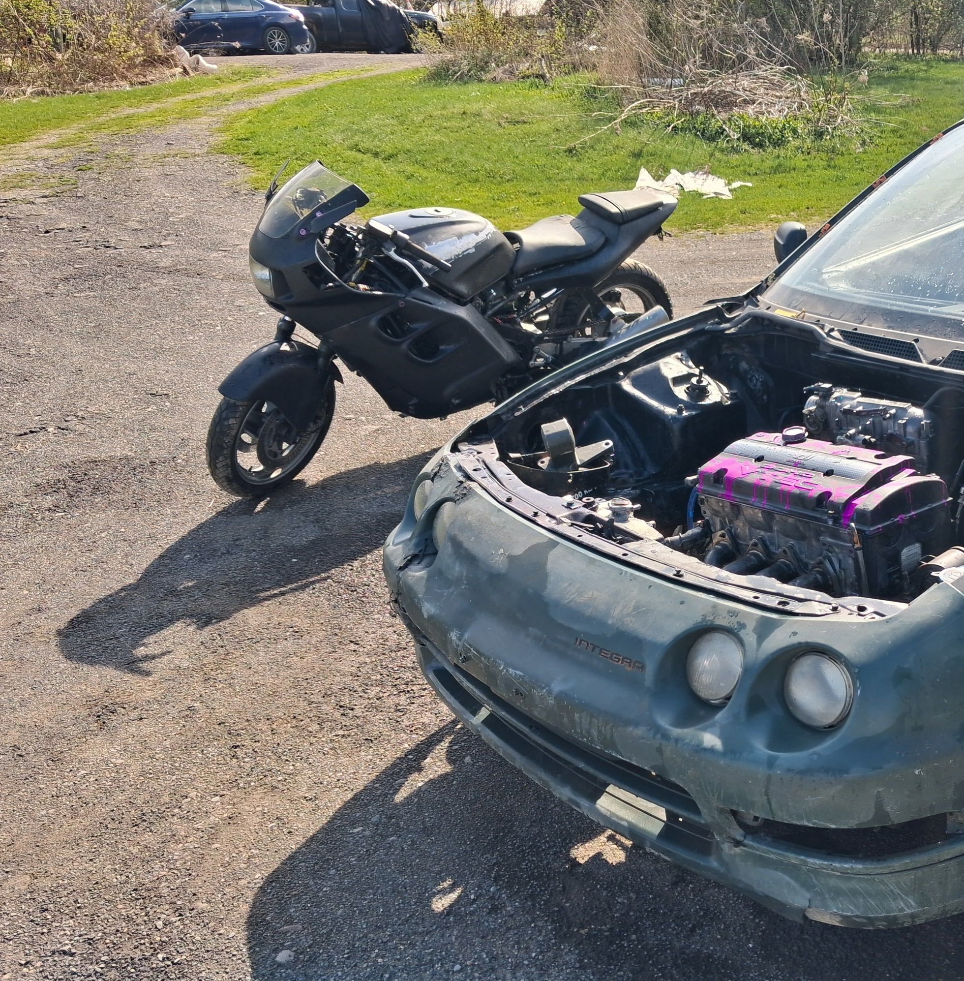

The teg and the hurricane with the r6 tail swap(yes i know the motor is crooked in the car... theres no transmissiok in it and that happens to bold to a motor mount on that side.)
The teg and the hurricane with the r6 tail swap(yes i know the motor is crooked in the car... theres no transmission in it and that happens to have 1 of 3 motor mounts on that side.)

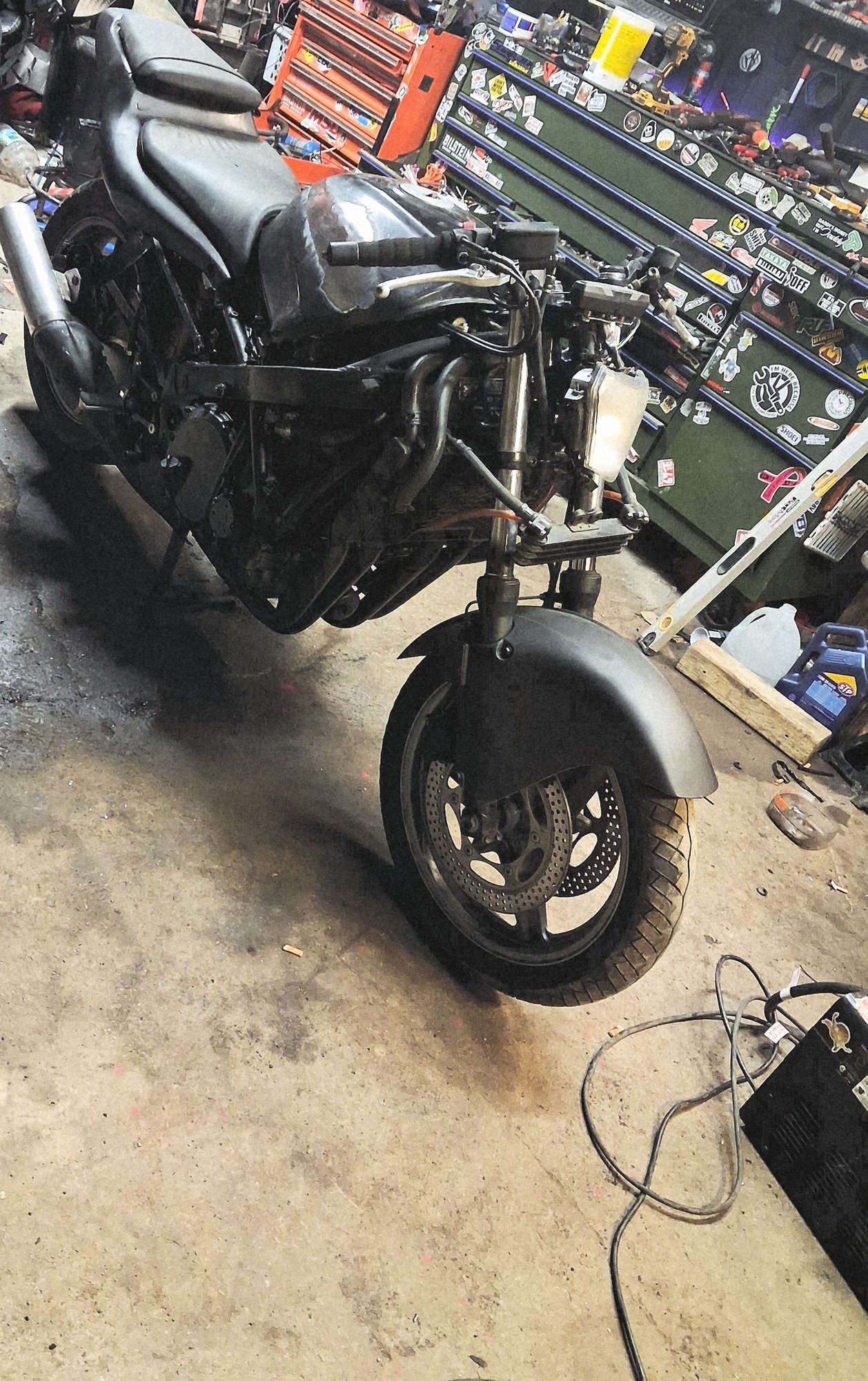

Sort of the streetfighter look i was testing thoughts on . Smaller digitical cluster and headlihhts i have signals mounted and tucked to the sides of the headlight housing
Sort of the streetfighter look i was testing thoughts on . Smaller digital cluster and headlight i have signals mounted and tucked to the sides of the headlight housing.. but would need to make a mount for the cooler also

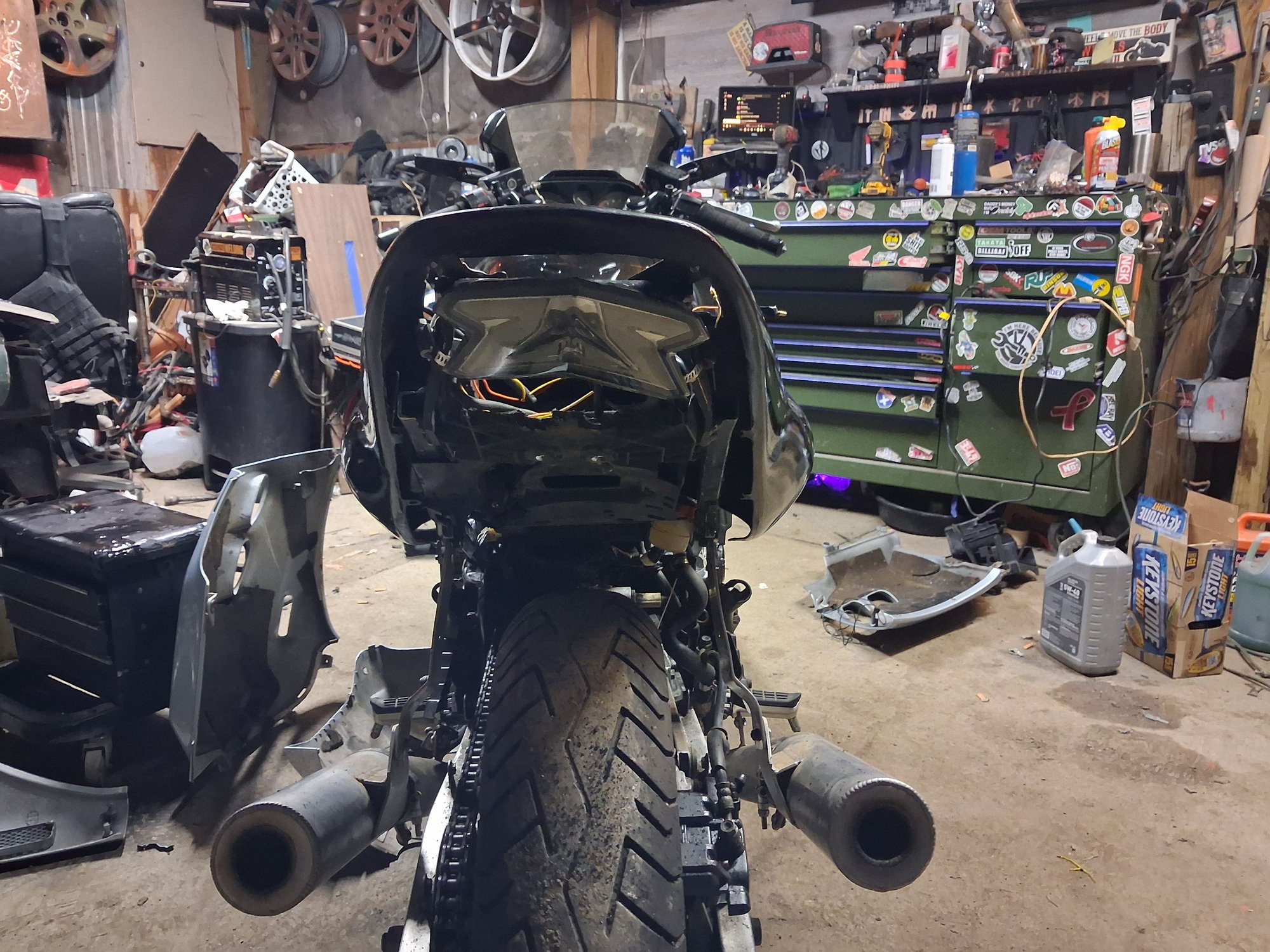

Ninja tail assembly in the r6 tail .havent made a lower fairing cover cuz im thinking of going with the 03-06 r6 tail lig
Ninja tail assembly in the r6 tail .havent made a lower fairing cover cuz im thinking of going with the 03-06 r6 tail light assy.
R6 tail with the front lower fairings on... the belley pan doesnt want to mount properly and the lower fairings poke out quite a bit due to the coolant inlet points on the 91 motor which ik are diff than the origial 87 ones they are meant to cover.

I would say that since you got the bike to fire on starter fluid, it would seem you're almost there. Since you sprayed fluid and it fired, you have spark and air, the only thing left if fuel. Since you sprayed the fluid and it fired, you bypassed the carbs.
Did you completely disassemble the carbs? Every port and passage has to be spotless. This cannot be done without breaking down every component. You have to soak the bodies in carb cleaner. You have to use really fine brushes and such to scrub out each port. If you have an ultrasonic cleaner, they are helpful.

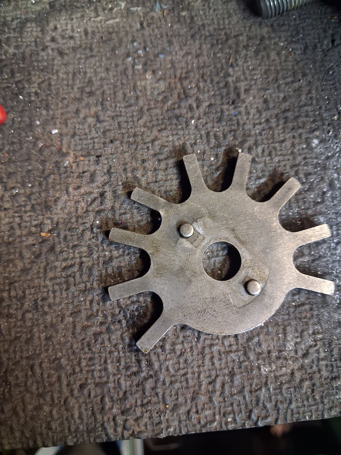

. I didnt completely disassemble them no due to the kit I had gotten not having all the o rings for the fuel ts and whatnot.... however.... today i figured id check the pulse generators jusy for ****s n giggles. And i had remembered seeing them for sale and only having 5 fingers on the rotors and mine had a few more and upon inspection of that. Found a split in the yellow and white wire and also that whoever installed them the first time had them backwards(not sure if that matters but I would think if its sending g a pulse to 2/3 first before 1/4 it could cause it to to fire all sorts of weird. And also. One of the fingers had a pretty nasty bend in it. So instead of trying to bend it back and testing my luck with a rotor thats now structurally unsound, and it being a rotor from what I think is the 91 model... im just gonna order a new rotor cuz I was able to resolder and get a solid connection and resistance reading out if the wire . And also Noticed that there wasnt the proper clearance between rotor and pulse pickup that the manual calls for also.... ik I should be buying a whole new pickup and rotor kit but like I said before, im in the midst of a move and I honestly shouldn't even be spending what I am on the bike right now but that 2 wheel itch is getting ridiculous especially here in upstate NY, our riding season is much shorter than alot of places. Cuz literally just last week we had snow 😑 And im currently waiting on a full carb rebuild kit now cuz upon taking the float bowls off earlier the kit was trash I had gotten cuz even with the proper screwdriver and the fact that I dont hammer those screws super tight for this reason. 7 of them started to strip out already and I've only removed them twice since buying the kit. So I have new Alan head screws coming for it just because I've had much better experience with those in my years than Phillips anything on both bikes and cars lol.. it just sucks cuz everything i make a little progress and think i have everything ready to fire the bikes like "nope, gotta be quicker than that" like that damn commercial lol
