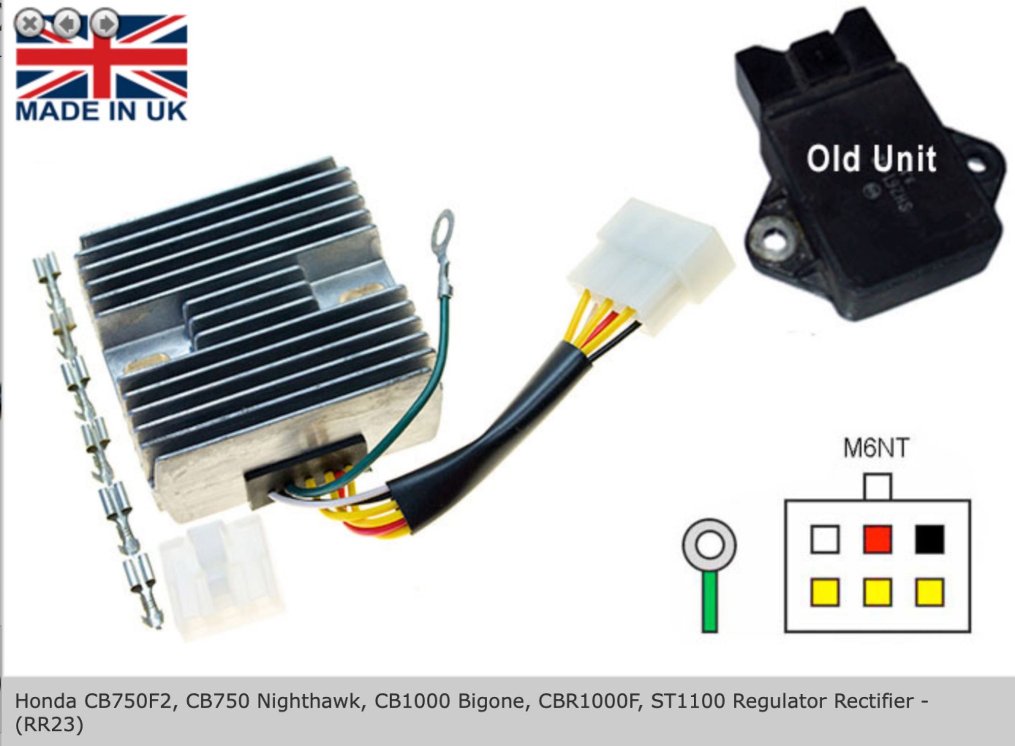

"Poor grounds, corrosion on aging electrical connectors, and batteries at the end of their life all point towards hard-starting issues." May I add the standard Honda Reg/rec unit. I replaced mine with an Electrex World unit, which I believe offers more charge to the battery at low revs, improving battery service life. Cheers
