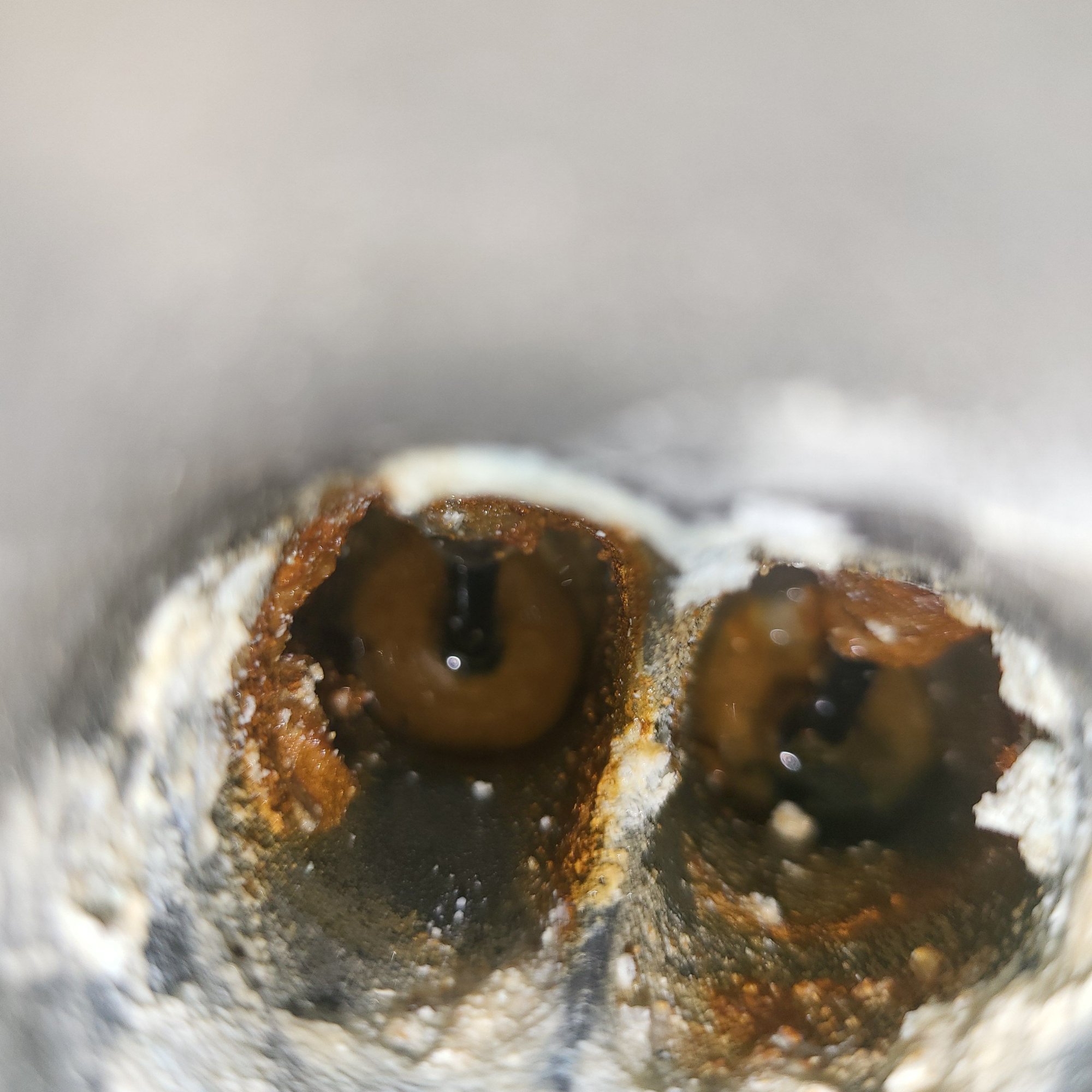

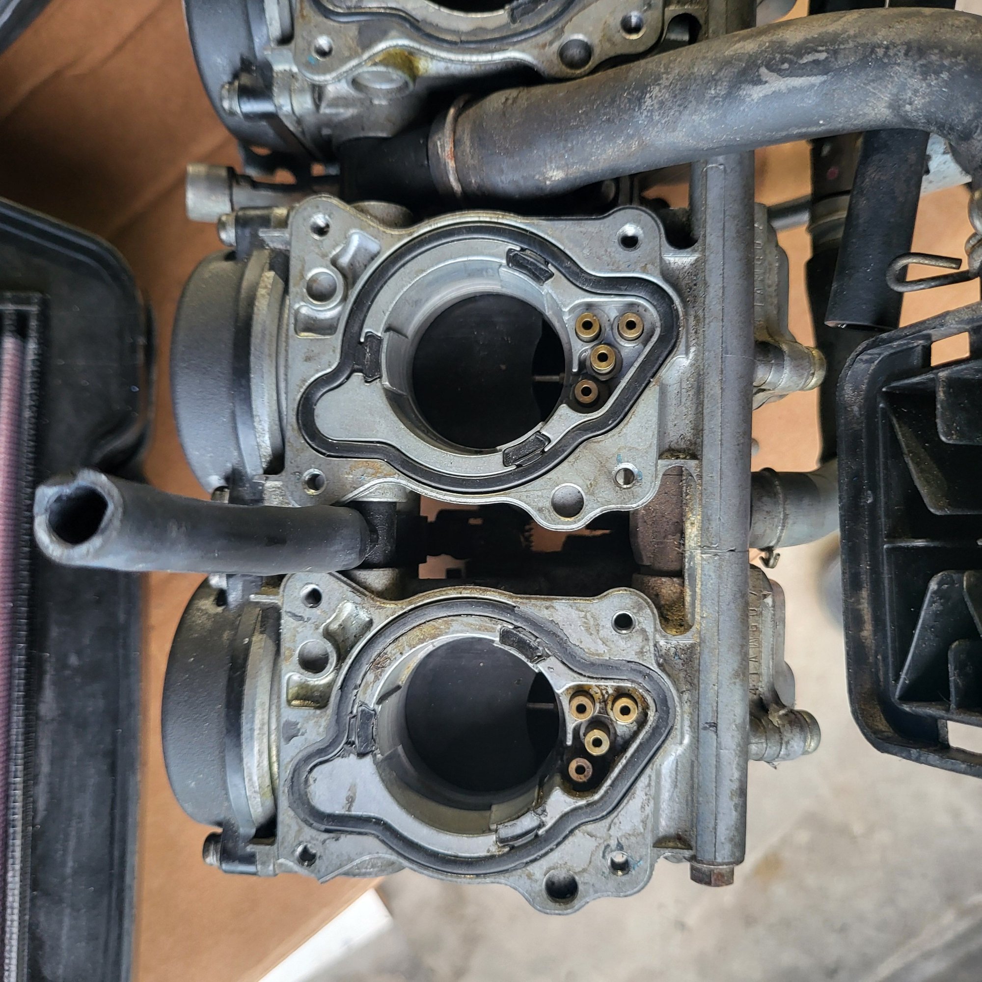

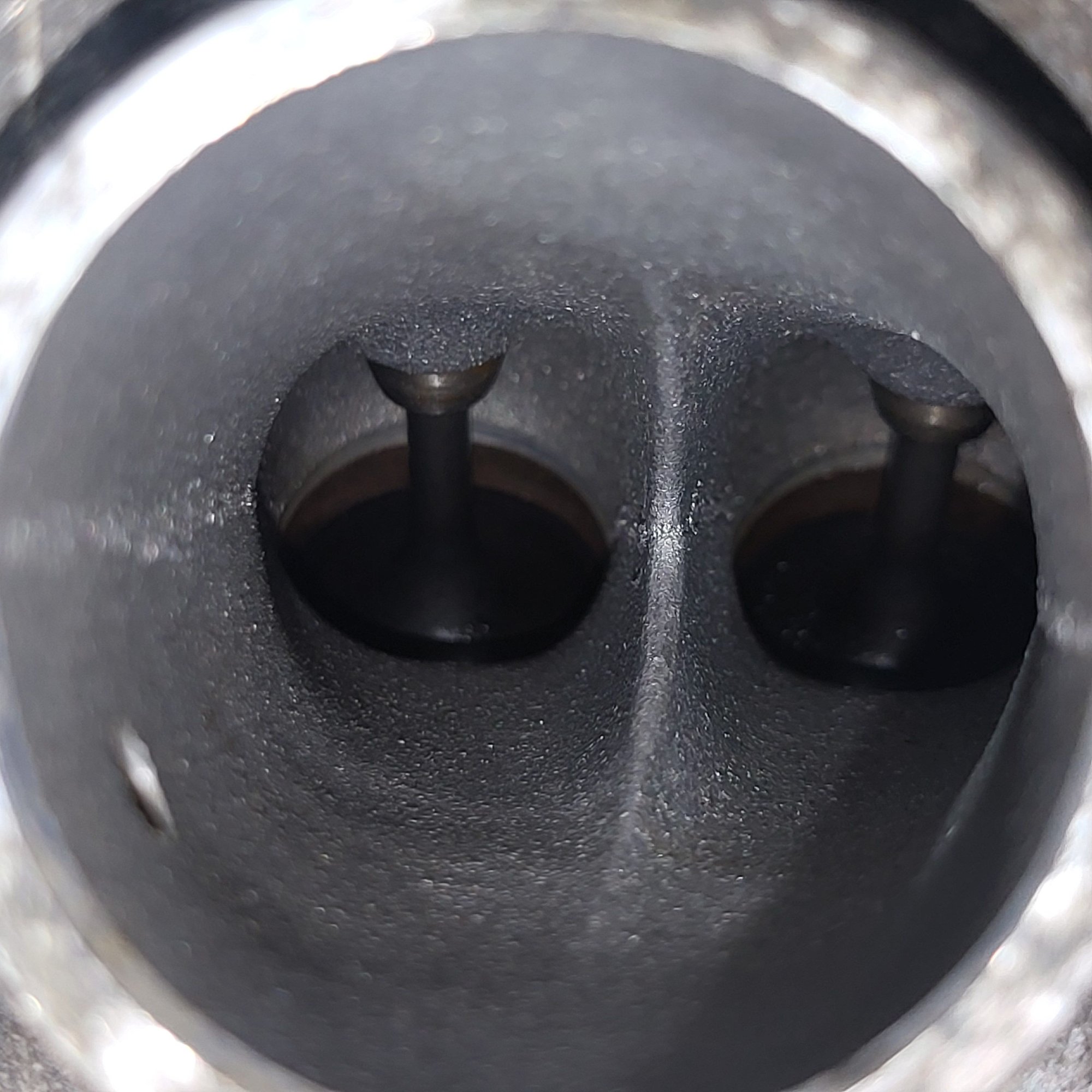

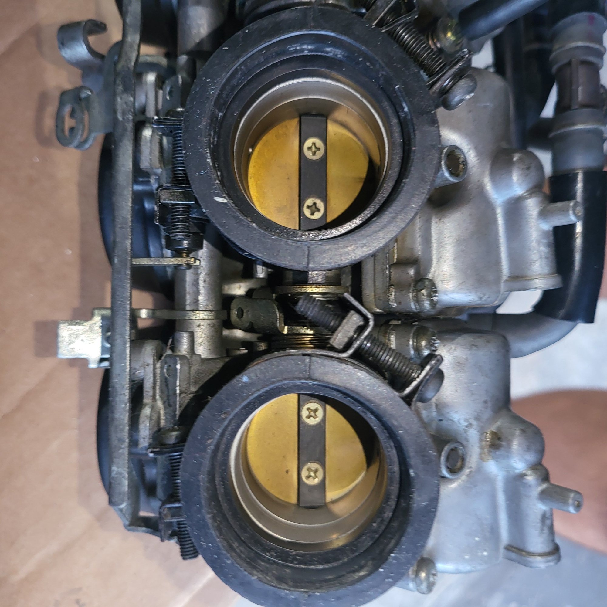

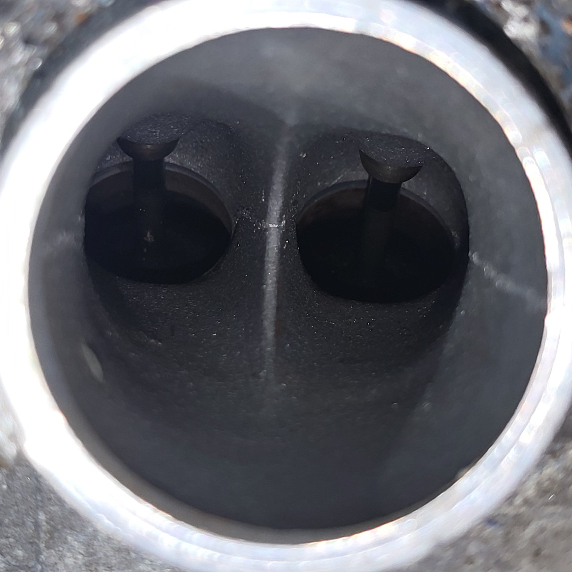

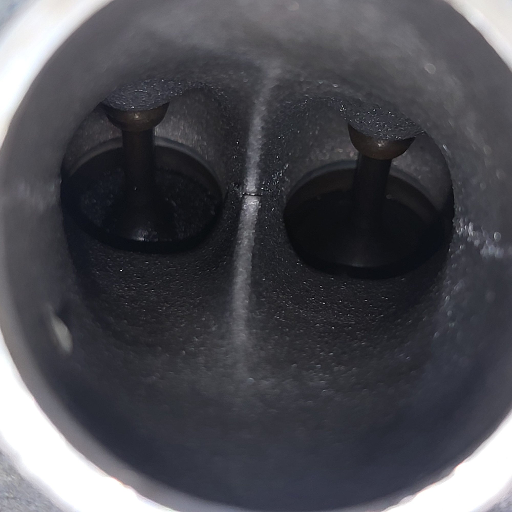

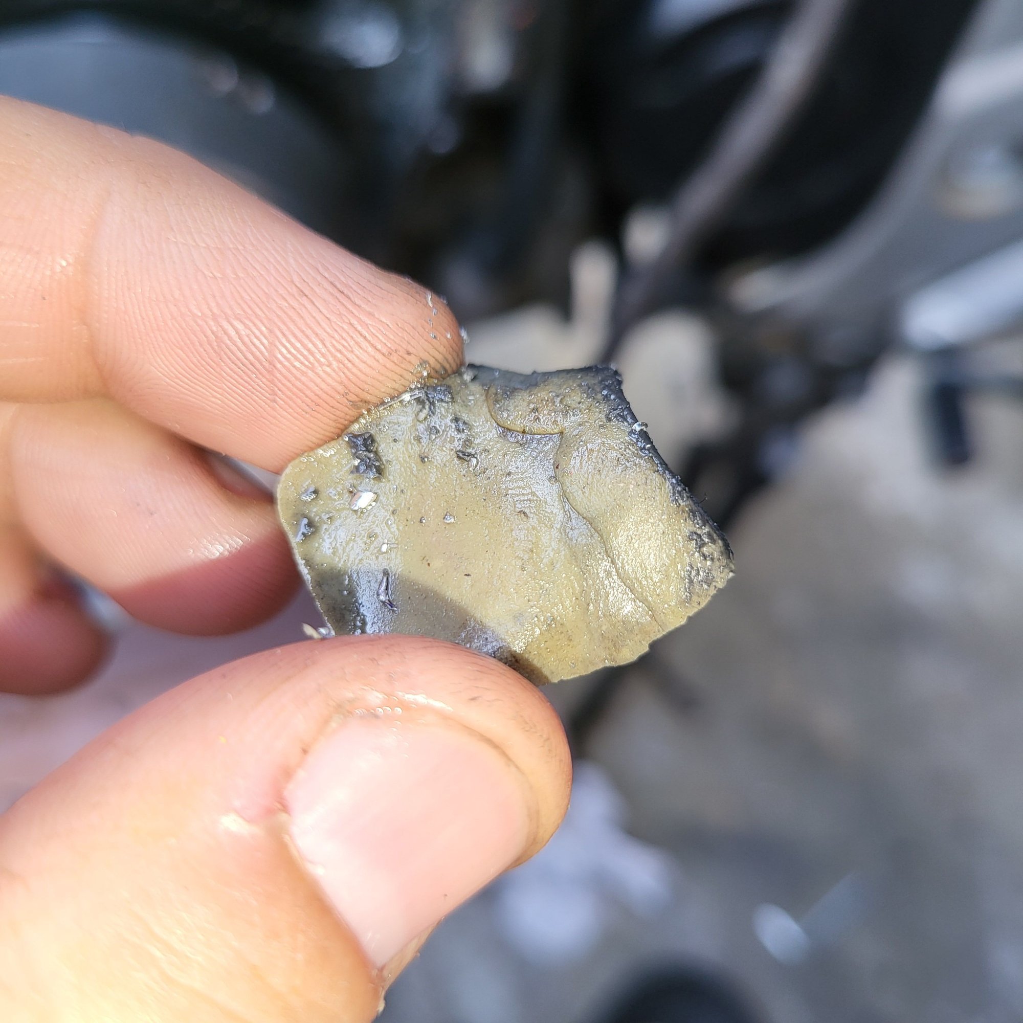

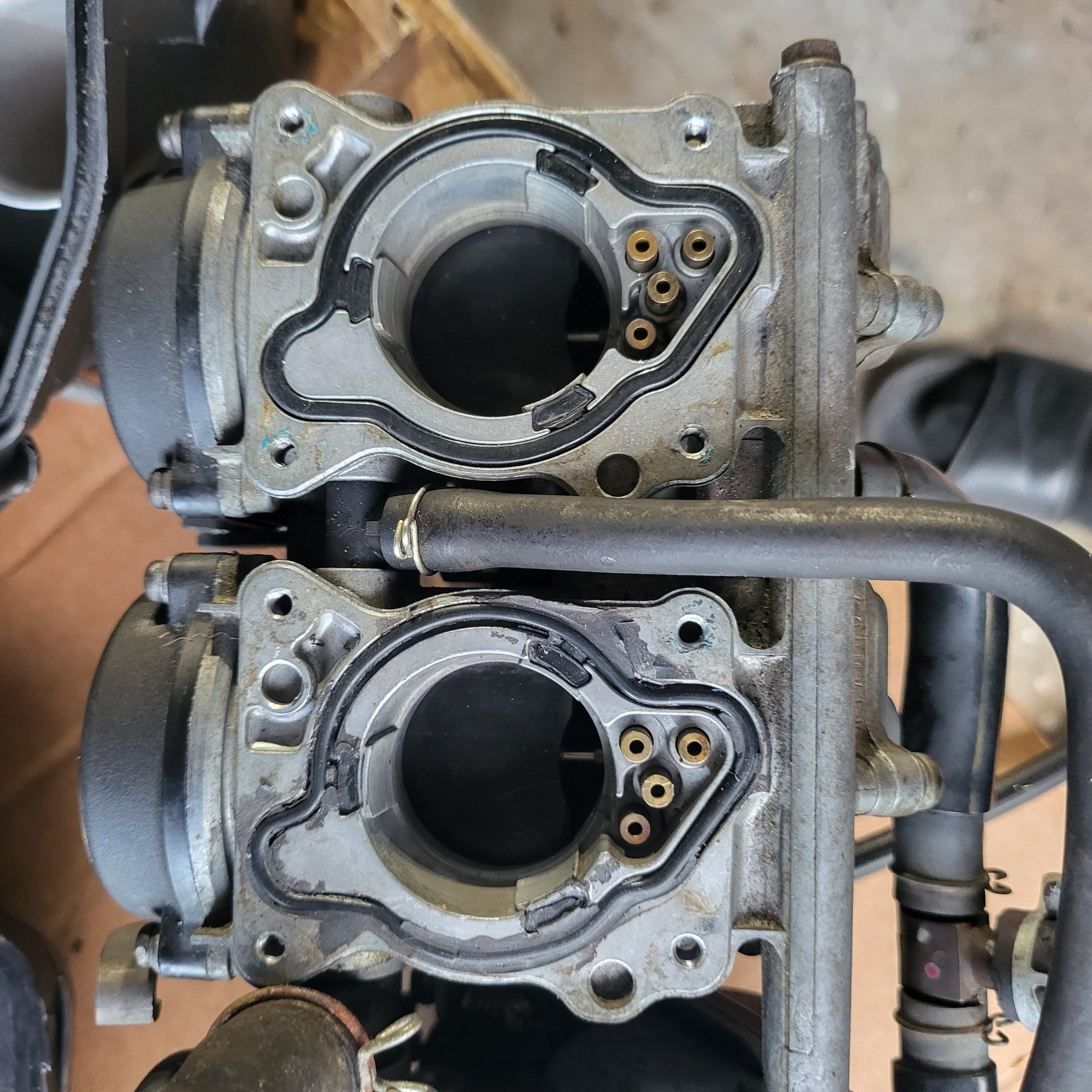

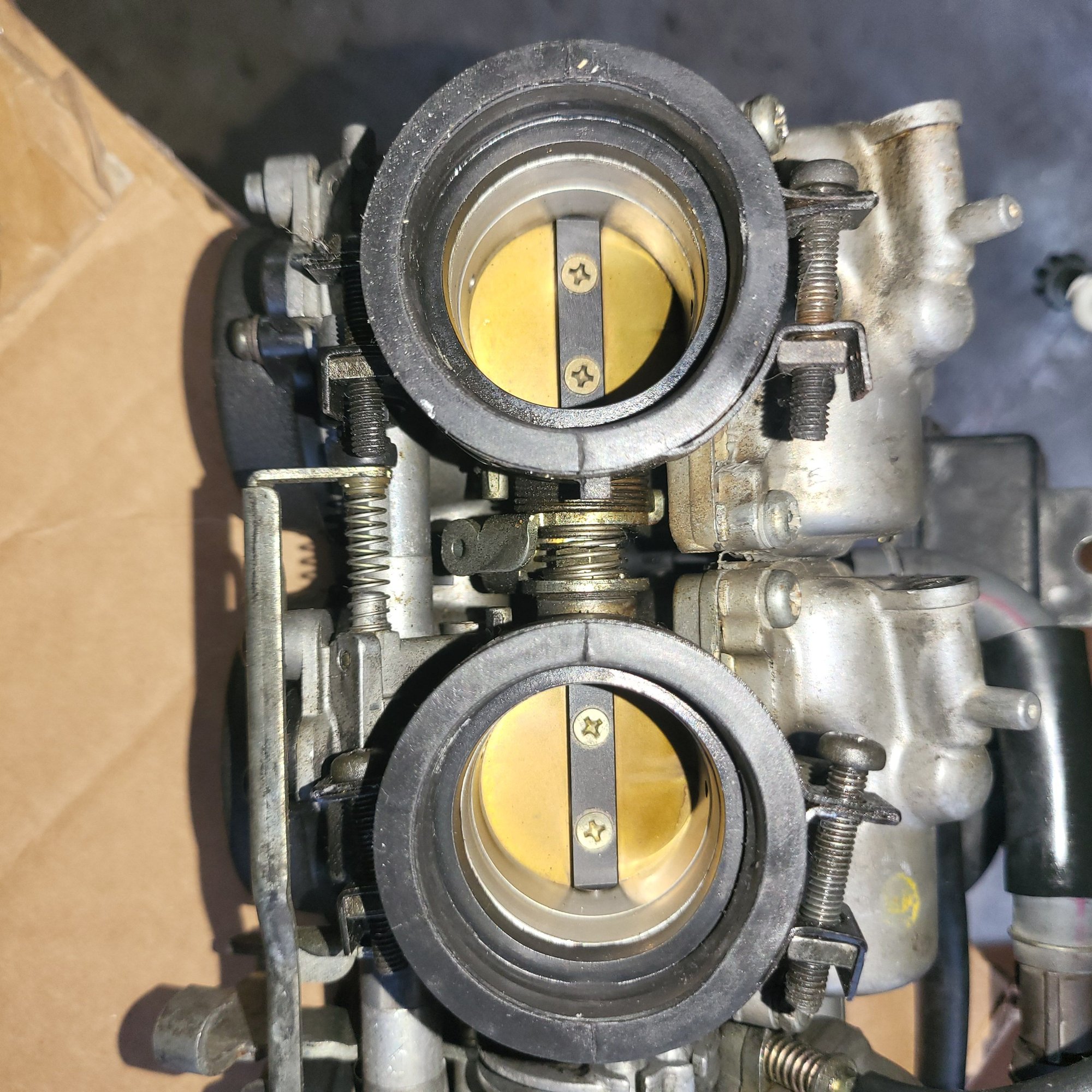

I finally got time to removing the carbs & have found this crystallized white
/yellowish substance in the first cylinder(Bad gas?). Also to note, I decided to check the quality of the engine oil to my disbelief, there was only a trickle of oil sitting at the bottom of the engine. Shows I have a bit too much trust that I didnt check for the most important thing. I have quite a bit of learning to do. Thanks in advance for any guidance.

Caveat emptor and all that.
Carbs on the whole not too bad from your pics. Make sure you follow the guide in here for cleaning.
Looks like you might have had a water leak into the port at some time in the past, the others look great.
Some gentle cleaning / vacuuming will be in order fingers crossed it has not entered the cylinder.

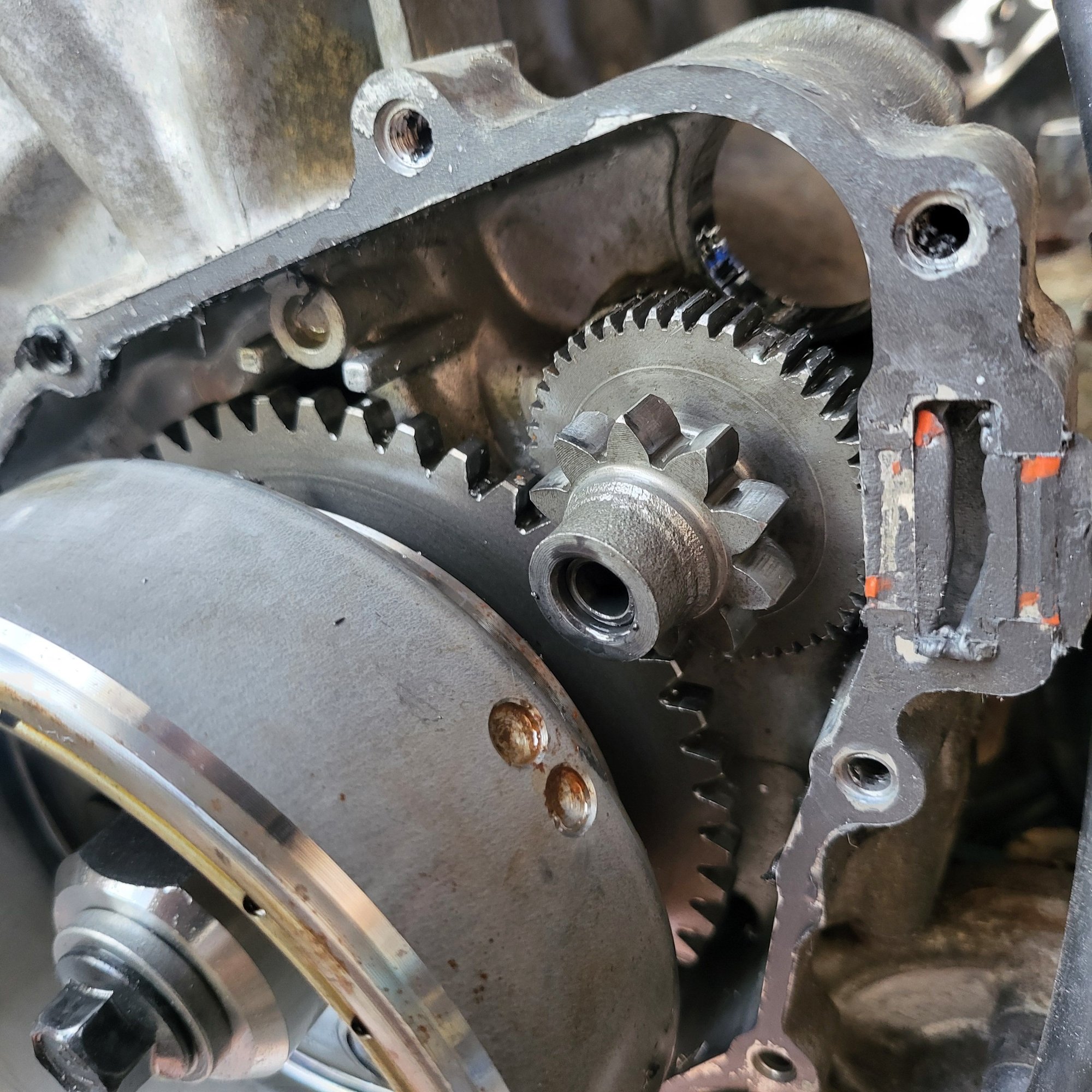

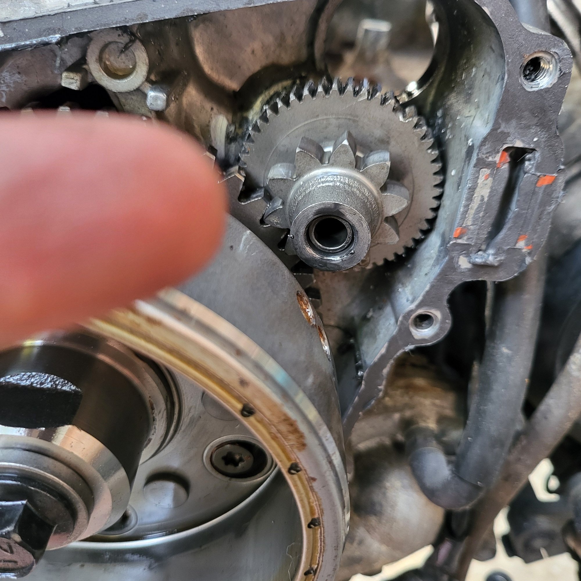

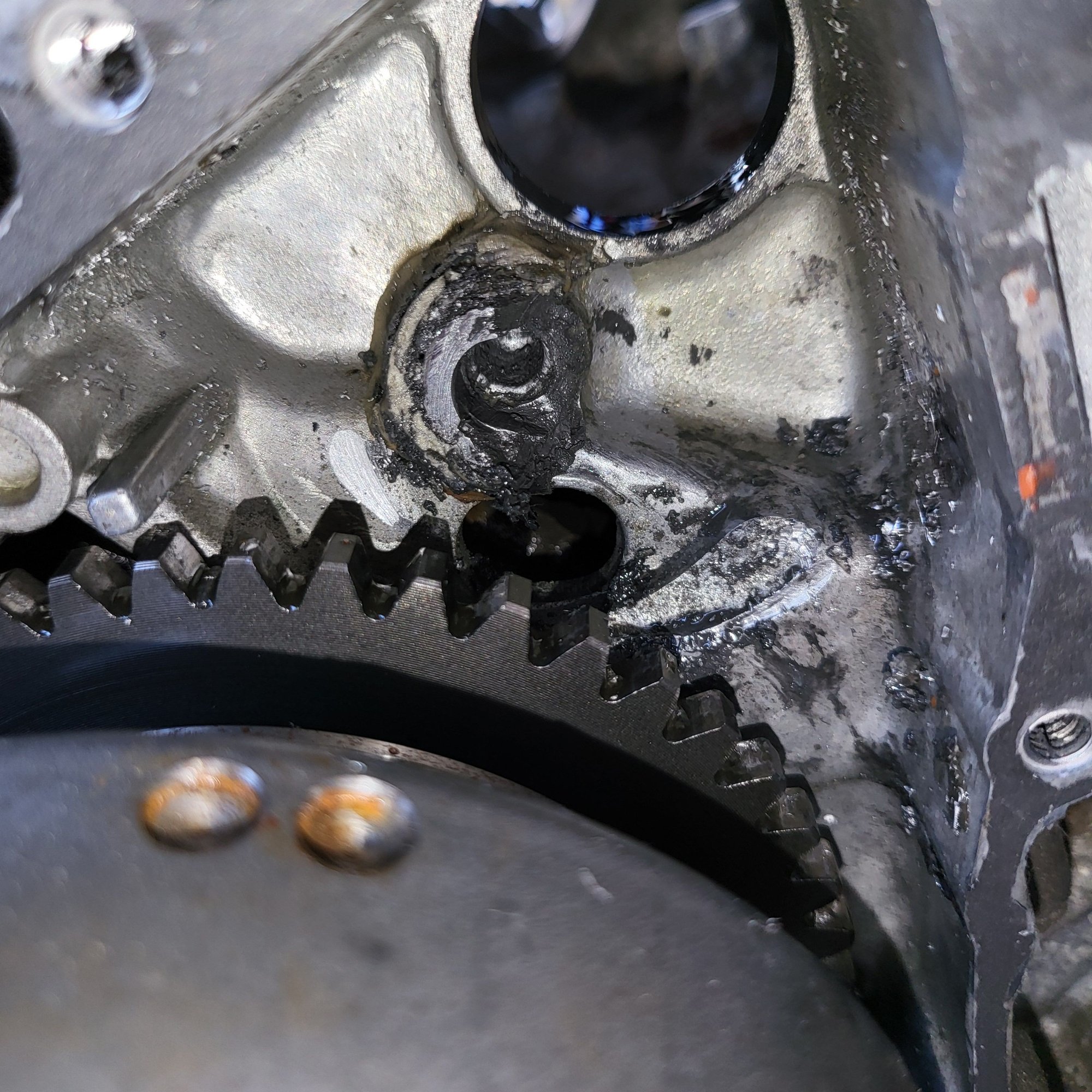

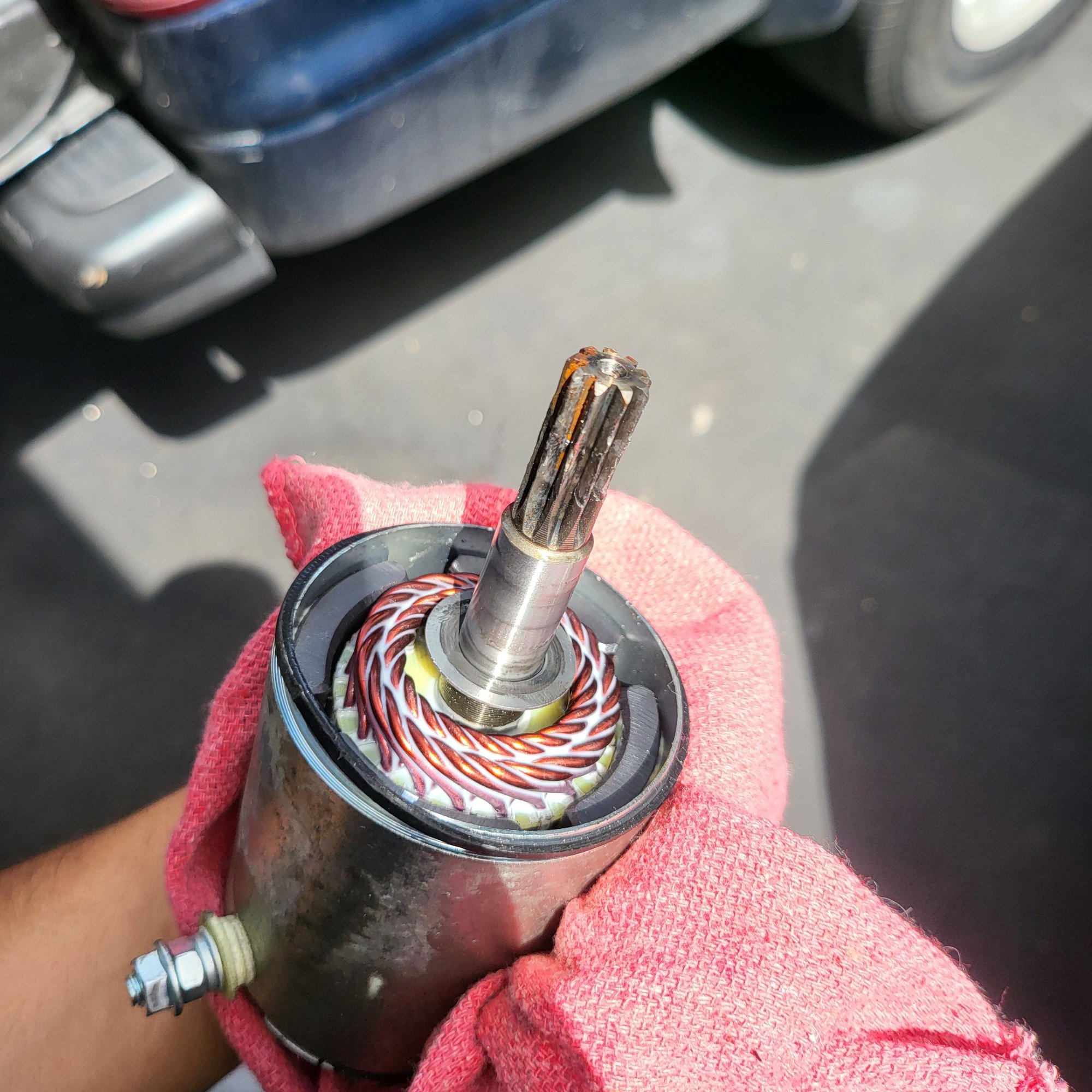

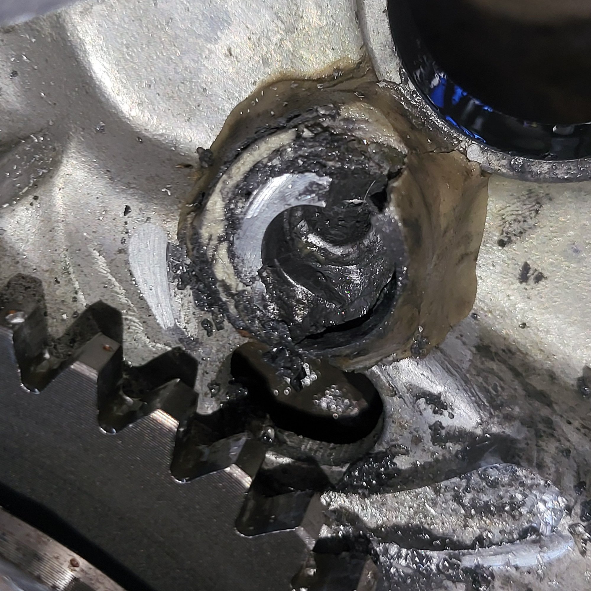

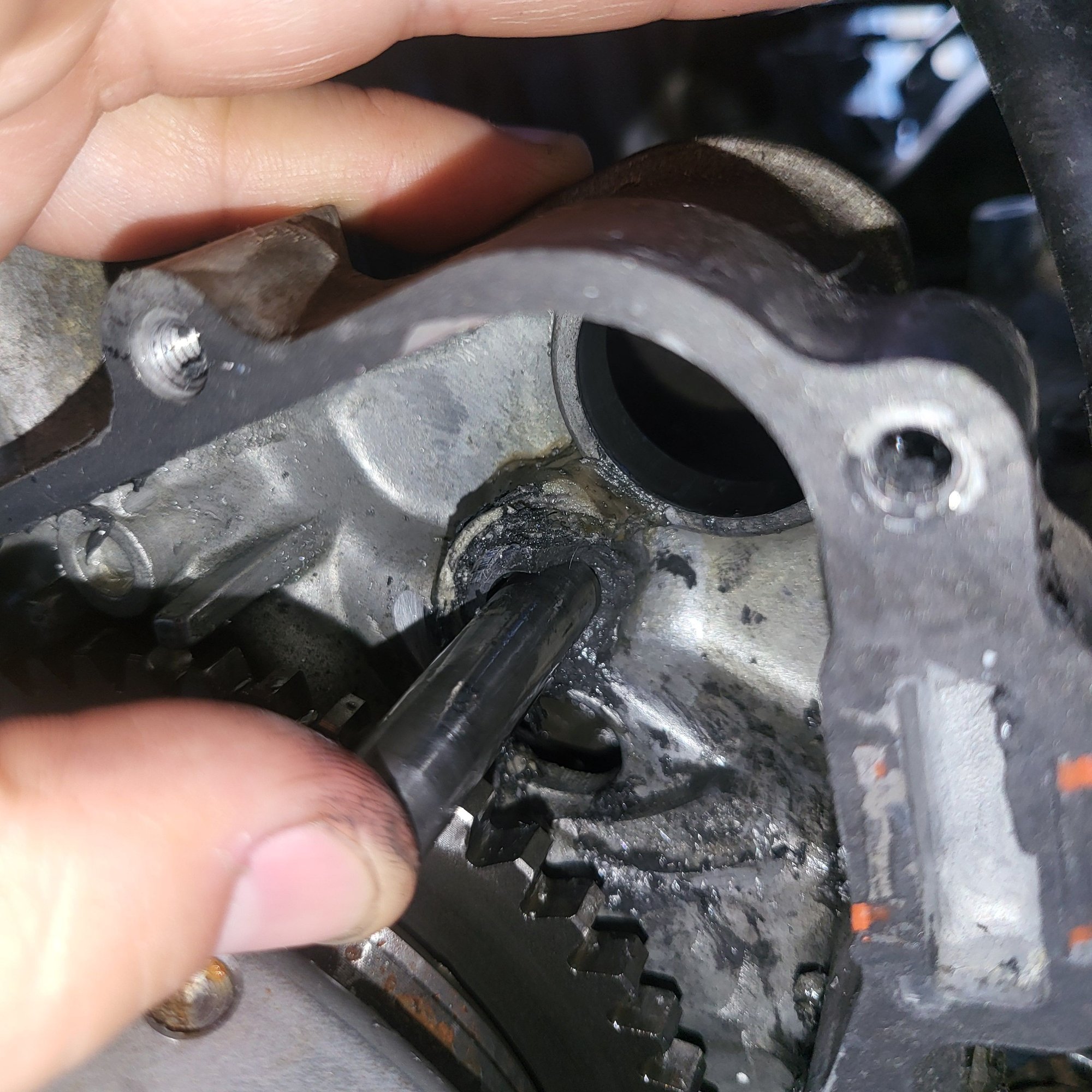

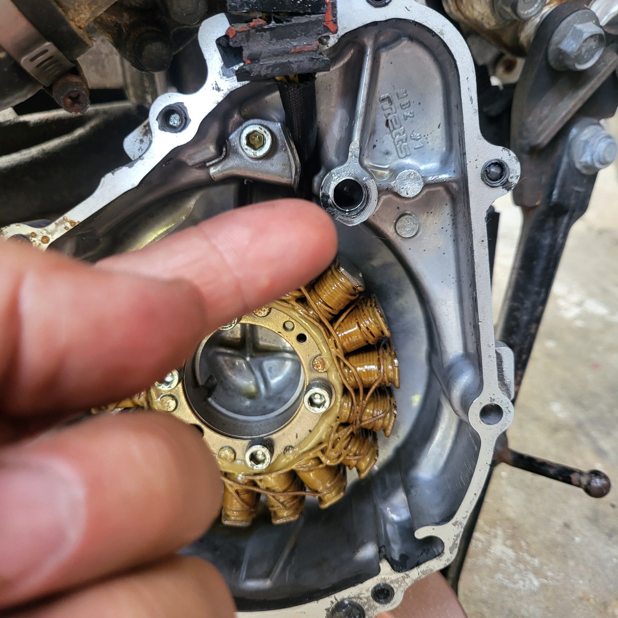

Default Not looking good
So got her running this Friday, ran for 2 minutes then shutoff when I tried pulling the throttle ( airbox missing filter). It drained the battery then I put it to charge. The next time I tried starting it, it made a loud screeching noise. Called a friend of a friend & he said the starter is stuck. Decided to take it apart to find this housing for this gear was broken and patched with an epoxy & looks like it finally snapped. Is this worth repairing or just find another engine. I ain't giving up on this bike. She's gonna get her second chance (4th+ owner I assume I am) at a new life. A life with respect & proper maintenance.
